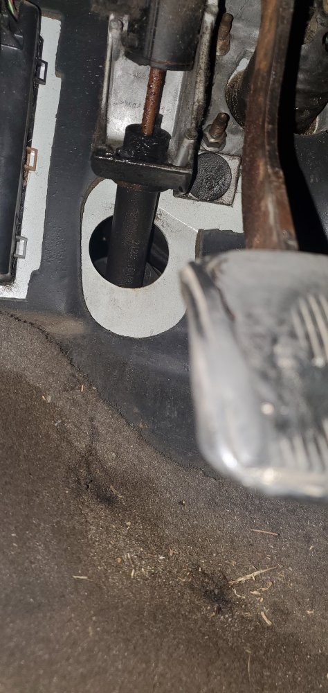

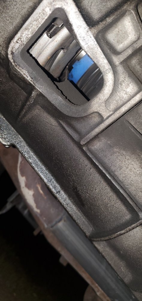

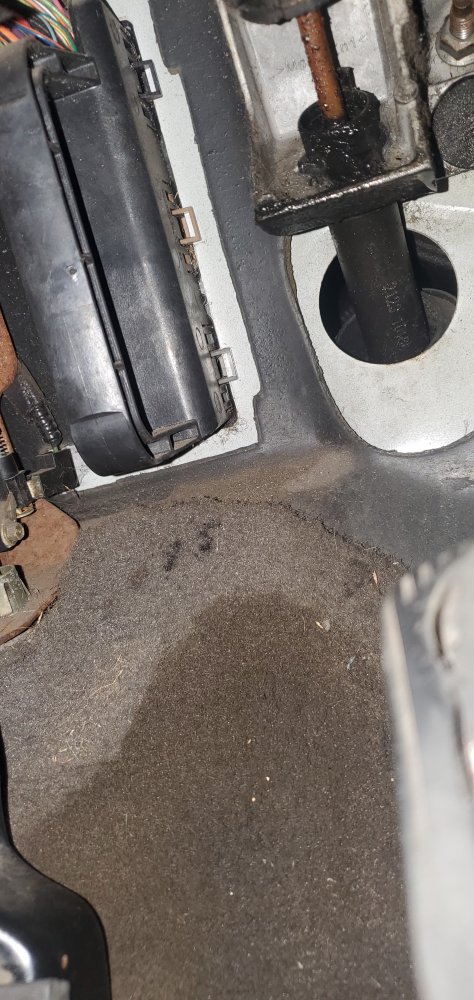

I would assume this means i have some sort of leak in the hydraulic clutch system, and based on the surface area that the seal of the slace cylinder must cover i wouldn't be surprised if it is from that, however i am not sure how to check where the leak is, if it is caused by a failed part, and weather i should just fill it with fluid or if i need to bleed it first
first get that chunk of goo out of there then top it off with brake fluid, that will get you going for a while. The cheat on bleeding that is to put the pedal to the floor and slip your foot off 3 or 4 times (engine off and or in neutral).
You still have a leak somewhere, how fast it is is very dependent... I would crawl underneath and check for wet areas on the drivers side of the trans, look at the clutch line (black tube sticking out the front drivers side center area) and the bleeder screw near it, if dry there's a rubber inspection cover a little in front of that, see if that's wet. There's also a gap between the oil pan and transmission, it could be wet with oil but you can tell oil versus brake fluid by rubbing it between your fingers, oil is slick brake fluid is not really... There's also the master cylinder but I haven't had one of those leak on me, I think they leak into the cab so if you reach up under the clutch pedal and look at the clutch sensor to see if it is wet that should tell.
Thank you so much, you just saved me a lot of time and money, its the master cylinder not the slave cylinder, i thought it was a stain in my carpet but there is a big blotch where break fluid has been dripping under the clutch pedal and its been there since before i got it a couple months ago, i topped her off and she shifts ok again, not great but at least im not wearing out my arm and bruising my knuckles when it eventually slams forward and my hand flies into the cigarette lighter, also surprisingly i never noticed but my dust cover is missing, odd, but at least i can see the slave cylinder is relatively new, although it looks like the O'riley's one ive heard bad things about, oh well, now i have to see how difficult it is to replace the master cylinder

Master isn't horrible, it's been almost a decade since I've done it (I think 2011 or 2012). The hard part can be getting the quick release at the transmission to release, if it's clean and the sleeve is in place for the quick release just push it inward evenly (I have a tool somewhere, but never know where when I need it) while pushing in on the line a little. Once that's off climb under the dash and try to get the linkage off the pedal, the black bushing clip can be a pain but basically lift the 4 nubs out of the slot and it should slide off, then get the switch off the linkage, there's a white plastic slider that comes off to slide over the link then the switch comes off. Then on the firewall there's 2 or 3 nuts I believe or bolts into the firewall, I don't remember. Pull the whole assembly out the top after you unbolt the reservoir. From there there's a roll pin holding the clutch line to the master, take that out with a pin punch then put the line in the new master (I would drain the old fluid out first, stick it upside down and push something clean into the valve on the quick release end). Now fill it with fluid and press the piston on the new master a bunch of times until it is solid, keep checking the fluid level. Once it is solid it is fully bled, reinstall into the vehicle and put everything back where you found it...
