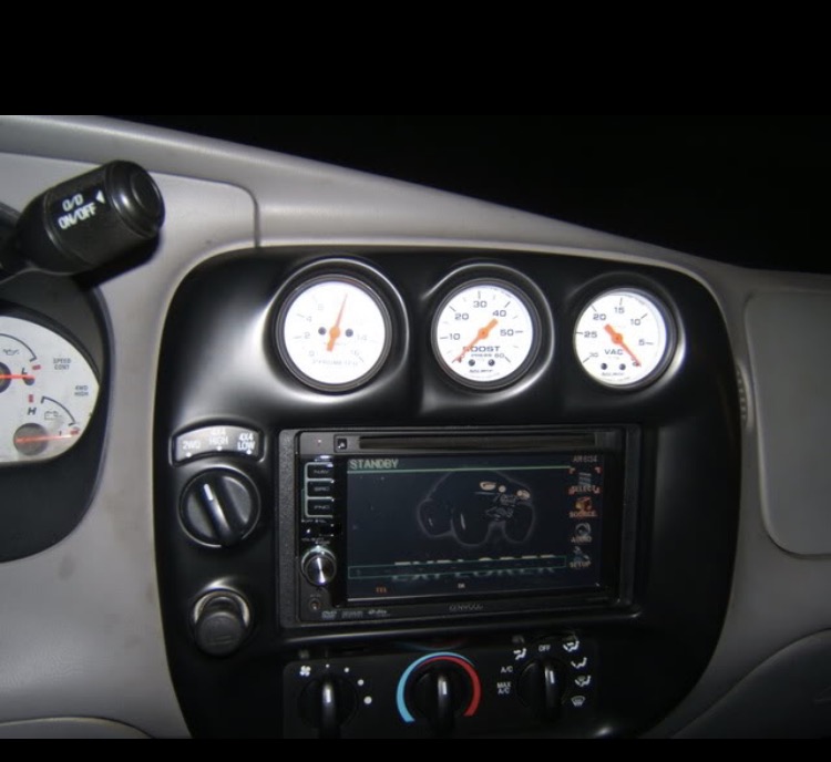

That looks real slick. Especially with the speaker that mutes other tranmissions.
But where did you mount the radio and the speaker?
Jim
Some mount them in a console, glove box or a pocket of available room inside the dash.
I mounted mine where the ECM used to be behind the PS kickpanel. :icon_twisted:

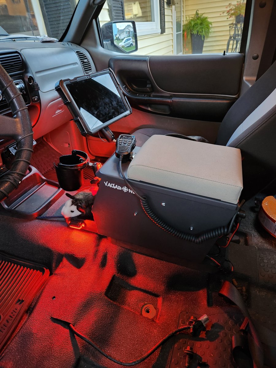

I put in a smittybilt security console and mounted my GMRS Radio to the back.
Clean Way to Mount a 2-Way Radio?
Tell you what - I am impressed with that install.

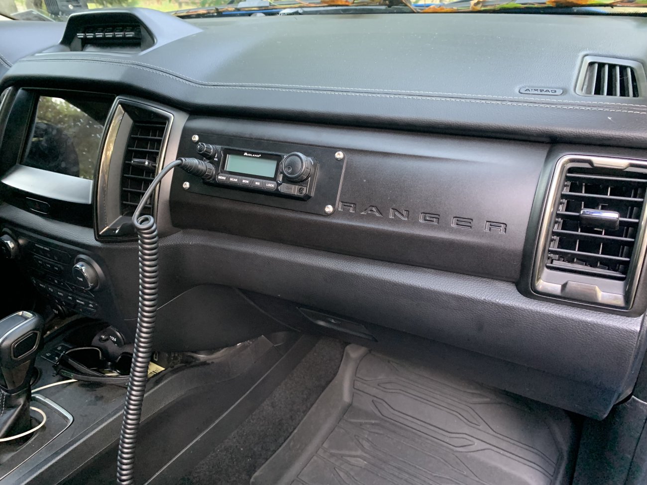

In ‘97 the passenger side airbag was optional. It wasn’t standard until ‘98. Do you have a passenger airbag or a dummy cover?
This is my ‘23 Ranger, but you get what I’m thinking, right.

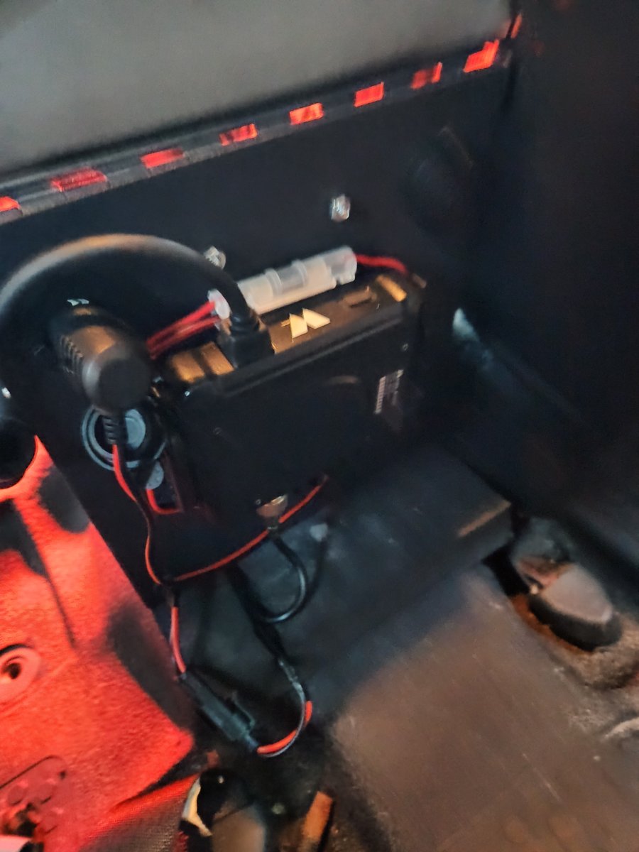

A good friend of mine operates CW with a key strapped to his leg while driving on 40m, mounted his transceiver on the rear of the passenger seat which folds down flat when he's active on the air.
