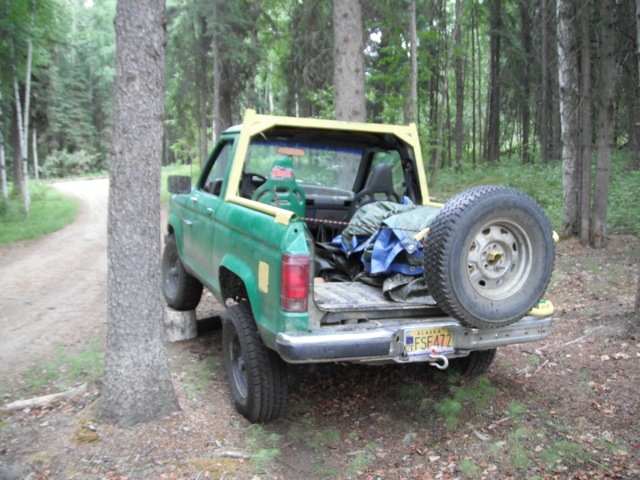

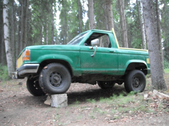

CHopped the toppppp

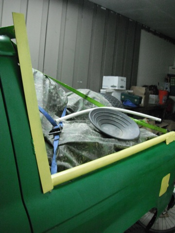

i did it i chopped the top, used angle iron and steel tube for bed rails and B pillar support

post and angle
i took the steel tube its 1/8th in thick, i took a grinder down the whole lenght of it to cut a slot, when i chopped the top i left the _I_ lip the rear windows were attached to on the bottom and used a hammer to persuade the slot over the lip and then took some smaller rect sections of steel on the inner bed and welded them to the bed , the angle iron took forever to weld along the roof seam welded more along the angle iron and let the heat melt the sheet metal roof into the bead tons of small beads did the chop last year survied an alaskan winter so far. in the pic you can see one of the plates at the rear holding it together.
