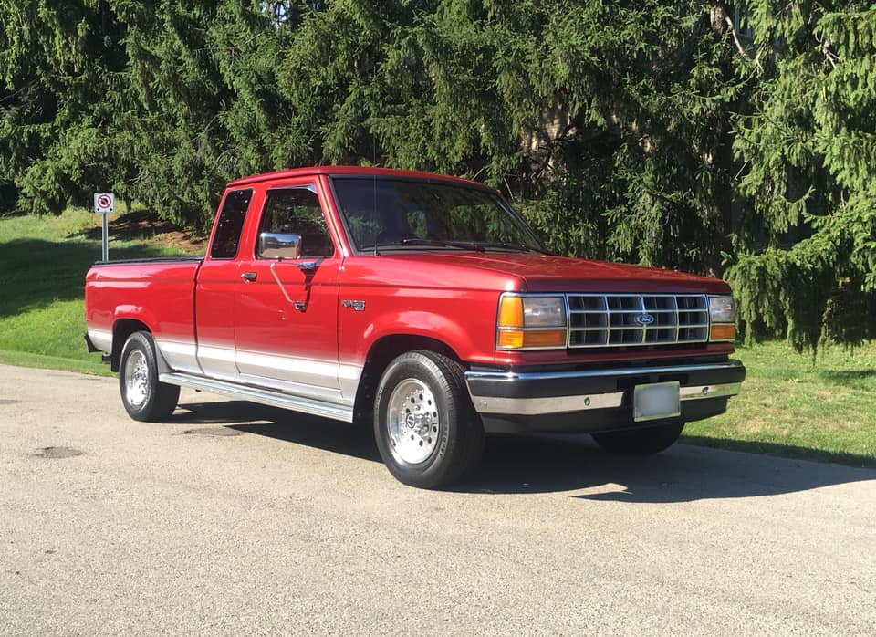

deas for some fairly cheap, easy mods for me to do to my 1992 ford ranger XLT. I'm a beginner and I am looking for good starter projects to take on! Any recommendations?
That's a nice clean looking 92. You'll feel a big difference by changing the gear ratio, easiest way is to swap in a used rear end. You likely have 3.45's or 3,73's, moving to a 4.10 rear would make a noticeable difference. There are cat back exhaust systems that will make a little power difference and improve the sound.
