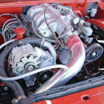

Oh I agree that cold air is better (hard to argue against the physics of that one). I agree the factory intake setup is restrictive, it was done to balance noise and emissions against performance and fuel economy.

I don't bring up the Lightning near as much as I used to. I know there is a lot of jealousy here about it. However, point is the Lightning is a true performance vehicle. Blown V-8. A lot of the guys drag race them and could probably tell you how much they picked up on the dyno when they tossed the stock airbox and replaced it with a CAI. In fact, most dyno tuners recommend ditching the stock airbox and replacing it with a CAI. Because they just don't allow enough air for a blown motor.

Cat-back exhaust is the best bang for the buck. Headers help a little but not a lot when measured against what they cost. K&N in the stock airbox.

Your best bet is to read the building 4.0 for power. You can add headers for a fairly reasonable price and do the air intake a little different. I have headers and K&N filter on a stock built 4.0 with about 6000 miles now, I could tell the difference when I added the headers not alot but noticeable. But if you're just looking for a better sound with a little hp gain, hard to beat headers and good exhaust. I run a single pipe in with duals out flowmaster and sounds good especially between 3500 and 5000.
Let me just say, the only "cold air intakes" worth a damn are snorkels.
You should install a screamin demon 45,000V coil pack with Taylor cable spiro wound 8.2mm plug wires and new platinum plugs, make sure you gap them properly. Those wires are 40ohm/ft. Stock is something like 350 ohms/ft and 35,000V.
**Next get rid of the warm air smog crap that takes air from around your exhaust manifold and unplug the vacuum line to the valve so it stays closed**. Put in a spectre performance air filter. Cheaper than KN and just as good.

After that I would ditch the cats and put in some ebay long tube headers. Wrap and spray them first. If you have EGR, nows the time to ditch that too. You can do a straight pipe, stock or aftmkt muffler but I wouldn't go above 2.25-2.5" ID. Less pressure less torque.
You can do all that for less than $500 and have noticeable gains.
If you want to go further, as previously mentioned an electronic rad fan is a great option. I would also install an engine oil cooler at this time and relocate the filter somewhere that makes oil changes a breeze.
Next I would get 95tm or 98tm cylinder heads. Just stock remans or for extra $$$ I'd get new aftermarket castings. If you do this you'll need to run minimum 91 octane and I would do a performance chip at this time to help manage afrs.
All this would probably net you 50hp
If you swapped cams with the heads for just a comp cam you're probably going to be 20hp over that.
I would caution the promoting things that break laws like deleting catalytic converters. The warm air delete may be a detrimental thing depending on where the OP is located. There are sections of the country where intake icing is a thing and the system is necessary to prevent that issue. Beyond that, I don't have a problem with any of thcscubajon's recommendations.
