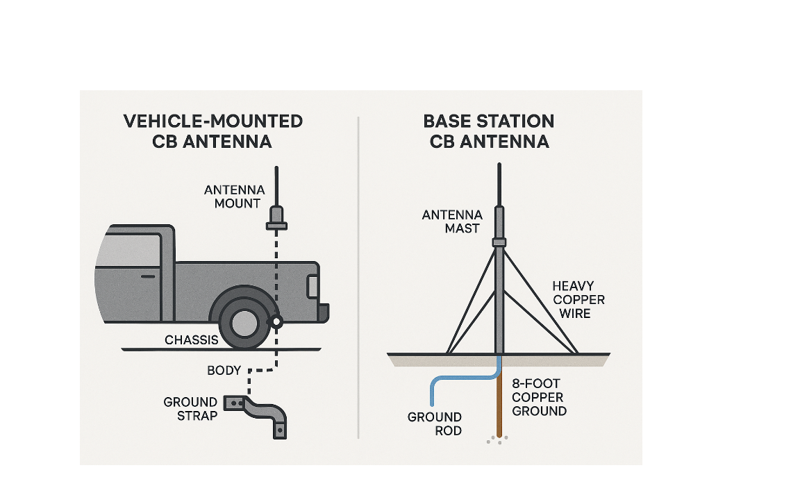

You need a good ground for the output transistors in the radio to be safe and for the antenna to work at all, and in a perfect world, you need a big "ground plane" under the antenna for it to work well. The ground plane shapes the radiation pattern from the antenna, without getting into the weeds.
Adding to what pentode said, it's so your antenna will have a good match (good SWR).
Wherever you mount your antenna, it has to have a solid continuous "plane" of metal under it for your radio signal to travel correctly. Obviously the best plane will be the expanse of sheetmetal that is the center of your roof. But when the antenna is mounted onto some other separate piece of metal that is smaller than the car roof or body (your toolbox) means that piece of metal (toolbox) will want to try to become it's own ground plane if it is not electrically bonded to the body of your truck.
The toolbox itself is much too small to function as an effective ground plane at 27MHz, so is why it needs to be grounded to your (larger) truck body so that it can become part of the bigger ground plane that is your truck.
Here's some further reading on this just so you're not having to take my word for it:

On grounding to your truck bed, you don’t need to run a separate wire, you just need to make sure that the toolbox is grounded to the truck bed, that there is good continuity if you use a meter and touch the toolbox and then touch the truck bed
If it's bolted down, you likely will have continuity between the box & bed on a meter. However this still leaves a chance for corrosion between the (likely) aluminum box and the steel truck bed to form and causing the ground to become intermittent.
Short braided ground straps as mentioned in the links I gave to the bed sides or floor (one each side of the box) can help ensure the ground remains reliable.
