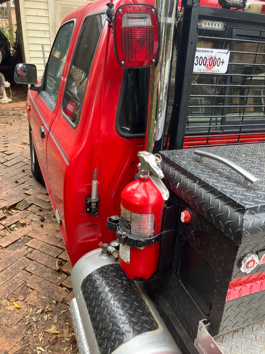

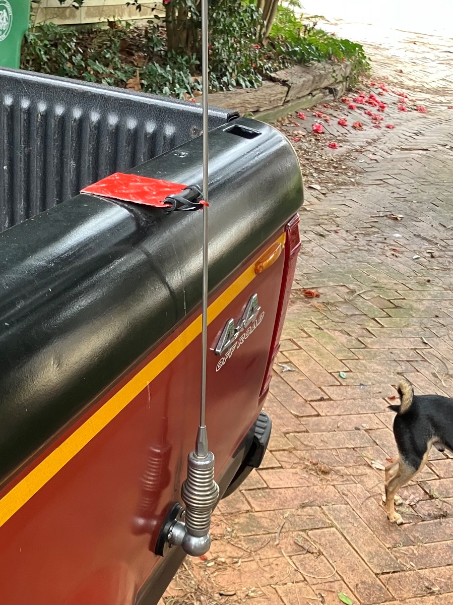

87 Ranger: I said before, I use a piece of flat plastic to stabilize the whip. In this instance, it’s a piece of 1/8 inch aluminum diamond plate. It’s folded 90° to the inside of the bed, and that’s where it’s screwed into the bed top. I split a small piece of rubber tubing, and put it over the edge, to keep the antenna from grounding out. There are two holes drilled out near that, with a zip tie in a loop. The loop is actually inside the antenna, with just a tiny little break away red zip tie holding it to the loop.
That’s my master technician partially in the picture to the right.

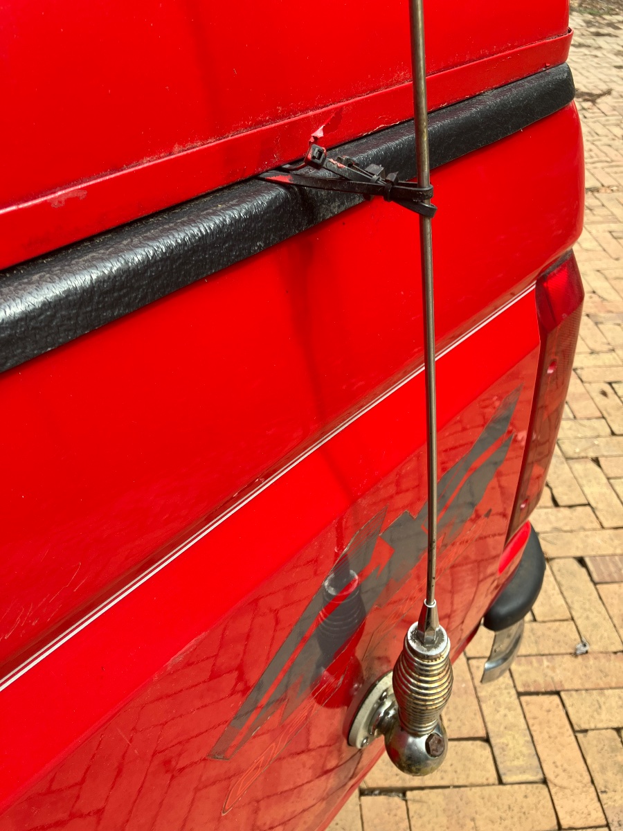

F250: less elegant, but I have a long zip tie looped around the bracket that holds the cap down inside, and again a small zip tie on that to hold the antenna from wobbling

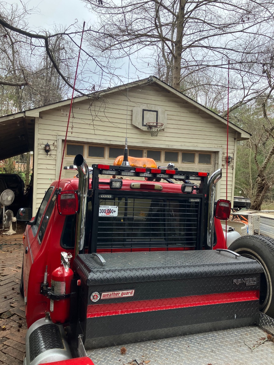

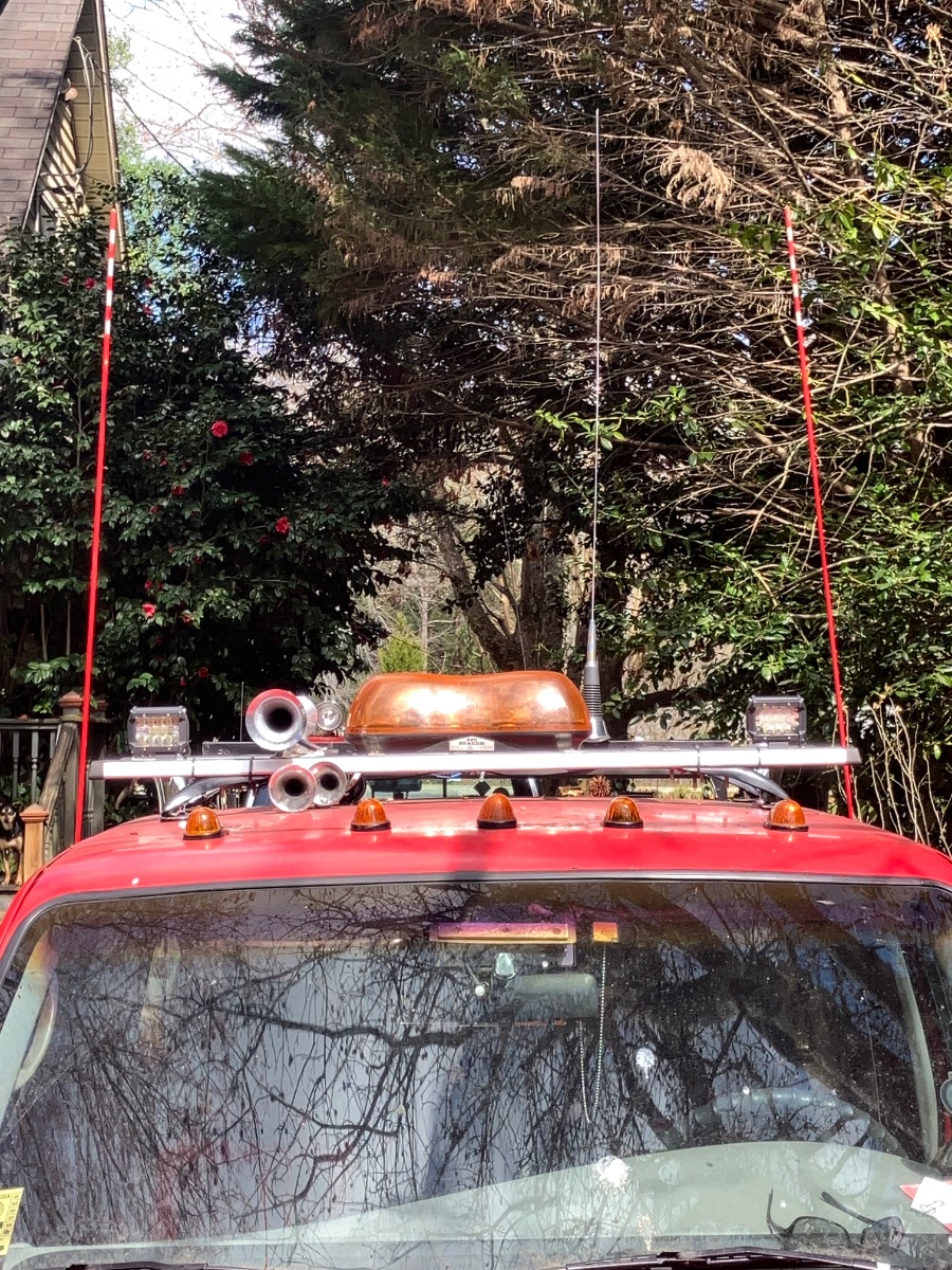

97 Ranger, the antennas: Note the base-loaded whip. That’s for the small radio down by the brake control. You can’t have both on at once or when you key one, it’ll blow your eardrums out from the other. I learned that.
I get a lot of folks asking me where I bought the antennas with the alternating red and white bands on the top. They came from my antenna junk pile accumulated over the years in the shed of miracles.
I painted them with white rustoleum and then with red rustoleum, simply masking out the lines on top. You can paint the fiberglass antennas any color you want, as long as the paint does not have any metallic component (like a silver or bronze metallic).
I mounted them behind the cab a little below the door handles. Only one is connected, but the transmission is still deficient. Asking around and reading stuff, it was pointed out that the headache rack on the truck is aluminum, and due to conductivity and the design, that will interfere with the signal even more than just the sheet metal of the cab. I’m planning on redoing them, but I haven’t figured out exactly how yet. There are other modifications that take priority on the “Road Ranger” for the 2026 season….

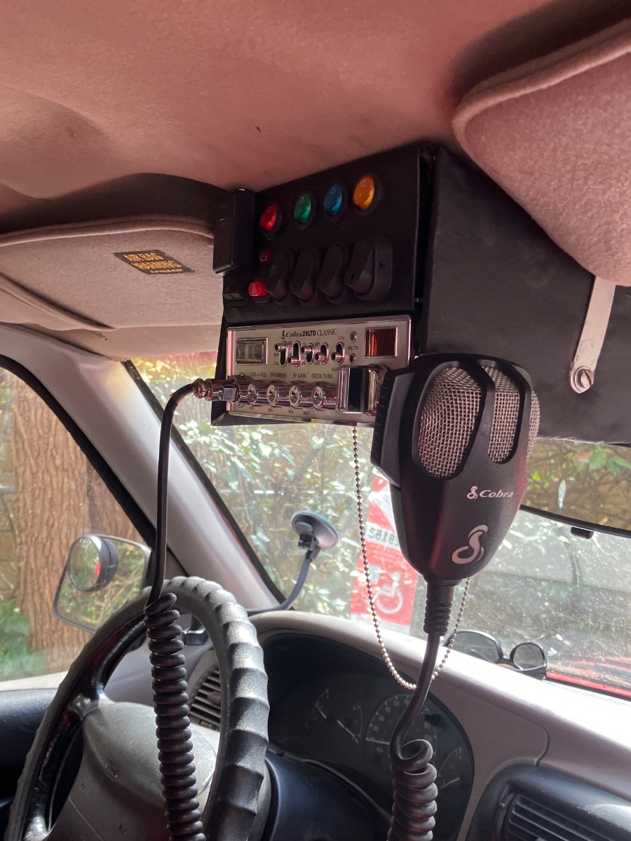

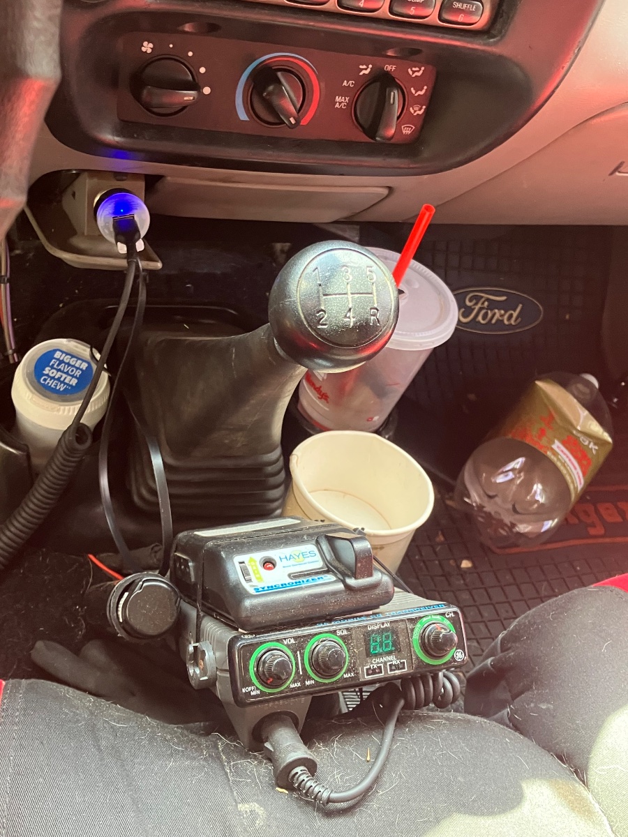

Here’s the final on the Cobra 129LTD Classic set up, The beaded chain is a tug for the air horns. Note, also the little aluminum strap that helps hold the assembly up. I made that, and it runs up over the clip that holds the sunvisor in the center, due to the weight.

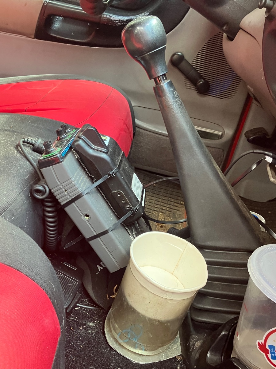

For the temp GE, I made an L-shaped plate that tilts backwards, and I secured it underneath the plastic center shroud that holds the drink holders and the stick shift boot, and mounted my brake control on that. I don’t like them under the dashboard or somewhere else, and by making this custom mount, it’s right at my fingertips while my hand is on the shift if I have to hit the trailer brakes. Since it’s a temporary, I just zip tied the GE radio on the other side of that plate. The mic just sits on the hump in the little hole that’s left.

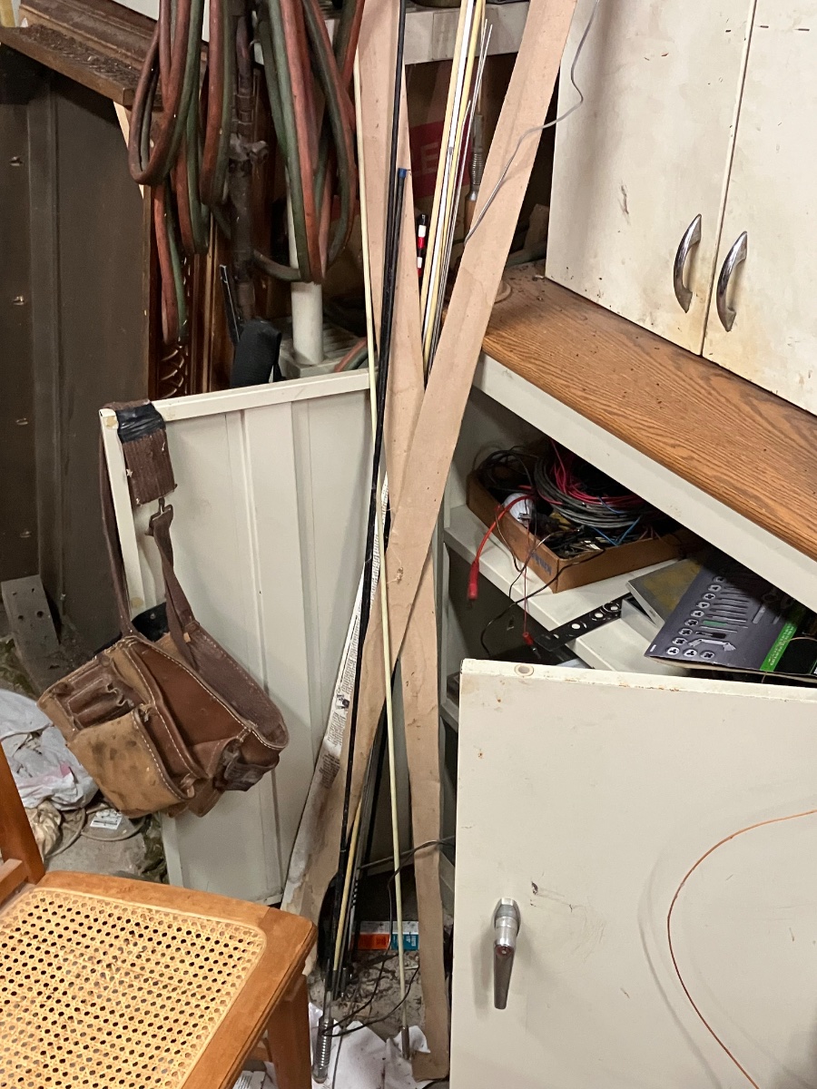

And finally, the CB junk pile in the shed of miracles.
I’m going to swap these two for the radios that are currently in the 87 and 97. Then I’m sending those to the CB shop to get tuned up. I like them with the front mount mics for overhead, and left side mics for under the dash or the hump.

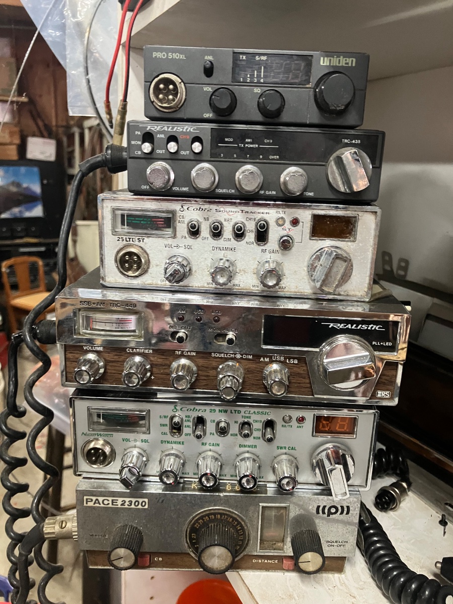

Also on the shelf:
A couple radar detectors over some small radios with a pile of microphones and some walkie-talkies on the left. The two 479s are on cigarette lighter plugs, and I have the little magnet antennas for when I’m following somebody or vice versa. Very good little radios.
Spare cobras and others. The Uniden is a great little radio, but I’m not sure if any of my mics will fit, and I don’t want to burn it up with a cross wired mic. And a third Cobra 148 GTL. And the big Realistic has some mods and switches on the side that were added, but I’m not sure exactly what they do. It’ll go to the radio shop when I send the two in the trucks. I think I’m going to use that one for the 87 town car if it checks out OK.
And the rest. The 23 channel Sears Road Talker single side band is as big as a Volkswagen, but it will look proportionally correct on the hump of the Marc V. I have to replace the Mike outlet, a task for down the road.
I think there’re a couple more, but I couldn’t find them quickly.

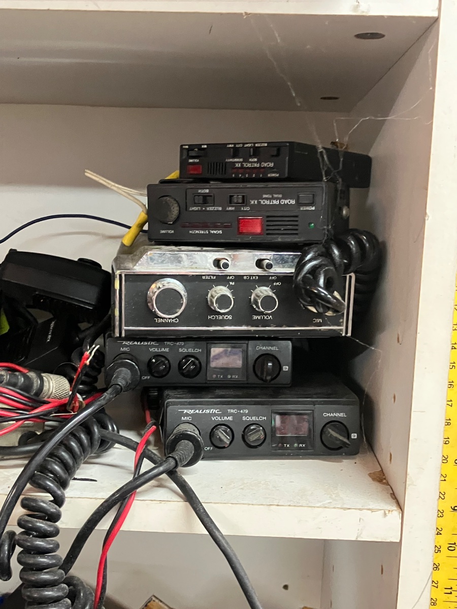

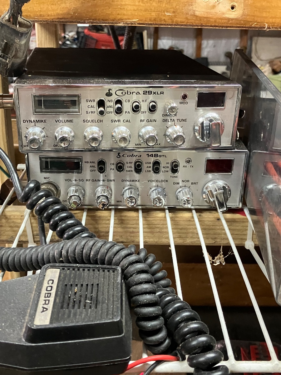

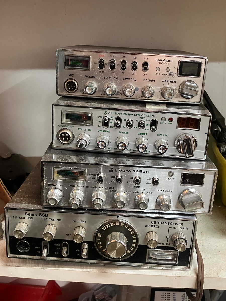

Also on the shelf:

Do you have any idea what those two little switches on the side of that big realistic radio might be? And how I would test what they might do?

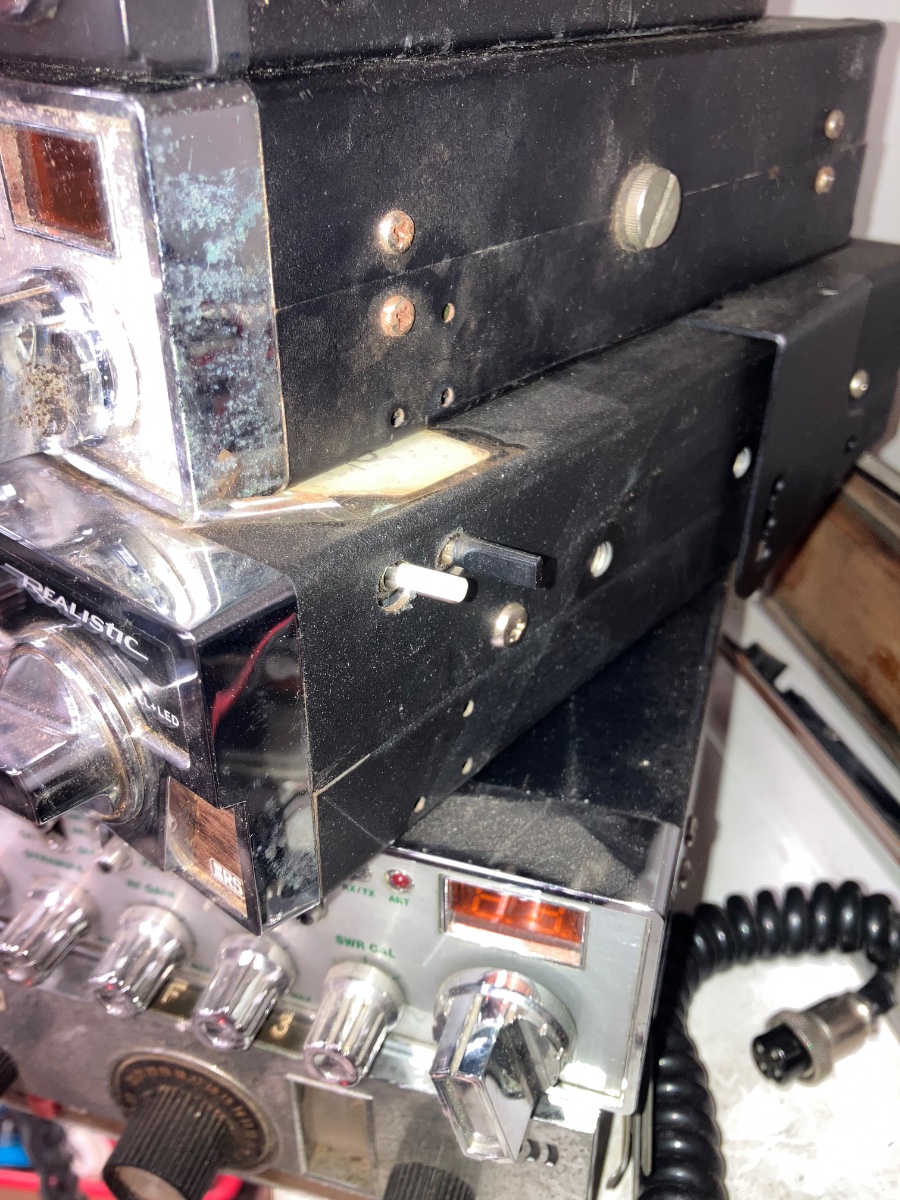

@sgtsandman
Probably some aftermarket mod. Maybe an amp or something. Definitely not original equipment.
Yes, I know it’s aftermarket, but I have no idea what they actually do. So I’m looking for a little guidance on how I would check it out without spending money. I do have a test bench and get broadcast from that bench.
Open up the case and see what it is connected to. Post a picture.
@sgtsandman
Not a clue. Pictures might help. If it's aftermarket, you might have to take it to a shop and hope the person at the counter has some experience.
