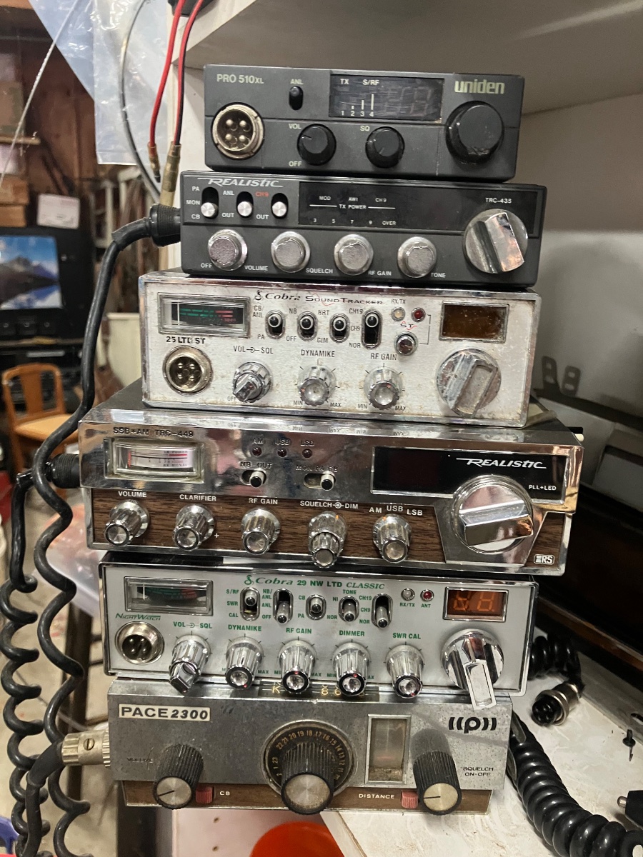

And finally, the CB junk pile in the shed of miracles.
I’m going to swap these two for the radios that are currently in the 87 and 97. Then I’m sending those to the CB shop to get tuned up. I like them with the front mount mics for overhead, and left side mics for under the dash or the hump.

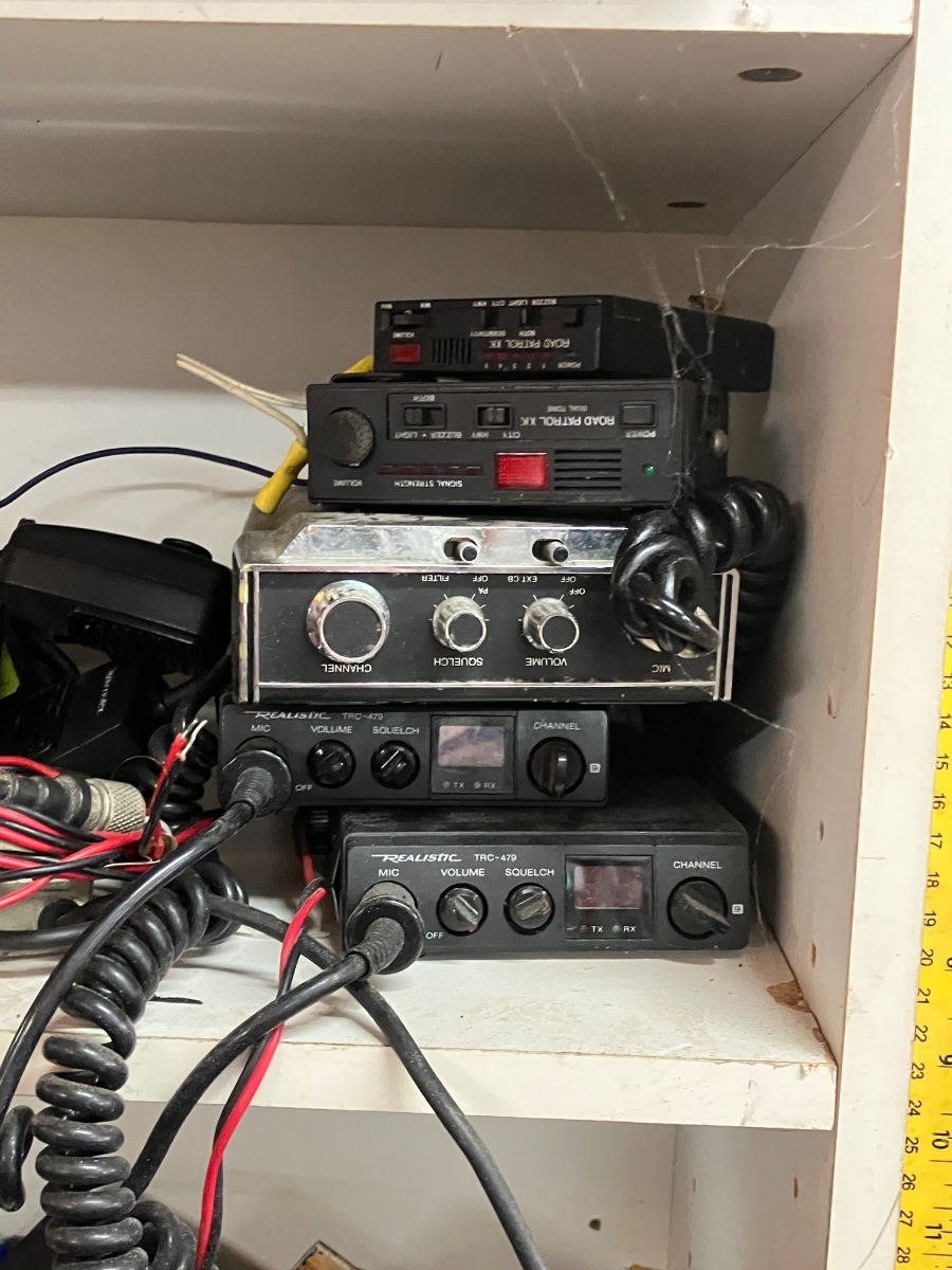

Also on the shelf:
A couple radar detectors over some small radios with a pile of microphones and some walkie-talkies on the left. The two 479s are on cigarette lighter plugs, and I have the little magnet antennas for when I’m following somebody or vice versa. Very good little radios.

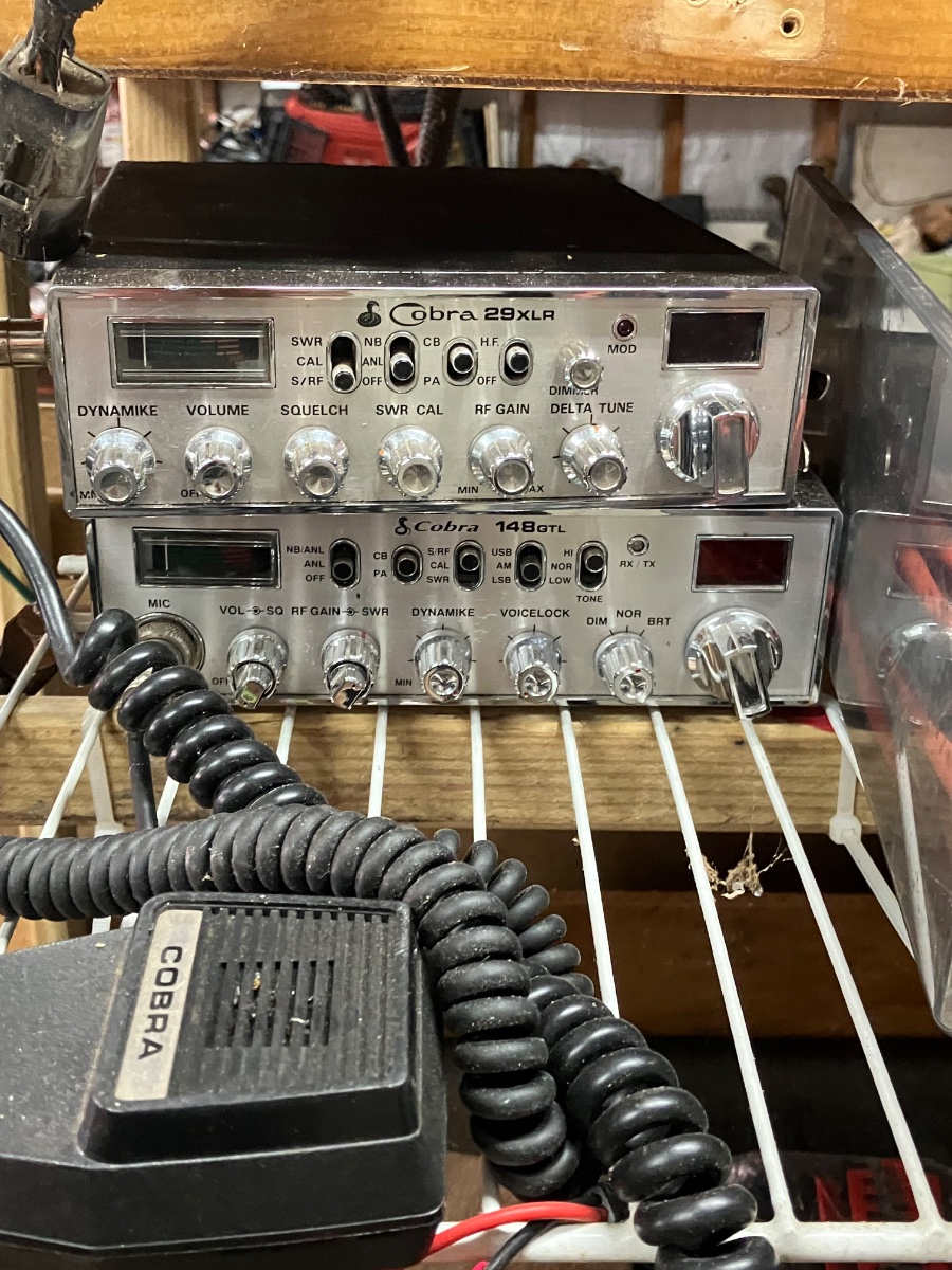

Spare cobras and others. The Uniden is a great little radio, but I’m not sure if any of my mics will fit, and I don’t want to burn it up with a cross wired mic. And a third Cobra 148 GTL. And the big Realistic has some mods and switches on the side that were added, but I’m not sure exactly what they do. It’ll go to the radio shop when I send the two in the trucks. I think I’m going to use that one for the 87 town car if it checks out OK.

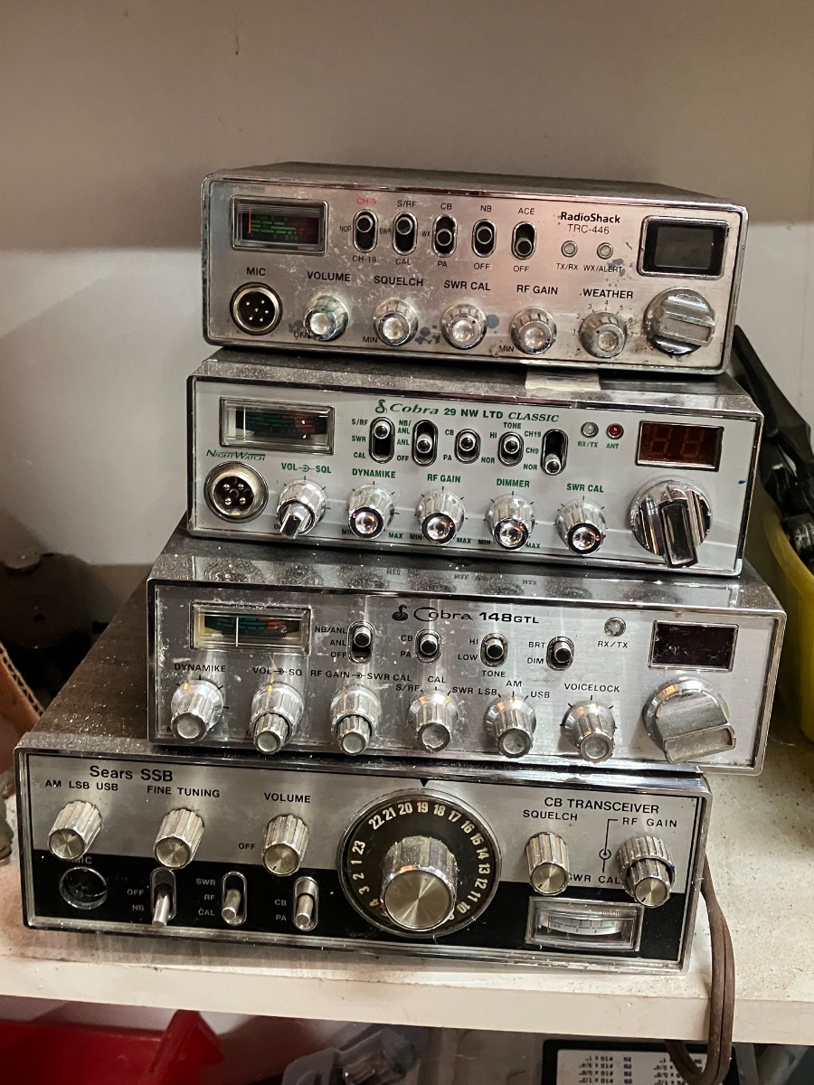

And the rest. The 23 channel Sears Road Talker single side band is as big as a Volkswagen, but it will look proportionally correct on the hump of the Marc V. I have to replace the Mike outlet, a task for down the road.
I think there’re a couple more, but I couldn’t find them quickly.

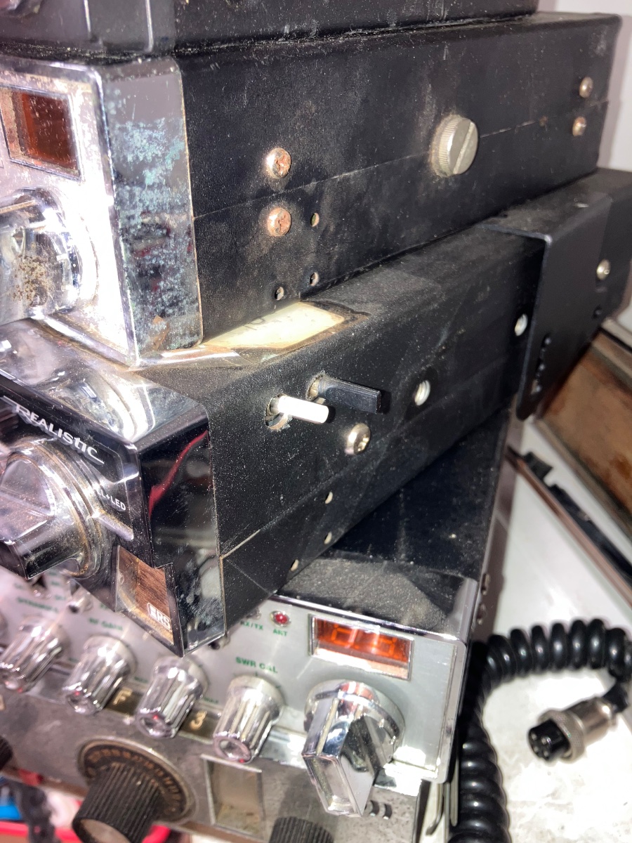

Do you have any idea what those two little switches on the side of that big realistic radio might be? And how I would test what they might do?
Quite likely it's extra frequencies (a.k.a. "freaks", or "funny channels").
Do you have a frequency counter to check it with?
×2, a picture of the area the switches are wired into might help. Those radios had the µPD858 frequency (PLL) chip which had enviable channel-capability in their day (but were outclassed by so-called "export" radios that began appearing maybe not quite a decade later).

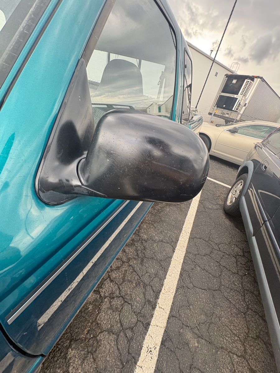

How is the antenna mounted? Do you have any pics?
Mounted on my toolbox

The more out in the open the better for tuning the antenna. That spot you showed in the photo would be fine though. As long as there's nothing within a foot or 2 of the antenna you should be good.
