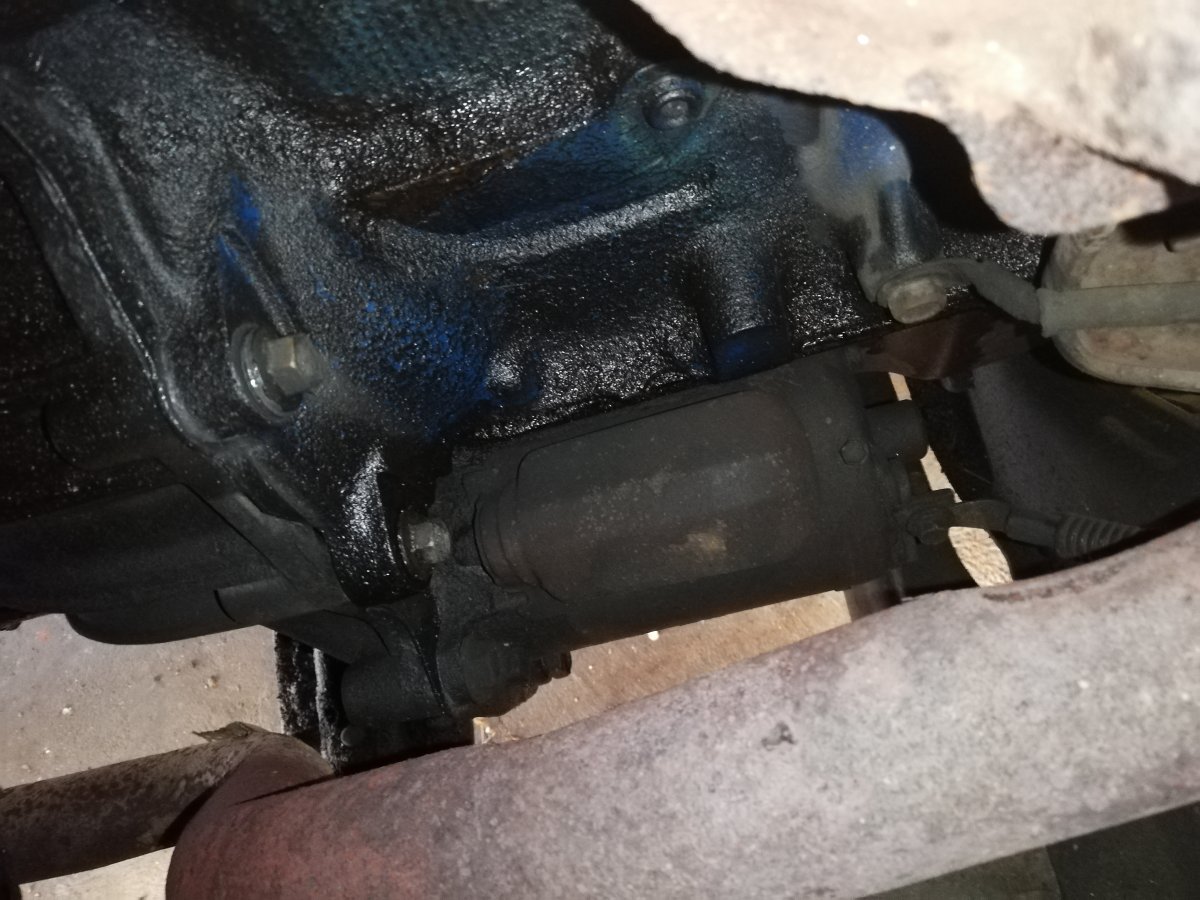

OK, differential diagnosis:
How do I decide between
A) Throw out bearing is bad
B) Something wacky is rattling on the underside
Rattle is definitely louder on the passenger side when I'm looking down at the starter.
When I was under there on the driver side looking up at the bellhousing, it *seemed* quieter.
I think I'm set on doing this clutch kit anyways, since I just bought a transmission jack, but how do I check for what @Uncle Gump was talking about?
So that's my starter yeah?

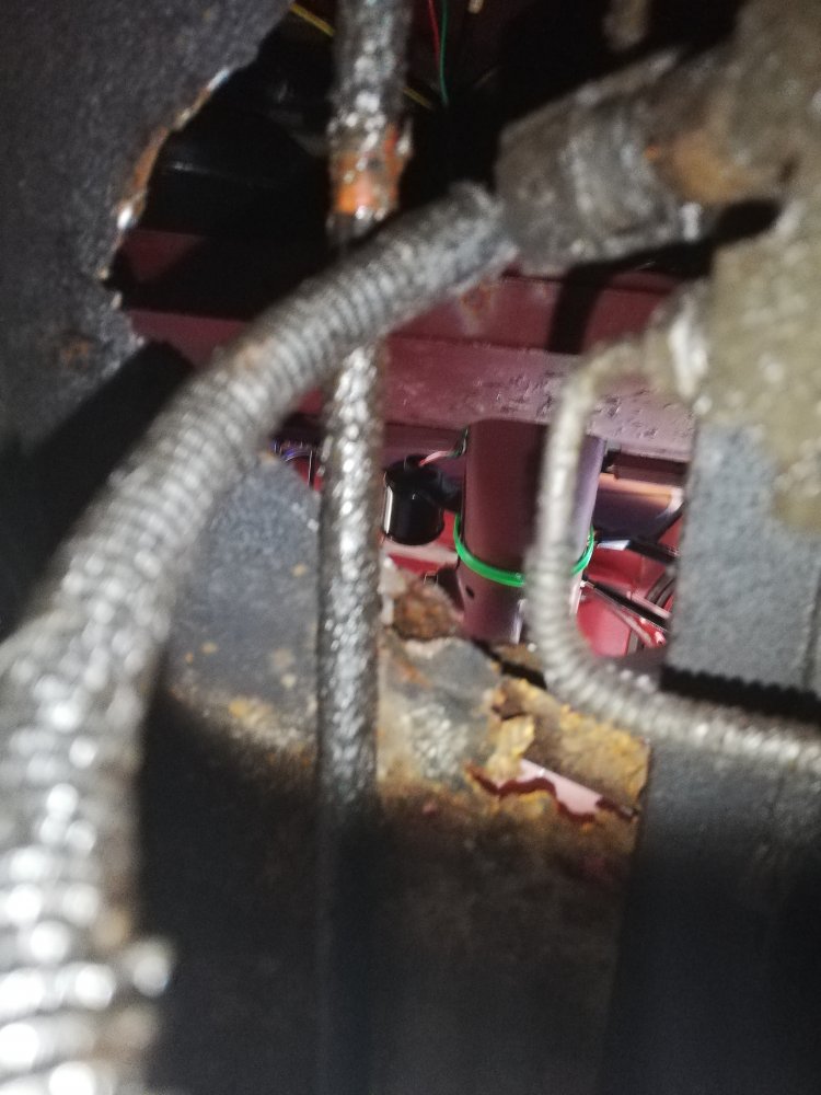

Bonus pic: here's what my steering column looks like when viewed through the floorboard hole :)
