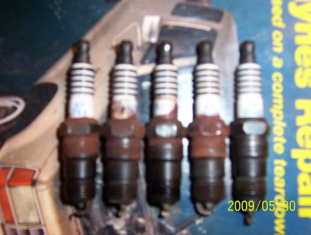

wow wtf i just changed my plugs and the old ones were Autolite Platinum AP 764s and the porcelin is red on like 3 of them and there pretty toasty lookin...the walmart book said they take Autolite Platinum AP 2545 and the difference in those plugs is pretty big...the olds plugs were alot shorter then the ones that are supposed to be in it...i fired it up and it didnt stall though and it seems like it doesnt studder when i barely touch the gas pedal like usual, ill have to take it for a drive some other time, but is this really bad?
the plug all the way to the right is the AP2545 which is supposed to go in it, the others are the plugs i just got out of it AP764s.
