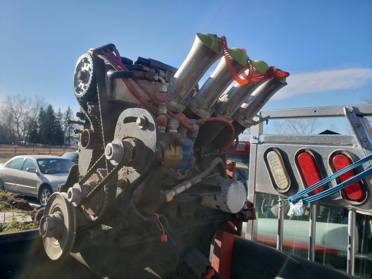

No ideas yet but I did pick up a motor built for the salt flats. I will be taking it apart sometime in the next year and will post results. It has home built mechanical fuel injection and some high dollar parts on it and was told that there was some major head work done.

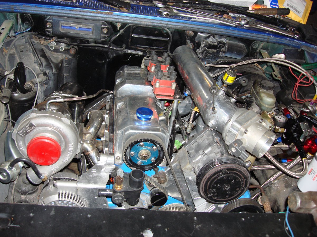

On the 2.3L Lima there's a lot of room for improvement in the intake side of the head, even a little playing with a die grinder will help... don't go too crazy, don't attempt to gasket match just smooth things out... when I ported my 2.3L head I lost like 3psi of boost after the rebuild which means the air actually got into the cylinders instead of being a restriction...
