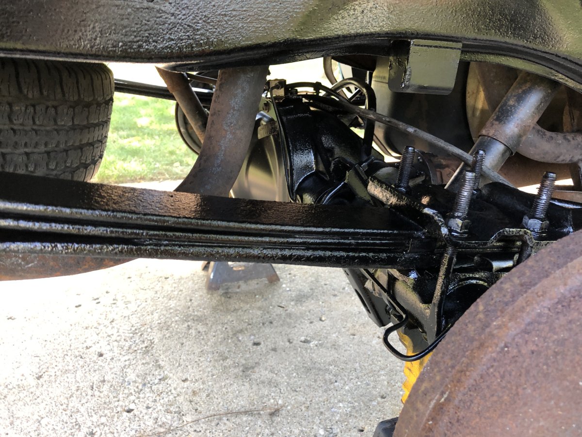

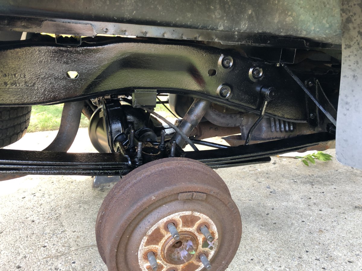

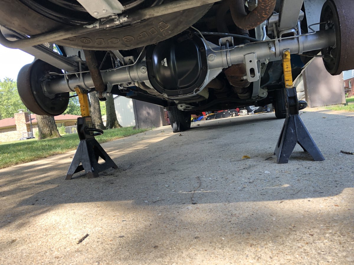

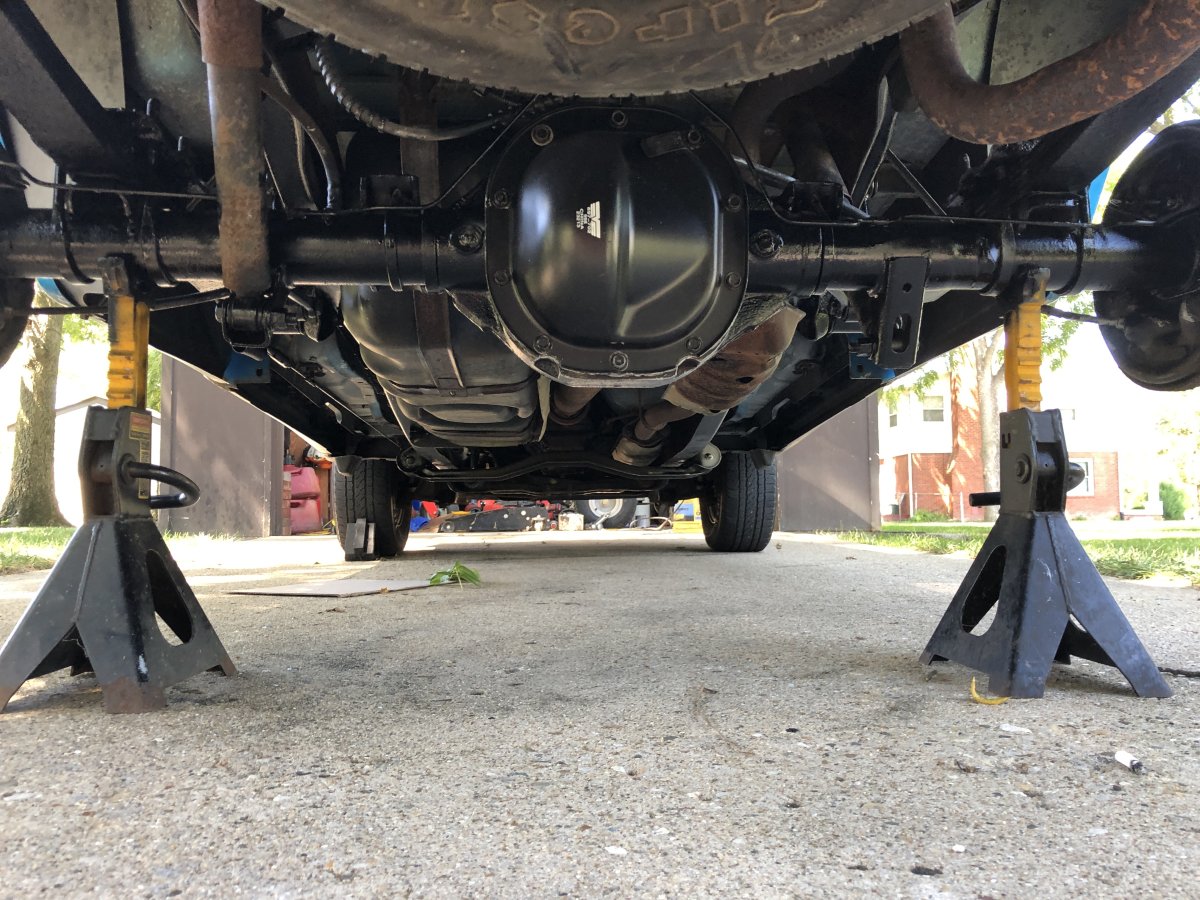

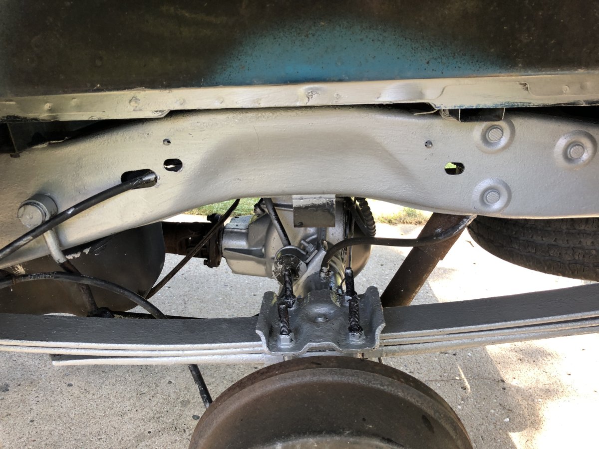

Well, I've been on a de-rust campaign while I wait on the rest of my brake parts. Took a scaler to all the brackets, then sand-blasted where appropriate to remove all of the original peeling factory undercoating (I think it was factory applied anyway). Applied Eastwood rust converter, then a coat of eastwood rust encapsulator. It's all set up now, going to get a top coat of semi-gloss black now.
Also while I was digging in my paint cabinet, I found an old car of POR-15 caliper paint. I always paint calipers black and once I accidentally ordered blue from Amazon so I figured, why not use it.

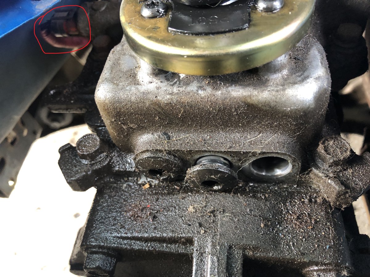

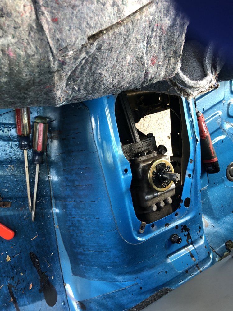

Well, due to a really slow drip (transmission fluid), I decided I needed to seal up the shift rail plugs. I got the Doorman 555-093, and they are NOT the correct plugs. I can't even remember where I got that part number at this point, but they are far too large by about 1/2". so in the end, I just used HondaBond, cleaned up the holes and plugs super-clean, and sealed them up.
I also decided to install new shifter bushing kit while I was in there since it was really sloppy. I discovered when I took it apart that there was no bushing left at all, totally gone. All that remained were the spring washers... so that plastic is swimming around in the bottom of my transmission somewhere. I don't figure it should really hurt anything though, it's soft plastic and has probably already been down in there for years. One thing I don't like is that the shifter is now TOO tight... but I'm too lazy to take it back apart and take out the spring washer. I figure it'll wear in eventually.
I also discovered that the leak may not have even been the rubber plugs. It appears to me that it may be leaking from whatever the sensor is up near the top of the trans on the D-Side (circled in red). I'm not sure what it is for though.

That should be the reverse light switch. I would try taking it out and using a little Teflon pipe tape on it.

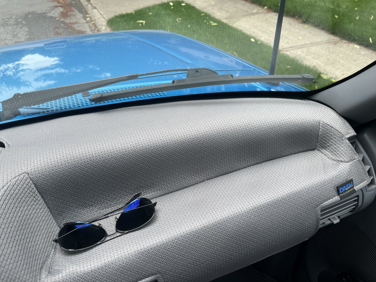

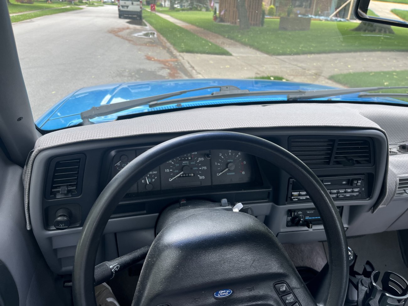

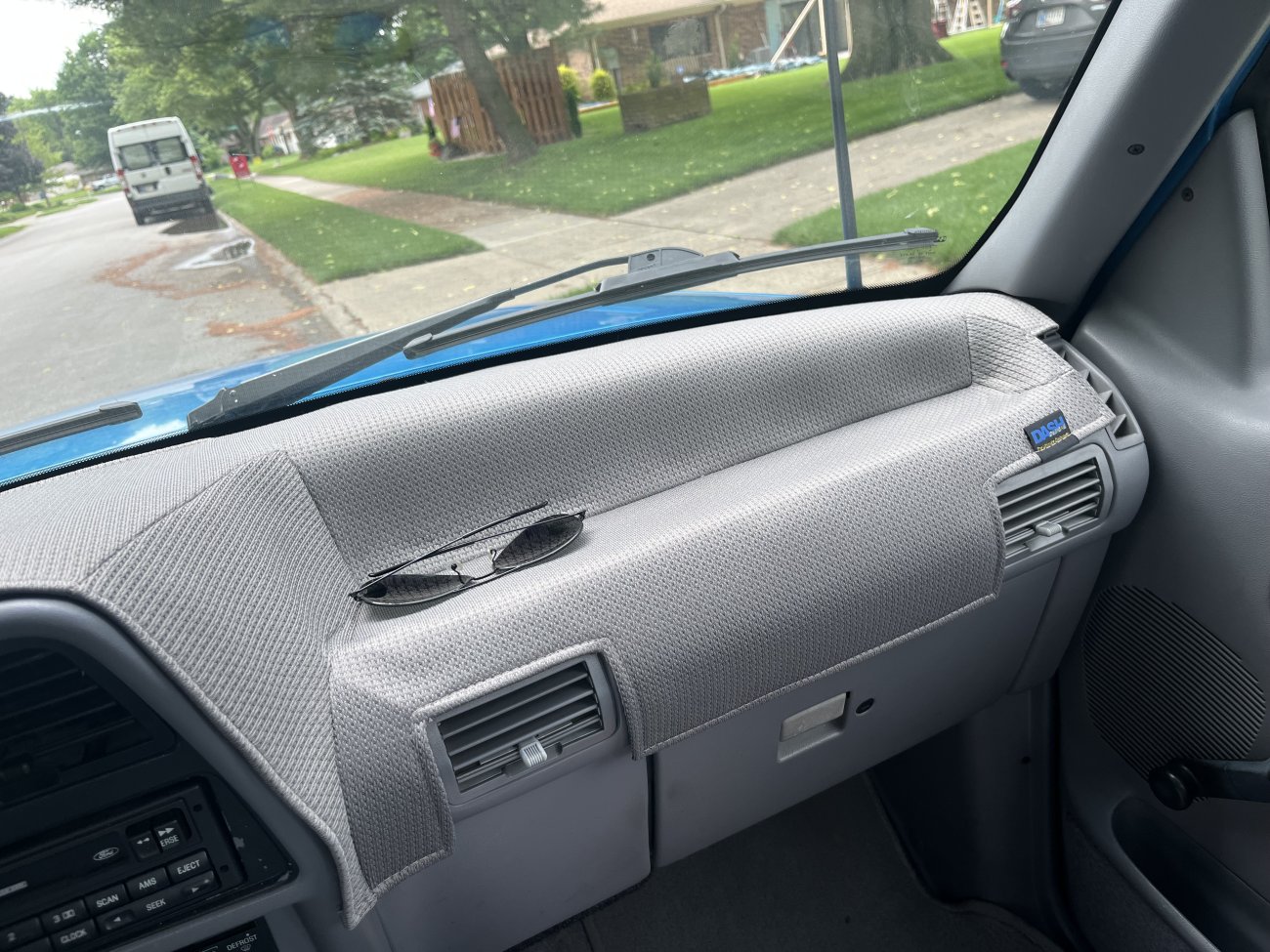

Coming up on 1 year now, the Ranger is doing great. It's about the only vehicle I drive now. Ive put about 6K miles on it putzing around and a few trips up north do do property maint. It's running great. I did notice a crack was barely starting to form in the dash, so I got some clear 3M trim adhesive and injected it into the crack and filled as much as I could underneath, them smoothed some on top. I then installed a Dash Designs cover to keep the sun off of it. I'm not a big fan of the dash covers, but I figured what the heck. The dash is going to crack all to hell eventually so I may as well try to mitigate it for as long as I can. It fits pretty well and I think I'm happy with it.
