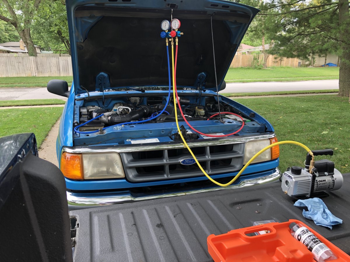

I bought the cheaper RobinAir gauge set but I was disappointed to see that they look very similar to the cheap-o Amazon ones for less than half the price. Oh well, live and learn I recon. At least RobinAir will actually talk to me if I have a problem with them in the first year.
I dumped all the compressor factory oil, put 3.5oz back in the compressor, and 3.5oz in the low side accumulator. I also added 1/4oz of UV dye just in case so I don't have to waste a charge looking for a slow leak. Got the famed AutoZone vacuum pump loaner. It's only single stage 1.8cfm, but I'm not going to complain about free loaner stuff.
Been running about a half hour so far. I'm probably going to let it evac for at least 2 hours before I try the charge.

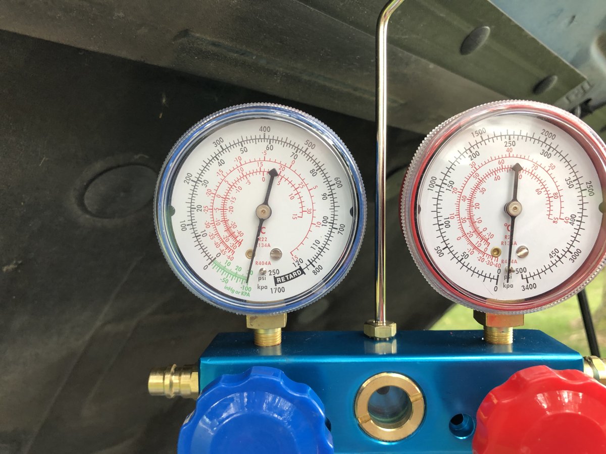

Pulling 30 inches is good; 2 hours would be good too. Longer would be even better- you can't over-vacuum it.
Yea, I can't overstate how happy I was to see that it at least doesn't have any massive leaks.

Two hours would be "sufficient"; but . . .
I was thinking I would follow a guide I saw in another post... evac for a couple of hours, unhook it all and let it sit overnight, then hook back up tomorrow and see if the vacuum held.
That would be mo bettah.
But there's no need to "unhook it all"; just close the hand-valves on the manifold (gauges). When you disconnect a hose you're losing a little vacuum or charge.
When you're ready to call it a day, close the valves, turn off the pump and note the gauge reading (low side vacuum). If overnight, be sure to check the gauge for any change, and you can run the pump and open the valves for more evacuation time.
Repeat the process to charge; valves closed, pump off. Connect the can tap to the yellow hose and loosen and tighten the yellow hose coupling at the manifold to purge the hose (that's why you should avoid disconnecting /reconnecting hoses).
Open the low side valve to charge. Start the engine, AC on max, and it's OK to jumper the low pressure at the beginning to speed things up (otherwise it fast-cycles). Good practice is to only gas charge, and agitating the refrigerant can will help. Stock system, go by the weight charge sticker on the truck, and if I remember correctly the Ford manual has tables for pressure readings based on temp if you want to fly by gauges.

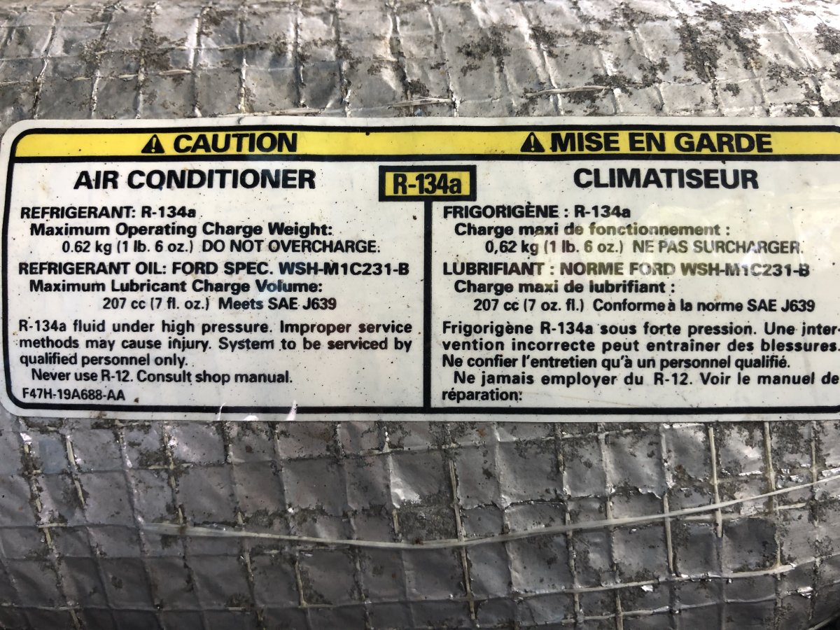

I've been reading all over on how much r134 this thing takes because there is no sticker where I thought it should be. I originally saw someone claim 30oz. Then I saw others say 3 full cans. I couldn't find the weight called for in the shop manual, I could only find the oil quantity required. I'm sure it's in there somewhere, but I couldn't find it.
I finally found the stupid sticker on the truck just now and it says 22oz. I've replaced everything on here with aftermarket stuff, but I'm going to assume the needed capacity is the same. The way I understand it, if it blows cold, it has plenty enough refrigerant. If it's too little refrigerant, it just won't get cold enough, but too much can be a problem. So anyway, I'm going with the 1lb +6oz on the sticker.
And for those who find this search years from now, it's a 1994 Ranger 2.3L manual, 2WD. The sticker is not in the front where the belt routing sticker and stuff is at. It's on the passenger side of the insulated evaporator box on the firewall.
