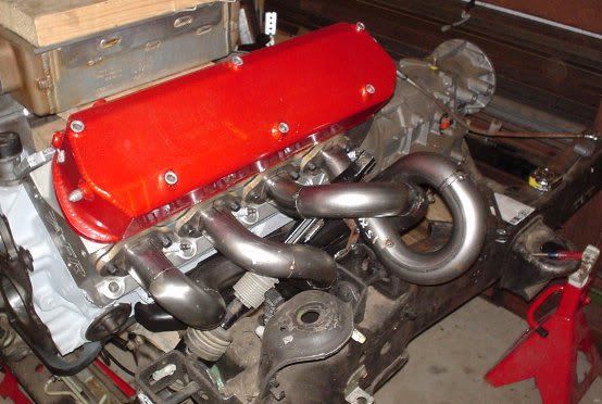

Found a good reference photo of someone doing a 351 in a late model and fitting the headers in. I think he's using 1 3/4" tubing. It's just tight but if there is a will, there is a way.

Those look like they are all separately flanged to the engine, are they completely independent of each other, or do they slide over the column?
I was thinking about doing the headers segmented like that, but I was thinking that I was over complicating it by going that route
