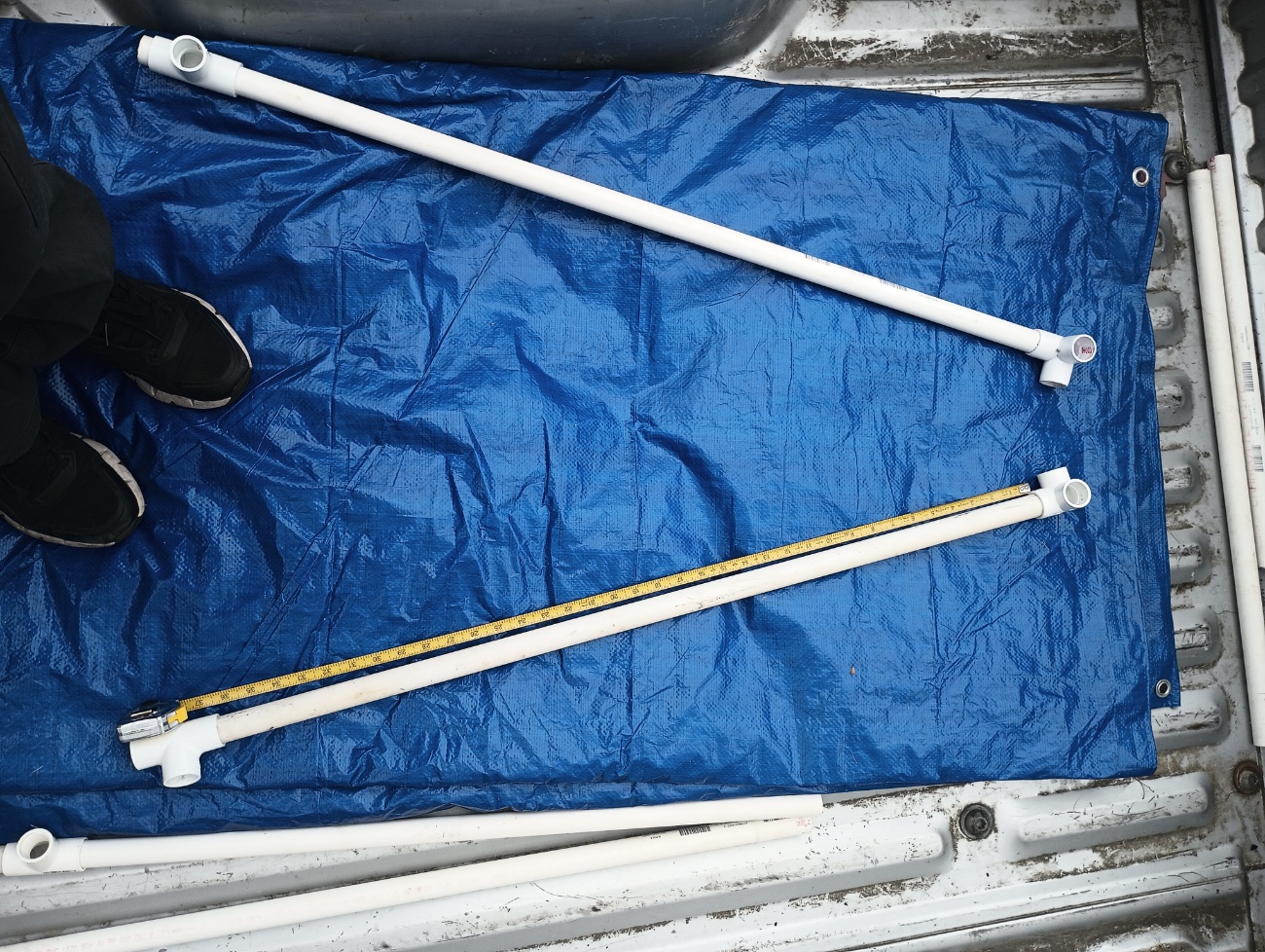

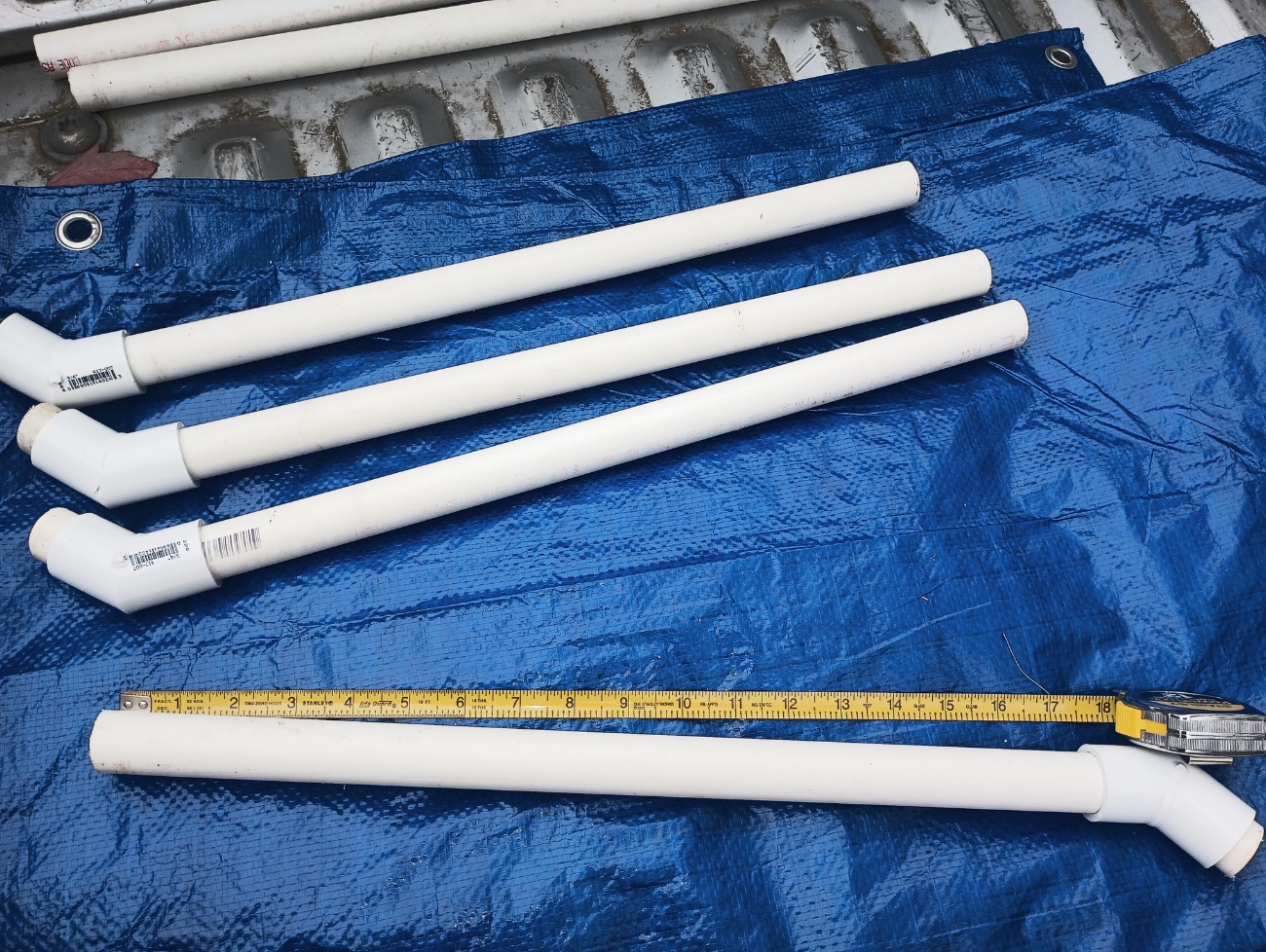

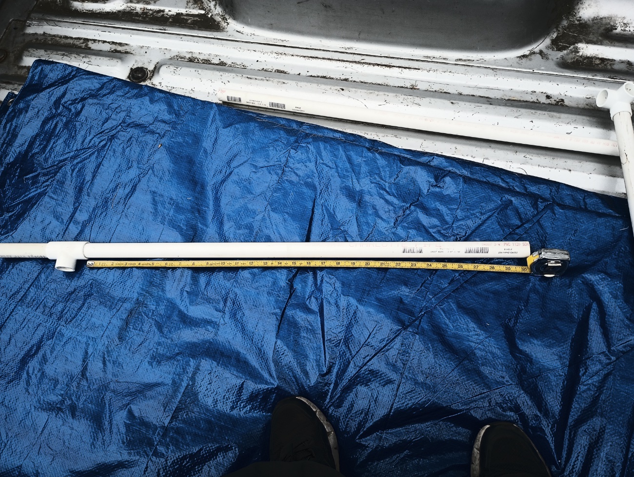

I made a redneck "A" frame tent for camping over Labor Day.

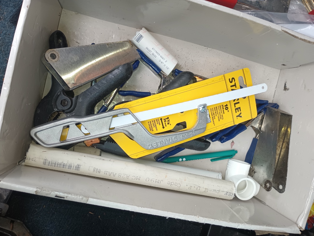

Material: (4) 18" base, (3) 62" Rail support, (4) 30" support for "A" frame, (2) 37" A frame. All PVC and fittings. I got myself a small little cutter as well. My tarp is a 19x19 so that I may have enough space to run it over and cover the tailgate. I'll update with the build after Labor Day.

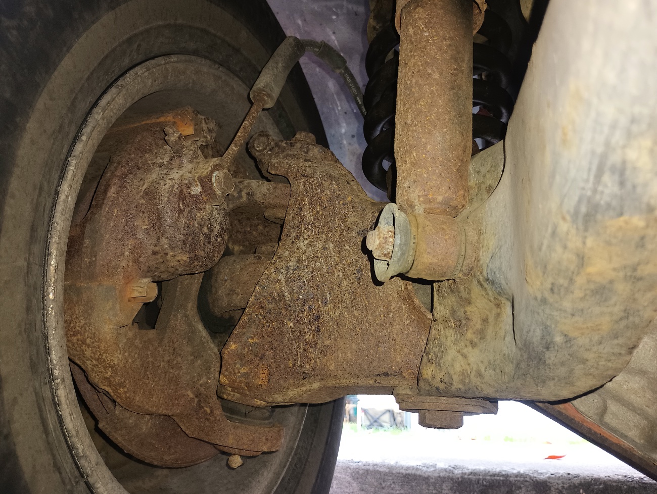

09/08- Got an inspection done for the brakes and it's not urgent but I need to service the bearings and replace the upper/lower ball joints. The quote came out to $2,013. I'd like to see if I can either service the bearings myself or replace the ball joints.
I need to price out the shocks and then install those before I can save for the bearings/ball joints.

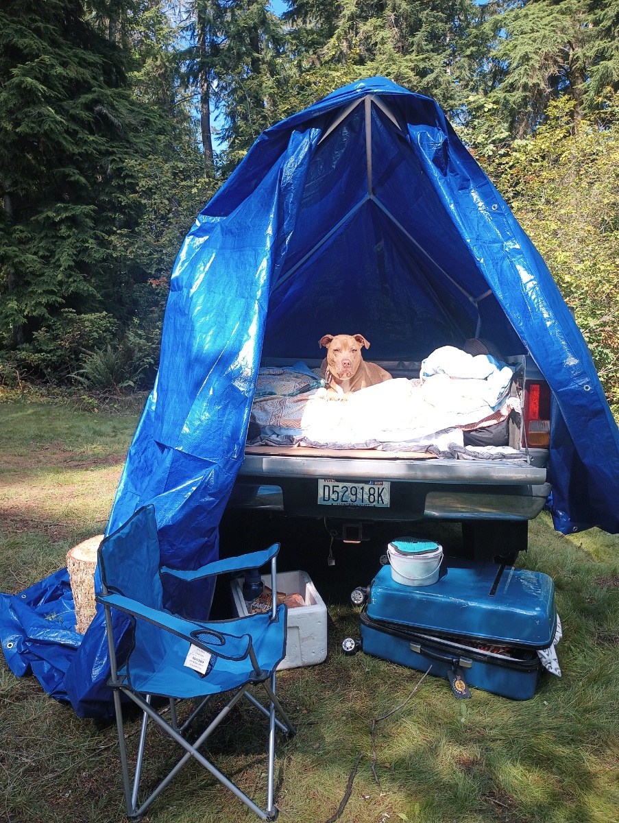

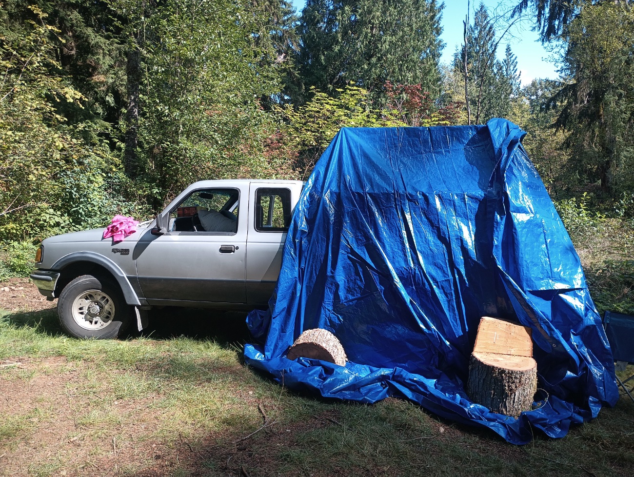

*Labor Day was pretty awesome! I was down towards Three Lakes, WA and slept great with my dog Duke. I had a lot of compliments(and warnings) on not only my set-up but the fact that I'm a lone female camping. I got tips from a group of elders whom told me to get off the internet and study my manual instead.

7 HOURS to replace 4 ball joints? plus another hour for wheel bearings? (you're already in there when you're doing ball joints........................................)
I do not usually comment on other shop's labor amounts but that is obscene. That MIGHT be a full day job for the worst, rustiest junk out in the depths of the rust belt, for an inexperienced guy. I am thinking maybe a couple hours per side at most on a west coast truck at MY work pace would be fair...that is not a hard job by any means. It's actually pretty easy in the grand scheme of car repairs.
Do you have somewhere indoors you can work for a day or two? If so take that $2000, buy a big cordless impact and a ball joint tool from Harbor Freight and some basic sockets/hand tools. The most expensive ball joints on RockAuto right now are $32 each. Brand new rotors, pads, Timken bearings and seals are maybe $350 at most total.
You will be into that maybe $1000 at most. Doing it yourself you will have another $1000 in your pocket plus you will have invested in your own knowledge. If you were setting up gears or rebuilding an automatic transmission I'd tell you to have a shop do it...but ball joints & brakes are NOT rocket science.... YOU can DO this!

Fantastic, that is a great attitude to have! Everyone has to start somewhere, I was doing that type of work in a gravel driveway with one small bag of tools when I started out. Doing stuff like this yourself is a real confidence booster.
Yeah, none of that is particularly difficult to do unless everything is a rust blob, but a torch fixes that problem.
Access to a garage with a lift is absolutely awesome. A couple times in the past I’ve been able to wrangle time on a lift at different places and it’s a game changer. Way easier to work on like that, but all of that can be handled in a driveway with a jack and jackstands.
Definitely think that garage is being a bit excessive in their charges.
When I get into ball joints, I think hard about putting new U-joints in the front axle shafts while it’s all apart. I’ve replaced them before even when they weren’t bad but I was in there and really didn’t want to tear the axle back apart anytime soon because of heading into winter or something. I don’t have a garage and lift of my own yet but I did build myself a mini workshop which has been a big help. I started with a socket set and determination. The impossible just takes a little longer to accomplish.

I don't know about a torch but I was checking out some spray for the rust. My jack is currently inaccessible but I do need to buy stands. I was looking at the vin again to see what axle I have then checked the resources here about axle's and I think mine in a 35 rather than the Hybrid. I was trying to figure out what you were talking about when referencing U-joints. Midas tried telling me I needed to replace the axles but when I was under there, I couldn't see what they were looking at that was "Bad". 😒

I will say this is where all my mechanical skills have come from. I never had money to just throw around. So every time something has broke or failed over the years, I've had to just figure it out. It does help to have TRS crew here to help. They have been a God send. More than one occasion I've felt in over my head. These guys gave me the confidence and advise to complete the task. You got this man. Like @Shran said above. With the right tools it shouldn't be but a couple hours each side. I done my Sport Trac in one day before lunch in a gravel driveway on jack stands. The ball joint tool i used was actually a loan a tool deal Autozone had.

I’m in the worst of the rust belt so an oxygen/acetylene torch is almost a necessity. I’ve had to cut ball joints out before because the nut was nothing but a round rust blob. Nothing to put a wrench or socket on.
Seafoam Deep Creep or Kroil is probably on the better end of penetrating sprays.
Yeah, unfortunately old videos, I’ll have to try to see if I can either use my new editor to try and up the volume or redo the video at some point. Really I just wanted to give you an idea of the work involved.
If you look under the front and count the bolts on the beam holding the differential on, 10 bolts is a D-35 or hybrid. If the aluminum front differential part is smooth and no fins, it’s a hybrid. If it’s finned, it’s a true D-35. They hybrids use all the same parts as the D-35 except the inner axle shafts and the guts in the differential.
