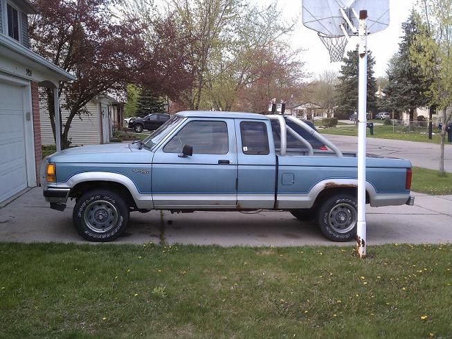

Another 2.9L to 4.0 swap.
I have been reading about so many others 2.9 to 4.0 swaps, so I figured I would start this thread and try to document mine from start to finish.
Build truck: 89' 4X4 Ranger extended cab with ~270k miles. Currently has a 2.9L and Mitsubishi 5spd, Dana 28 TTB front axle and 7.5" rear axle.
Reading through the forums it seems that the only way to do this swap is to get a donor vehicle... so I did.
Donor truck: 93' 4X4 with ~167k miles. Bought it for the 4.0L, Mazda 5spd, Dana35 front axle and 8.8" rear axle.
Stay tuned...
Pictures of the 89' and the 93' Rangers.

I would just drive the donar, looks to nice to part out.
