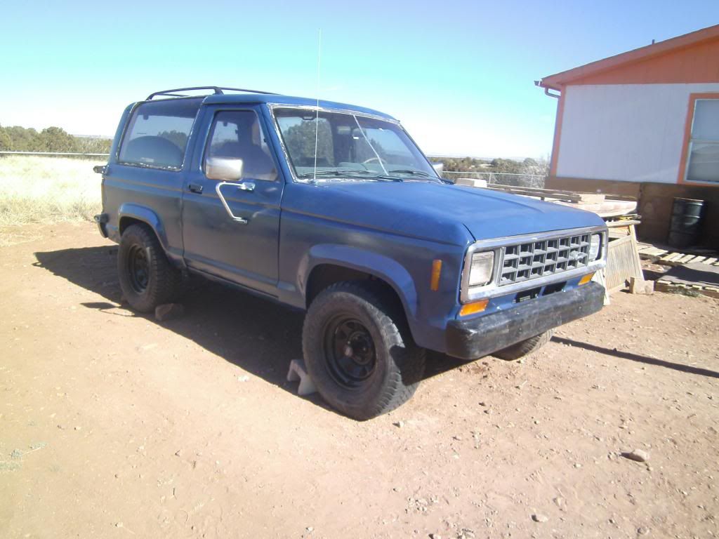

After the blue paint that Bronco looks identical to the 87 I had.

Thanks I really like the blue paint.

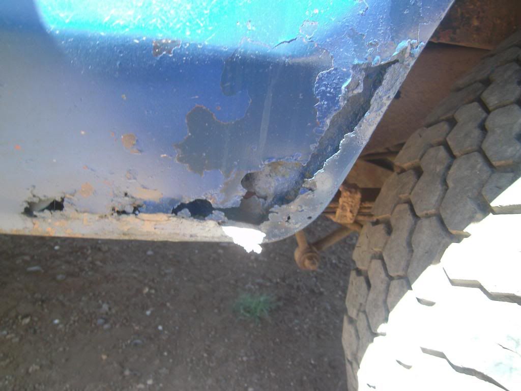

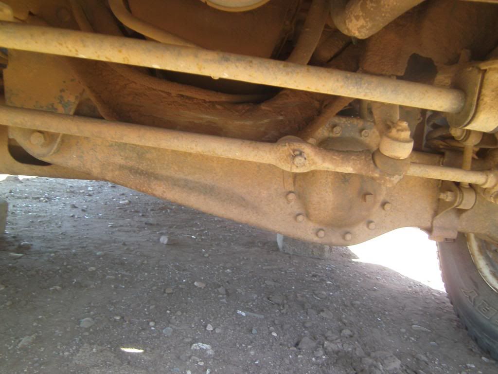

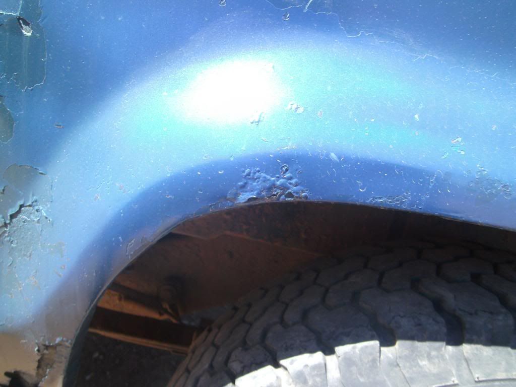

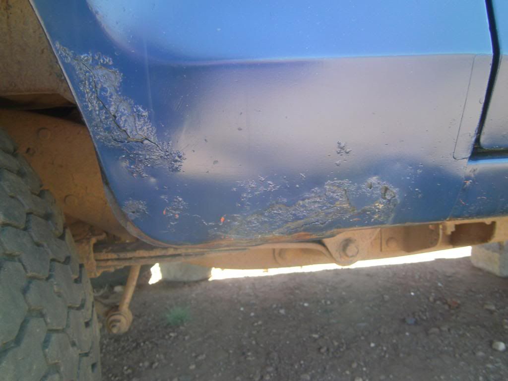

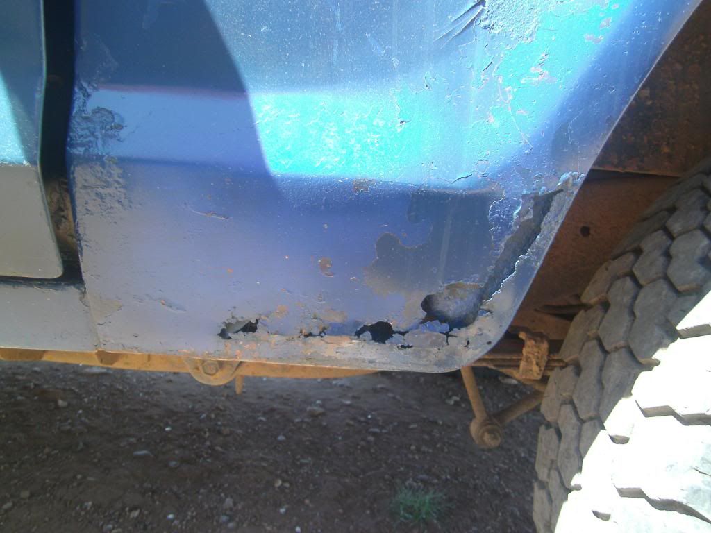

rust free are we looking at the same Bronco 2? LOL
Behind the doors are tons of rust and bondo. I guess that is my fault since I haven't taken a good photo of the rust. I love all the wide open space it makes wheeling some much funner.
The truck has 326K miles on the body and is from back east. The truck was only in AZ for about a year before we got it and was never washed of the salt. It is from Ohio originally. 146 on the engine, trans and t-case. This is the main reason I want to get something different I don't feel like dealing with rust on it even though I know after I do it, it won't rust out again. Hence why I just use it as a beater truck to beat the crap out of.

this is the passenger side obviously not as bad

I stand corrected. From further back, nothing caught my eye. And you told me no watching for rust out there lol :D
I bet the wide open spaces are great. I want to be further out of town, but work keeps me in suburban areas.
Well if the B2 is just for wheeling, might as well pull the front swaybar and rear if it has. My Ranger doesn't have either of them now :icon_thumby:
Ya I know I usually try to hide the rust in my pics. LOL.
