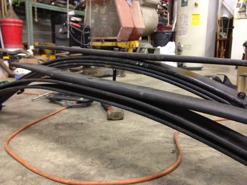

You can always get a set of explorer leaves or ranger leaves and build your own spring packs. Once you remove the springs, you just have to cut the center bolt off or take it off. Then all the springs come apart and you can do what you please. Its very common for people to cut the main eye off of another spring pack and insert in under the main leaf. You should be able to get new axle center bolts online or from the local auto parts store.
You may want to replace the spring eye bushings while you have the springs out.
Here is a good shot of a center bolt...

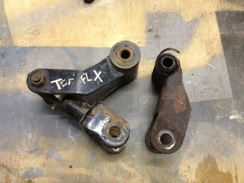

I got a little lift from these Jeep shackles if you want to look down this road. I really like them on mine.

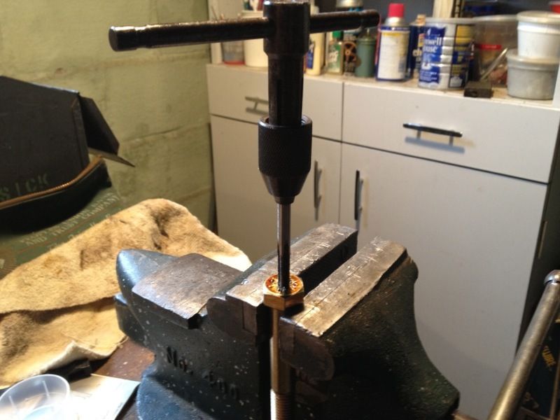

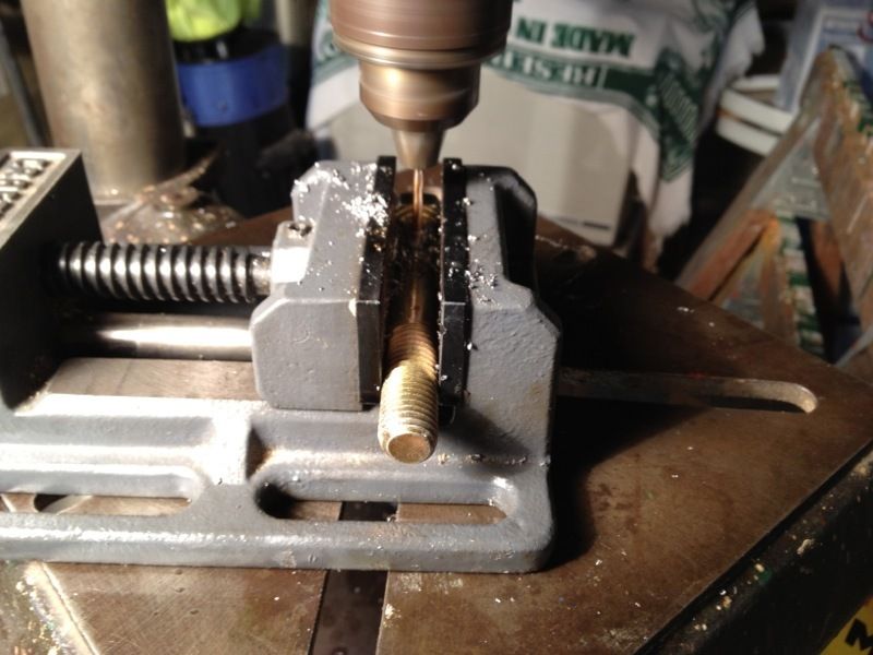

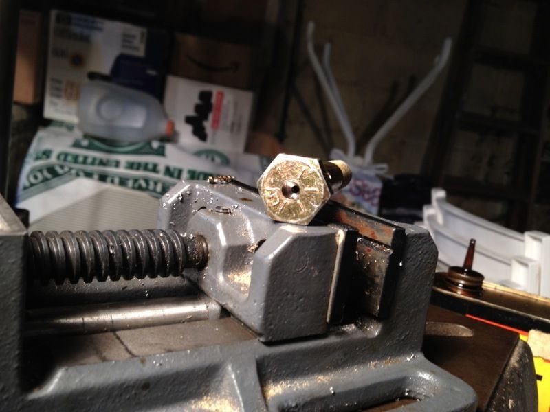

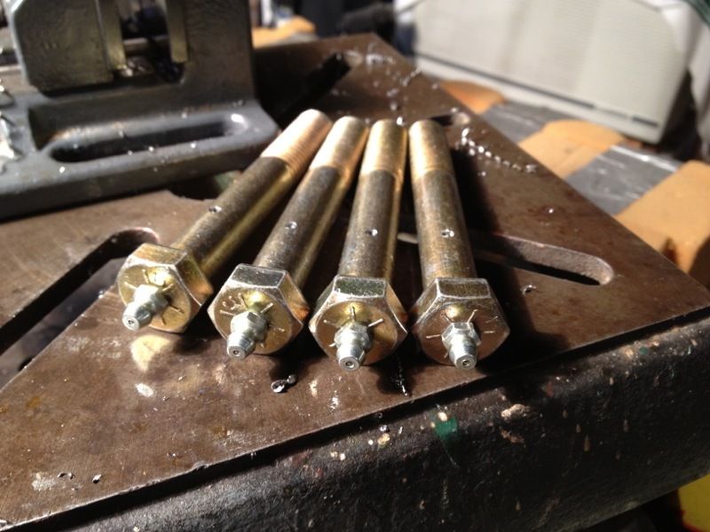

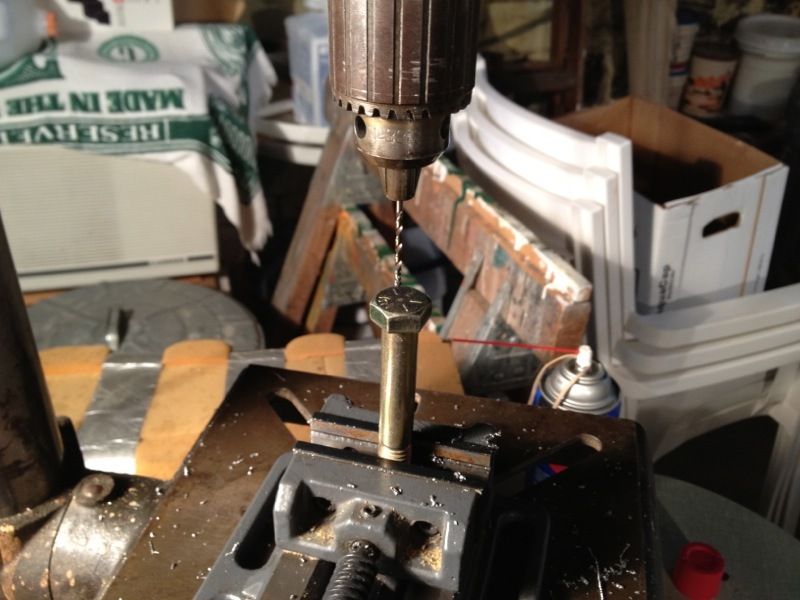

And when I installed mys suspension I had a lot of problems with siezed bolts in bushings.... so I cam up with a solution...
Our 84 Ford Bronco 2 4x4 build thread. From Junk to almost glory.
Fun and relatively inexpensive little project. I used 9/16" x 4 1/2" grade 8 bolts and grease fittings from AllensFasteners.com. They are a great place to buy hardware from because they have the best prices I've ever seen and everything is great quality.

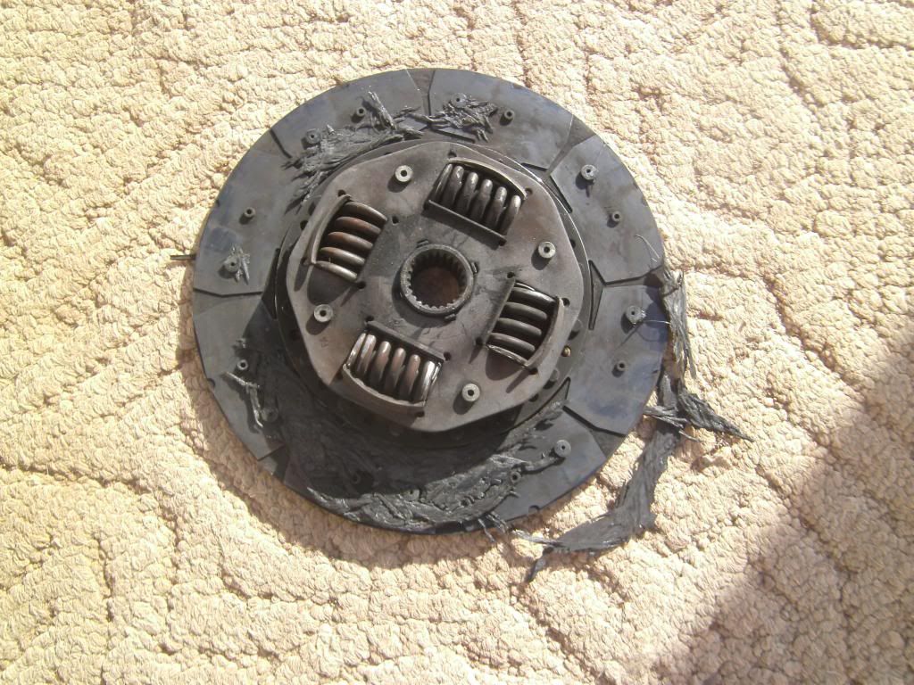

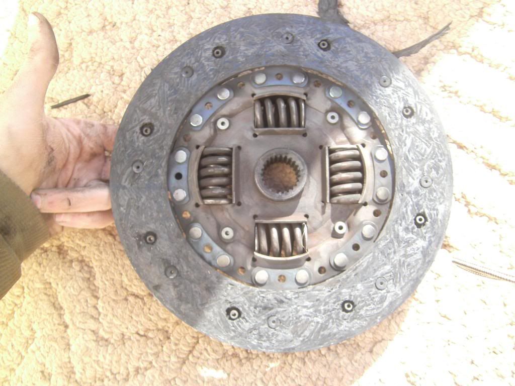

Well yesterday got the transmission out of the Bronco 2. (took a chit load of PB blaster to break loose the bolts on this rusted son of a gun). I would say the clutch is royalled Fed up by me I don't think I am going to be pushing this thing as harsh as I use to push this old girl other wise it may not last the time I am giving it all I have to do now is push the trans into the engine a bit more, put the bell housing bolts back in, put the starter back in, throw the slave cylinder back in, throw speedometer cable back in, and lastly hook up the driveshafts. Pressure plate had slightly bent springs. Clutch was riding on the damn rivets and springs had close to 1/4" of play in them! I personally say if I take decent care of the truck the clutch I threw in will last 20-30K miles I figure by then the bronco 2 will be put down to rest the way I beat the crap out of this truck and the way the truck is going. I think what I am going to do is drive this thing till it dies then when it does park it in the backyard waiting for a good swap to do (4.0L or 5.0L).
Check out these pics this is exactly how the clutch was pulled nothing pulled off of it:
The side that goes in towards the pressure plate I believe:

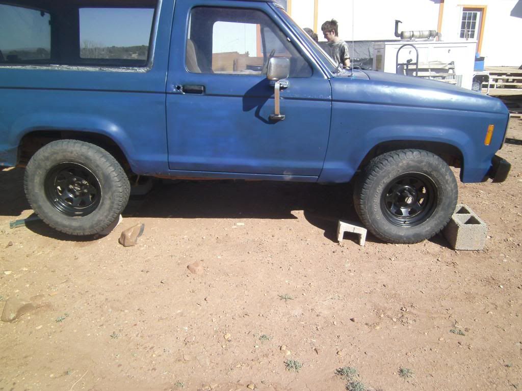

How the Bronco 2 is sitting right now on jackstands waiting to be buttoned up:

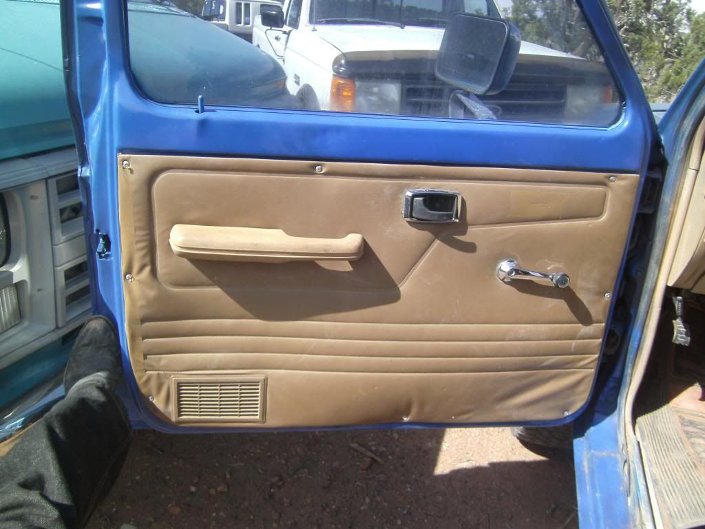

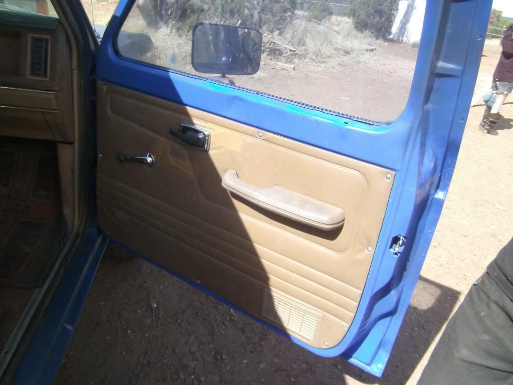

Ok so a few updates. Yesterday went to the junkyard and picked up two tan door panels, the door locks with keys, the locking glove box, and some of the arm rests. Installed all that yesterday but the door lock on the drivers side isn't working right. Not sure what is wrong yet.
We installed the door panels using machining self taping screws. To me it looks nice I just didn't want to deal with the stupid Christmas tree things.

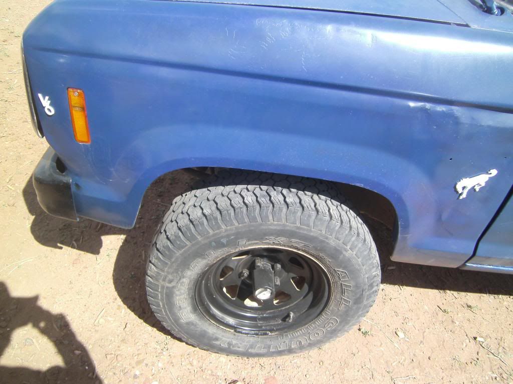

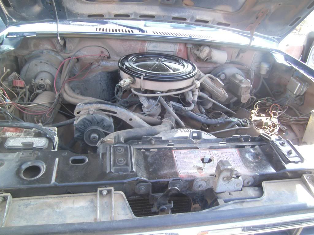

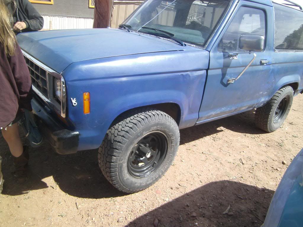

ok so got some pics for y'all. Got the air cleaner lid painted black, the bucking bronco and V6 emblems painted white and all put on. Got to find one more Bronco II emblem and paint it white and put it on then the rest of the emblems are staying off. One day we will paint the air cleaner thing probably when I replace the air cleaner but for now it is staying. I got to get the truck to the local car wash and degrease this damn engine.
Ignore the old door handle I took this pic before replacing it with correct one and yes that is packing tape over the small tears:icon_thumby:
Ignore my damn cowboy boots and the painted locks aren't staying they are going chrome or black:
my dad laughs over this everytime I pop the hood:
V6 emblems mocked up and put on the bronco 2s only have the V6 emblem on the passenger side so I got another as I thought that looked gay:
