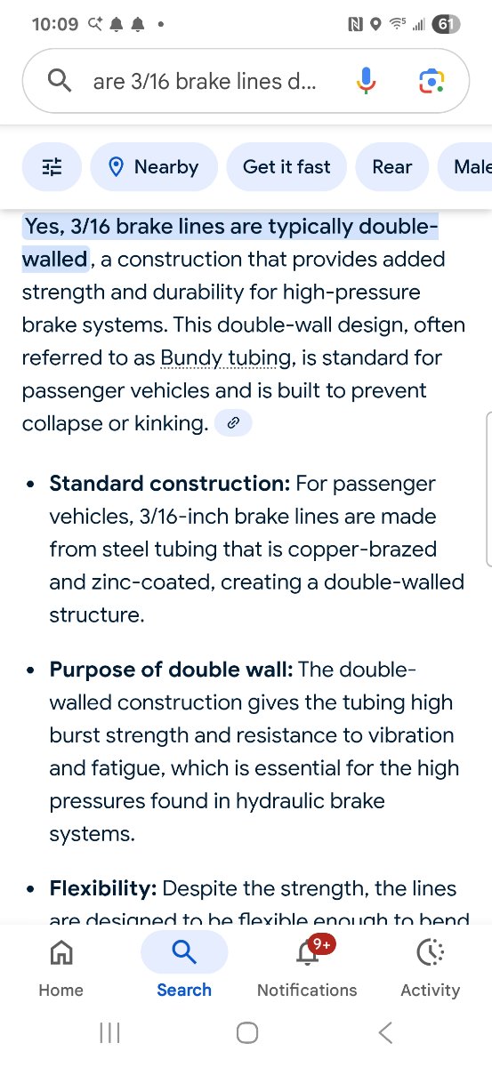

I've never heard of double wall brake line. A double flare for sure is required. And that is what I thought he meant by " double wall "...

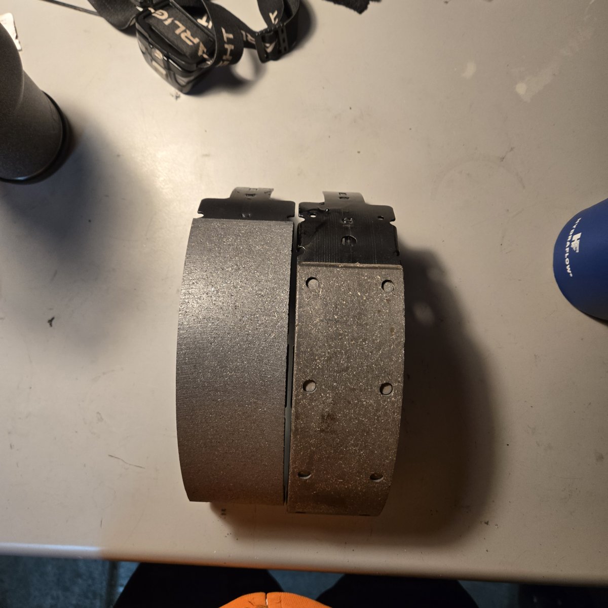

The shoe that has the rivets on the pad is a new one i pulled from the crate o parts. The non rivet one is the one i just got from advanced auto. The old one i pulled off's brake pad position matches the one i bought from advanced auto. The metal frame the pads sit on are the same size on all of them. So i'm not sure if the position of the pad is what is hanging me up. They have the same amount of brake pad, they are just positioned on the metal in different spots.

So... the two shoes you have pictured... it appears you have a secondary shoe (no rivets) and a primary shoe (riveted lining).
The shorter lining is the primary shoe and is put as the forward shoe on the backing plate. Longer lining goes on the rearward side.
FYI... Riveted shoes are typically the heavy duty variety. Rivers are stronger then bonding.

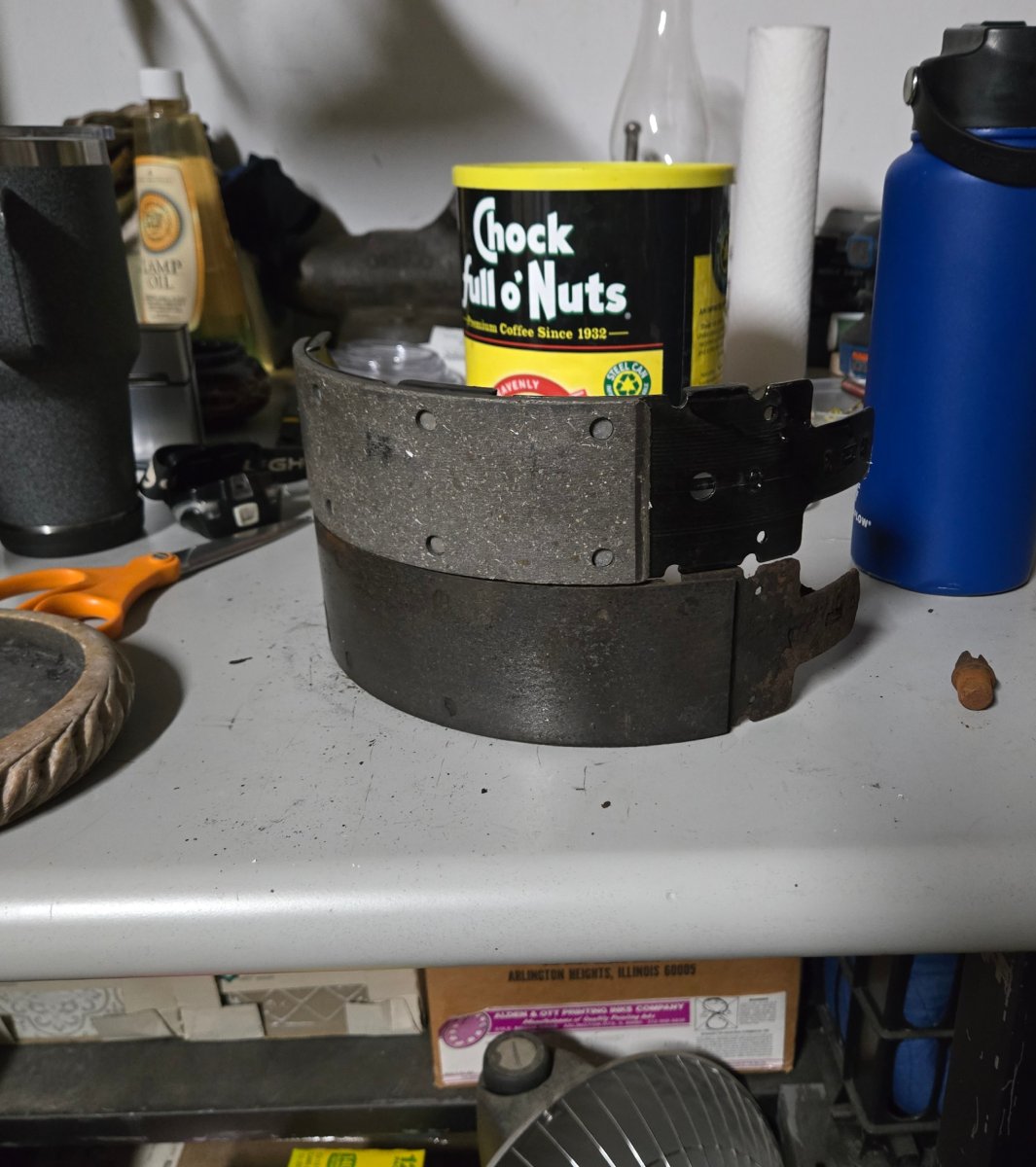

That's the thing, it appears I have different shoe types, but they are both primary shoes (less pad). That shoe on the right with the rivets, it's like they took the pad and slid it further down the steel part. Both shoes in that picture have the same length of pad, they are just in different spots on the metal. I'll try and take some better pictures!
Here is one i have on my phone at the moment. Top Rivet primary shoe from crate o parts. Bottom is primary shoe i just took off my truck. Same length of pads on both.

Honestly... it looks like you had a secondary shoe in the primary position to me.
Do you have a full set of the riveted shoes?
I have a full set of riveted shoes on the truck right now, and a full set of non riveted I just bought to compare.

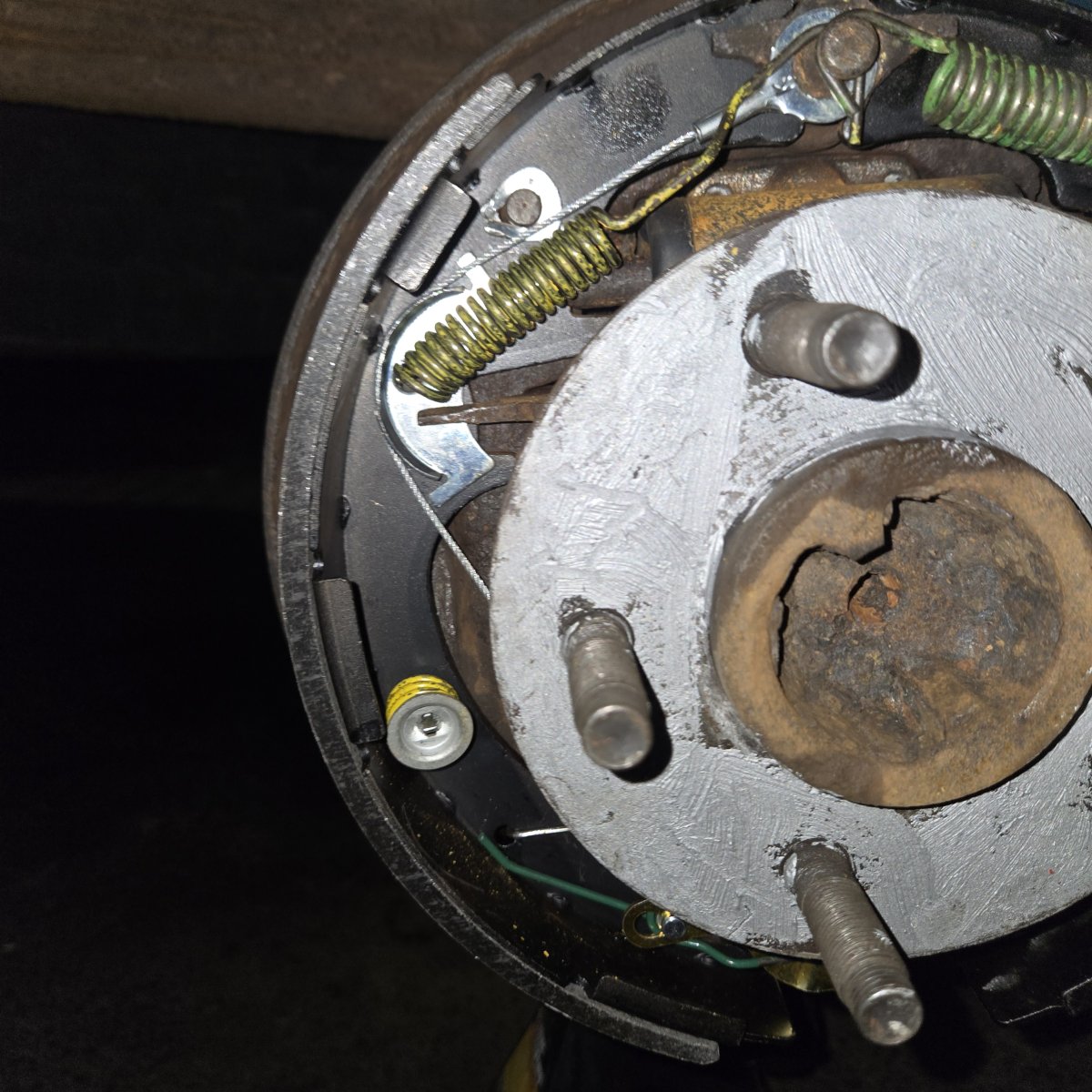

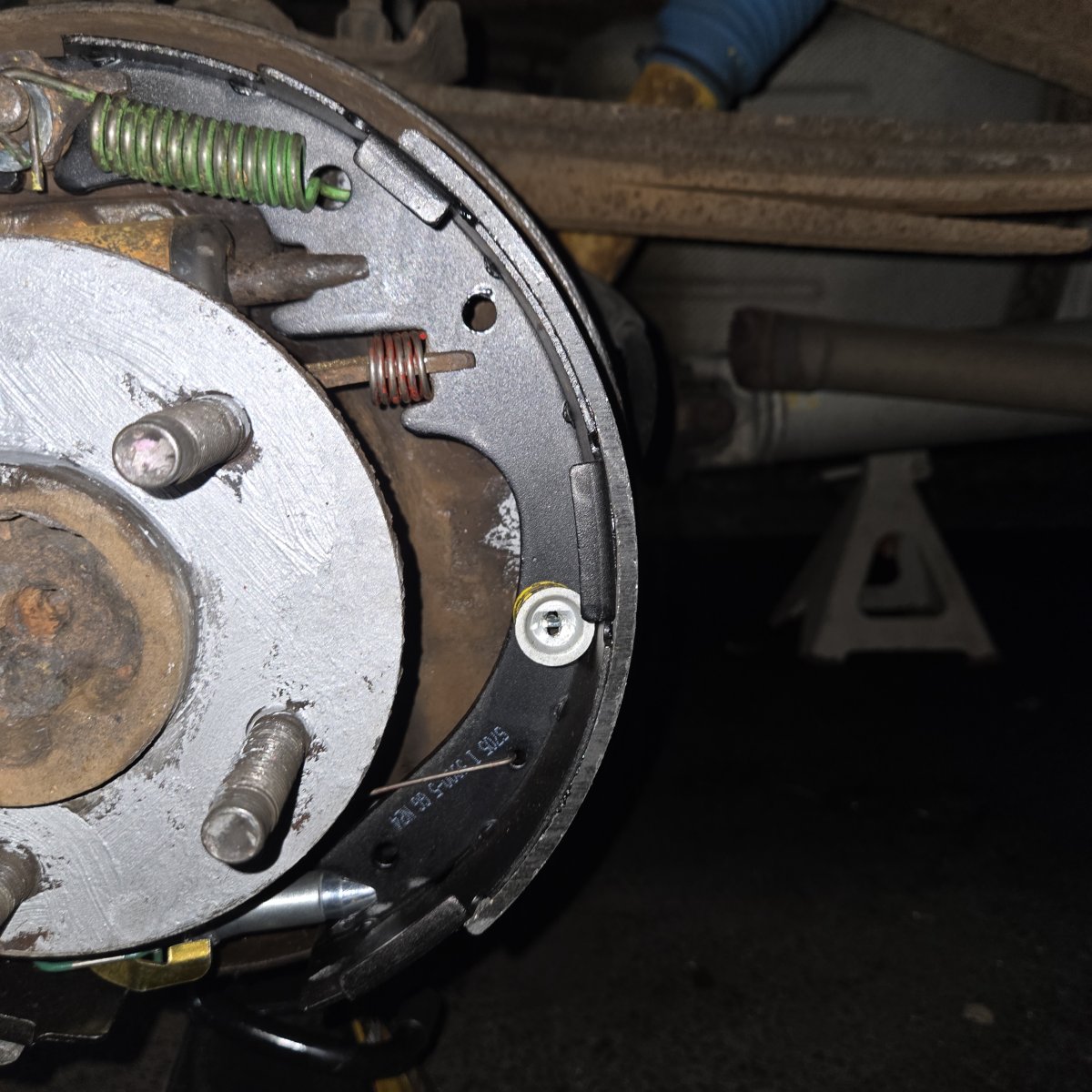

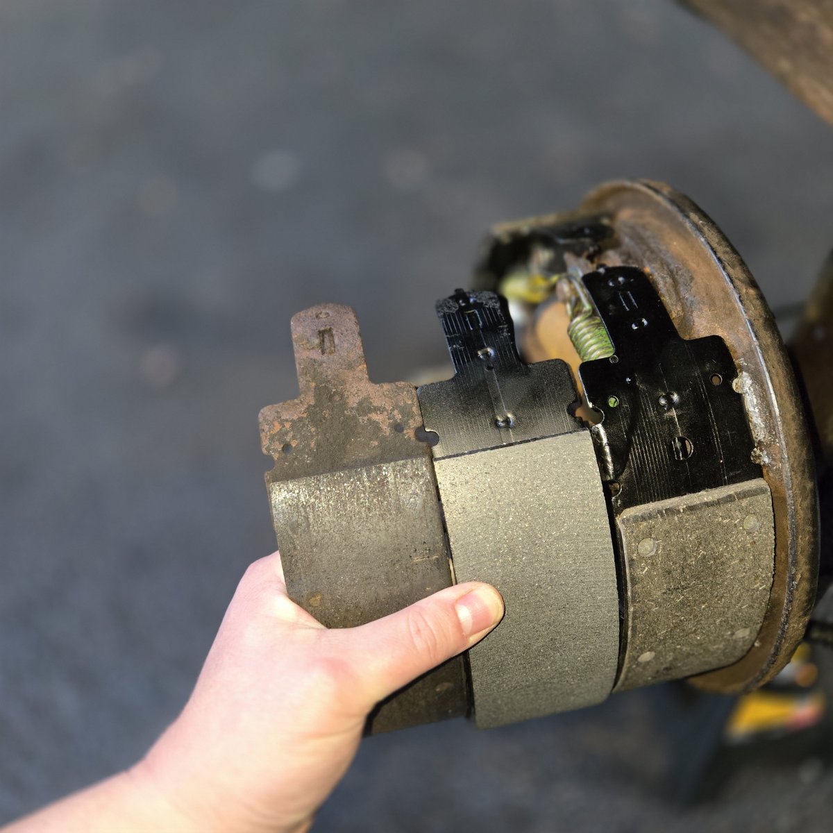

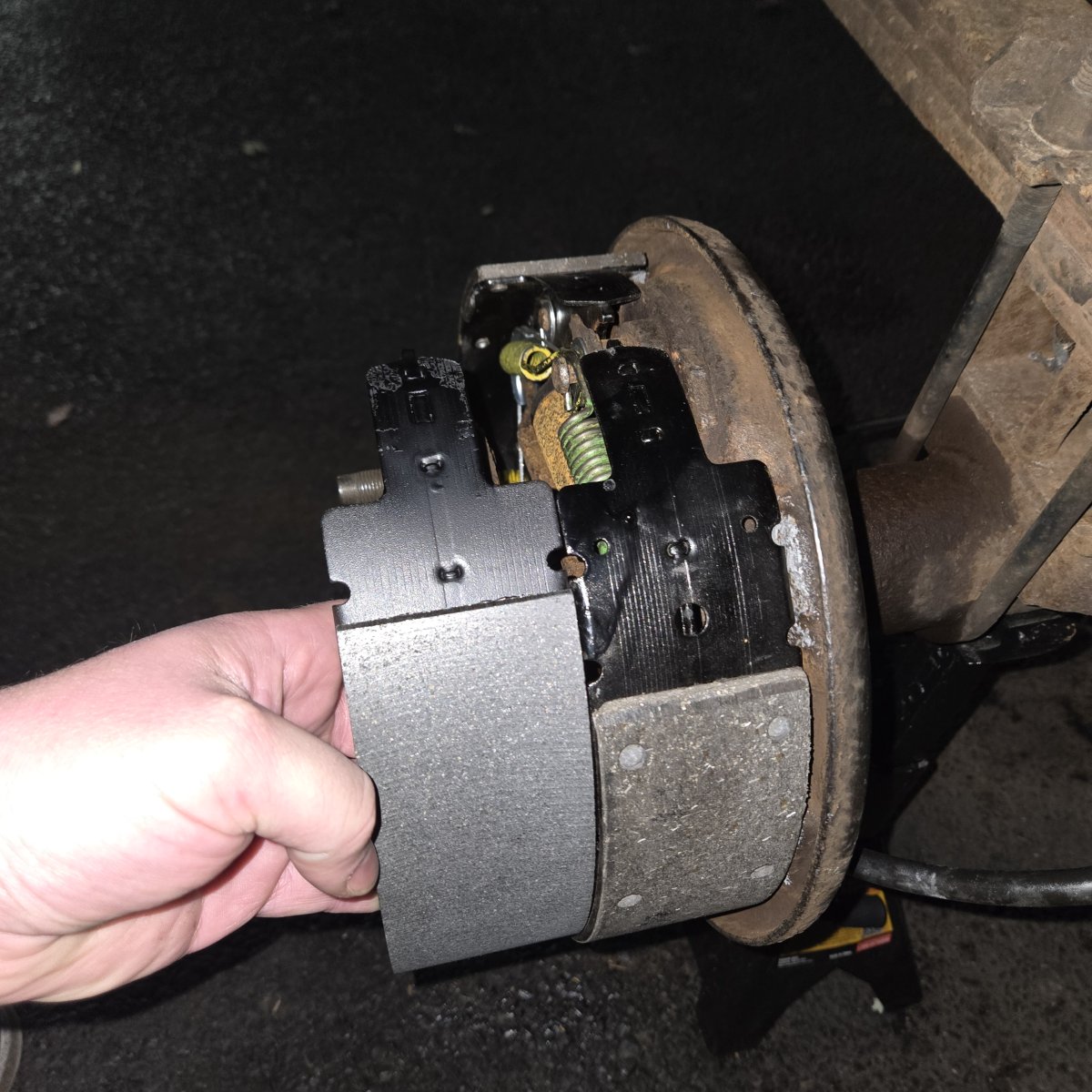

Here are some better pictures. This is the passenger side. Pic 1, I'm holding the primary shoe i just bought from advanced auto next to the primary on the truck that came in the crate of parts. I haven't even taken the advanced auto secondary shoes fully out of the plastic wrap yet.

In this one I'm holding the Old pads(left), AA i just bought (center), crate brakes(right). All primary, all roughly 8.5" of pad length vs 10" of pad length on the secondary. It's like the ones on my truck when they put the pads on the steel part they accidentally put it down 2" lower than they should have.

Quality isn’t what it used to be…
This picture clearly shows the secondary shoe held off the anchor pin.

Those riveted shoes look proper to me. Likely just a better quality set of shoes. I'd take the other set back.
The wavy washer on the park brake lever pin should go on before the pin goes through the shoe. Ensure the horse shoe clip is in the groove before squeezing it down. It just doesn't look correct to me as it is.
When I think of double wall I picture chimney tubing. An outer skin surrounding an inner skin. What @Uncle Gump describes is not what I would call double wall. But I'm not an expert or deal with tubing a lot either.
Yeah you're right, barely looks like it's coming through. Whoever did these brakes last time had them right behind the horse shoe clip. I'll correct that tomorrow and see if anything gives, thanks for taking a look. The other thing i thought to check was the self adjuster. That also came in the crate o parts along with the springs and shoes. I have the old one but that sucker is rusted open, I've had it soaking in penetrating oil. I'll hit it with the torch and see if I can't get it moving again.

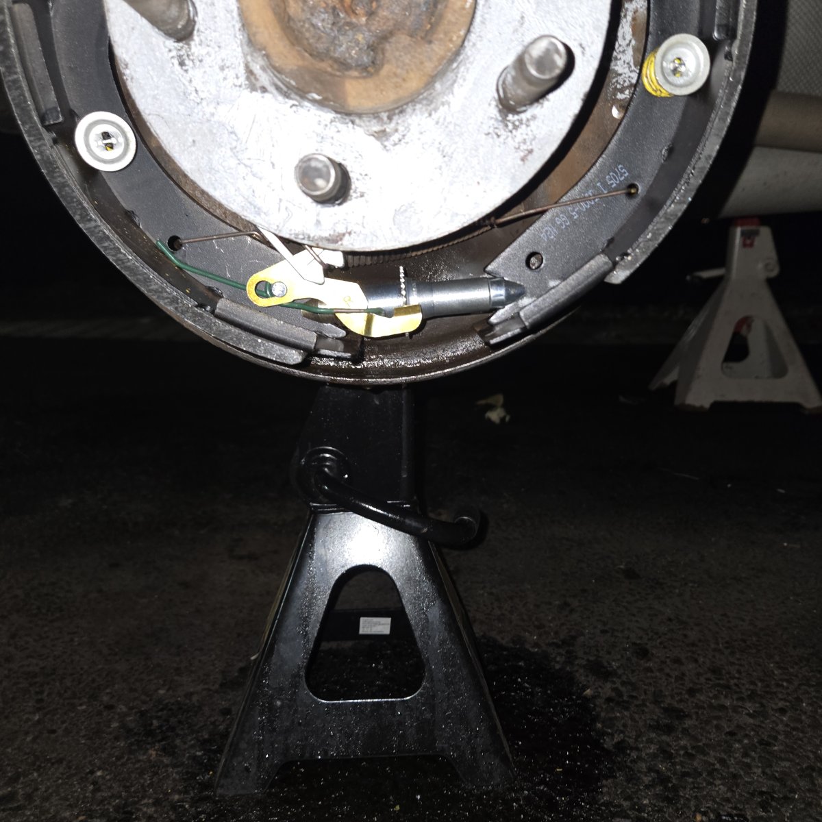

No drums on yet.
I tried to put the washer over the pin before putting the pin through the shoe and it wasn't letting enough pin through for the clip so i ditched the washer.
Torched up the old wheel adjuster and got it all screwed down/closed up. The new adjuster is only about a 1/16th of an inch longer than the old one. I don't believe thats enough variation in part size to be the issue.
For funzies i tried out the new pads i just bought from Advanced Auto, same issue.
Cleaned up the wheel cylinder pins better as well as the bar that rests up against the e brake thing.

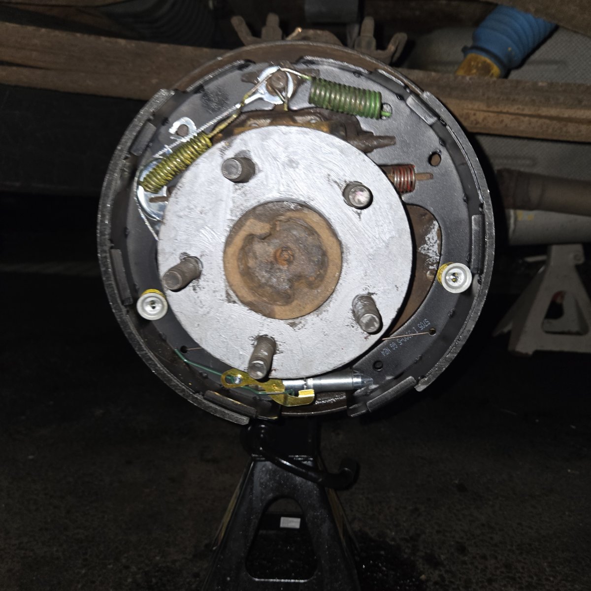

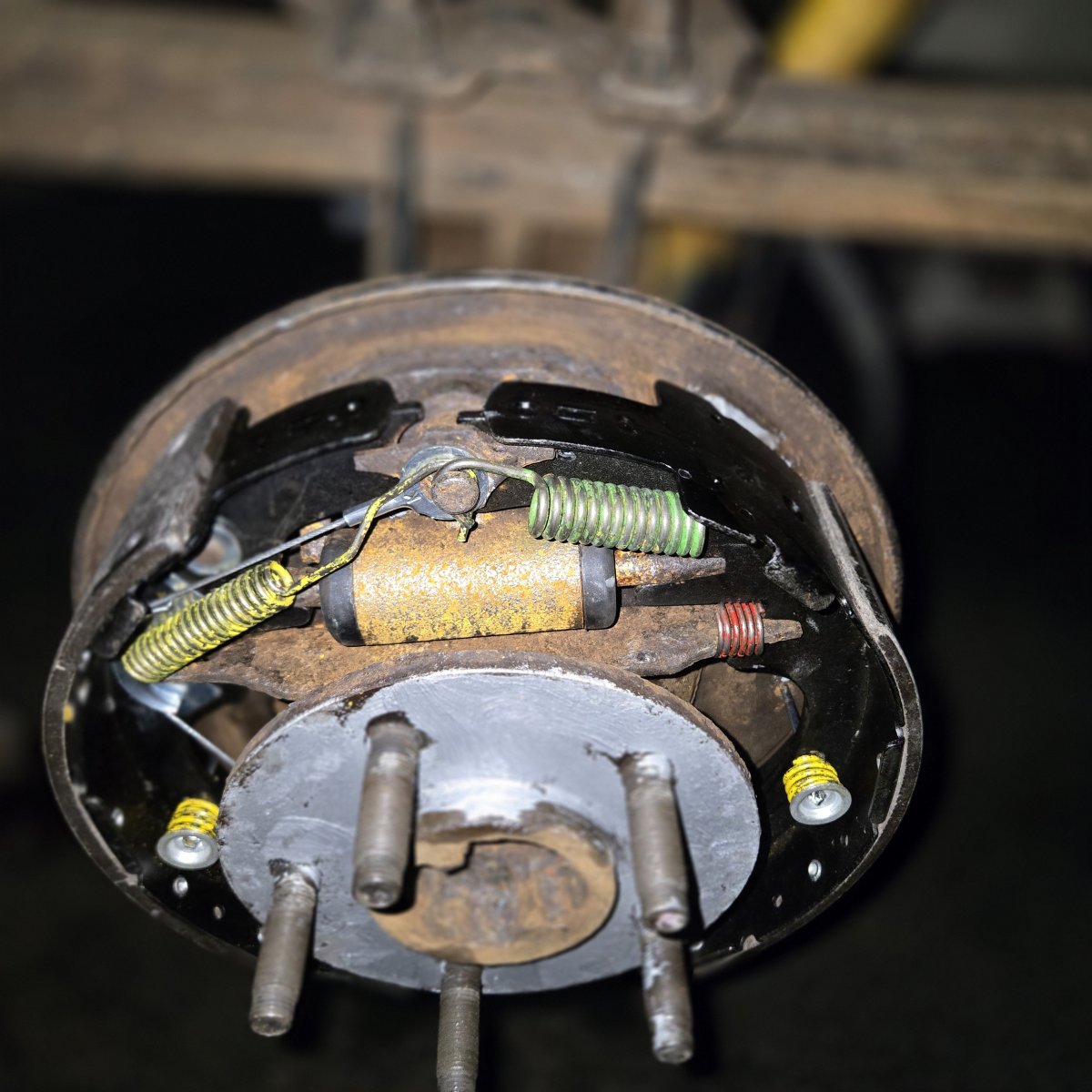

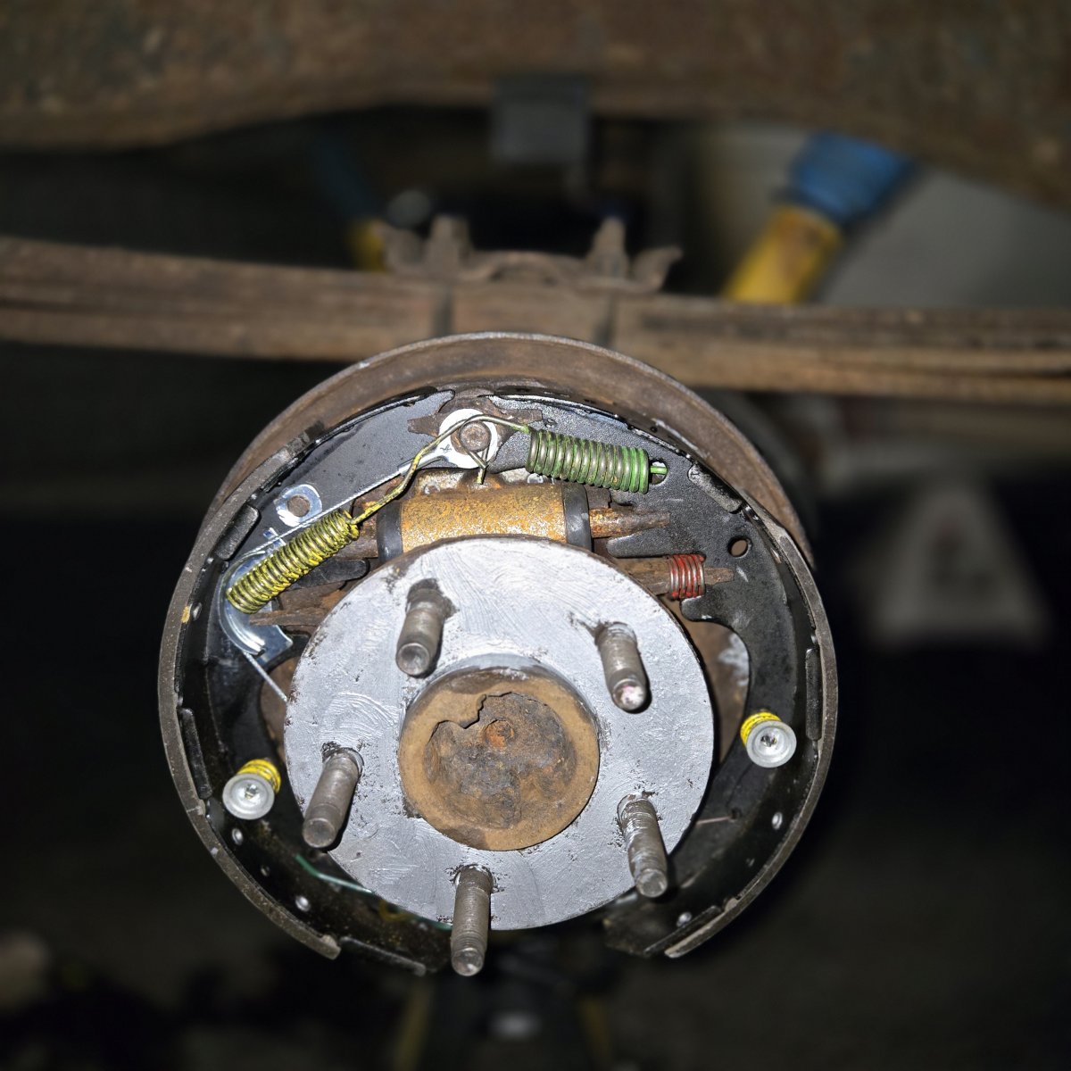

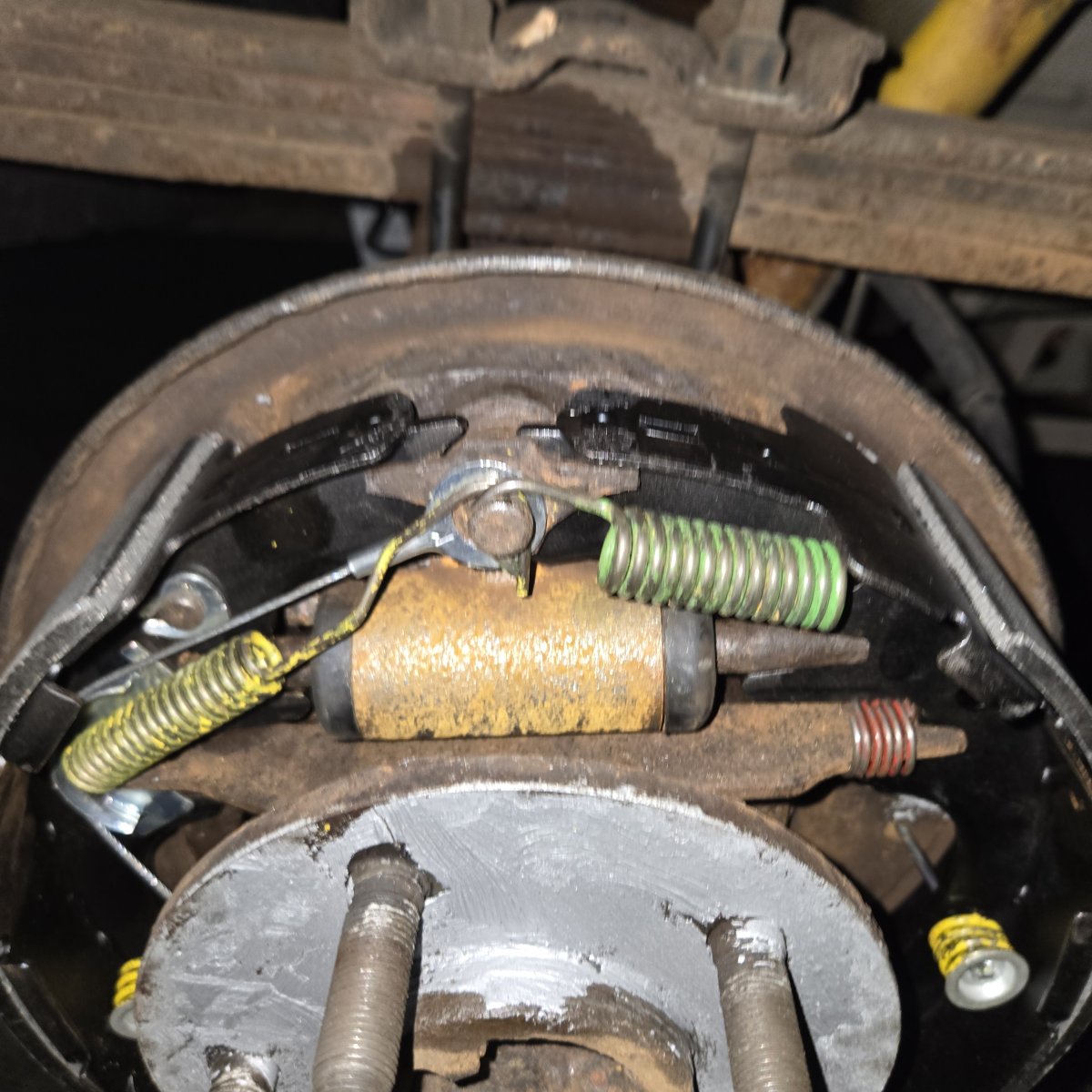

Went real slow putting it back together. The shoes are in the right spot until i connect those top two springs. Then it kicks the primary shoe over to the right and out of position. If i push it back into position it knocks the secondary shoe out of position. I had the bleeder valve off the cylinder to make sure the pins were going all the way in. I can't get both sides on their contact points. I feel like this wheel adjuster or the e brake bar is the issue. Thanks for taking a look.

Setup looks to be correct.
I wanna say I had the same problem until I put the retaining pins in. Is there still tension on those? (That's the ones that stick thru the back at roughly 4 and 7 o'clock.) I also remember having a hard time bumping everything to center to get the drum over it...
