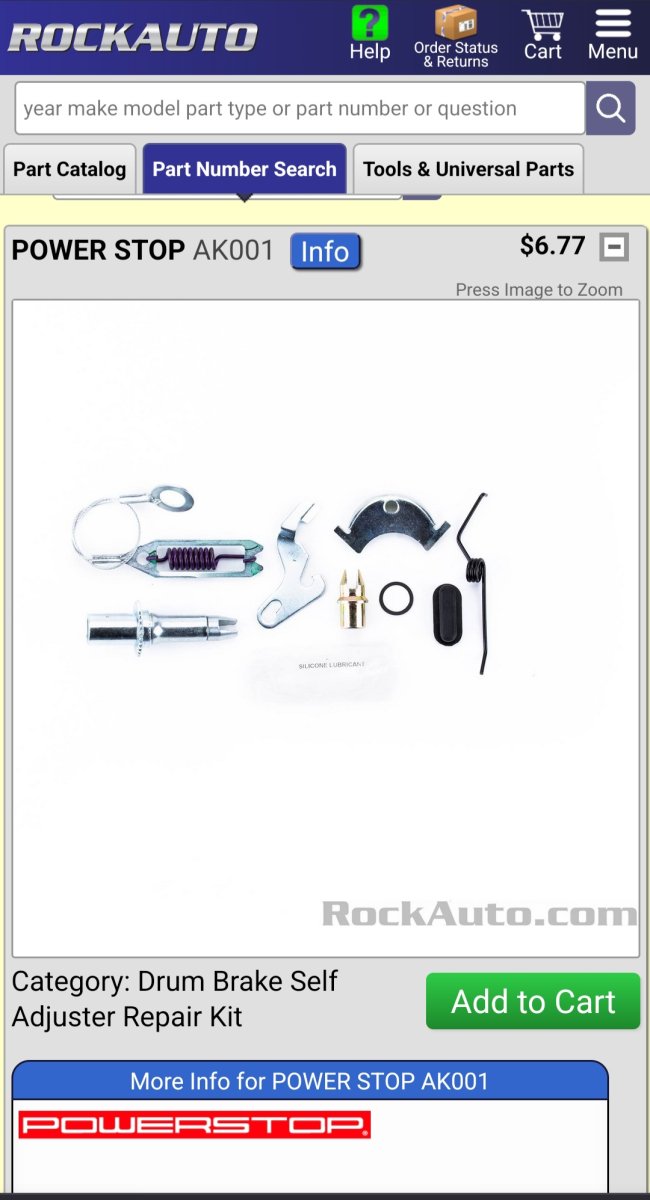

I really only have 1 more part I can throw at it, and that is the adjuster wheel. So I think today I'll try it with the old one. I found the bag for
the adjuster kit that came in the crate of parts the seller included. I went onto rock auto and did not find this particular kit listed in my trucks section, maybe thats something?
