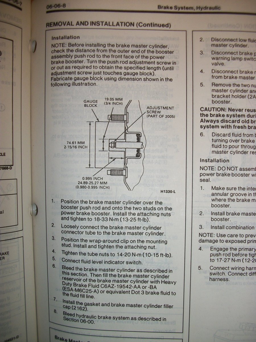

There is a spec for the booster push rod, and a dealership procedure for checking and setting it. From the '94 shop manual:

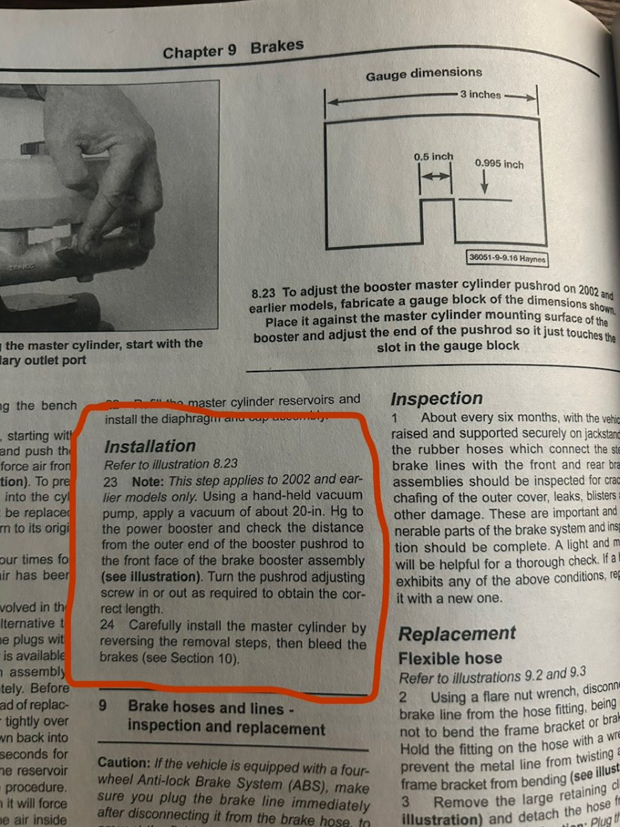

Okay so yes, admittedly I did not check the length according to the manual, due to the old booster not giving me problems until performing the aforementioned maintenance. I used my (calibrated) eyecrometer and a tape measure to check that both were the same before installing. Since I would be remiss not to know for absolute certain, I will make a gauge block and check it. My haynes manual says to apply 20 in hg of vac to the booster, yours does not. Which is correct?

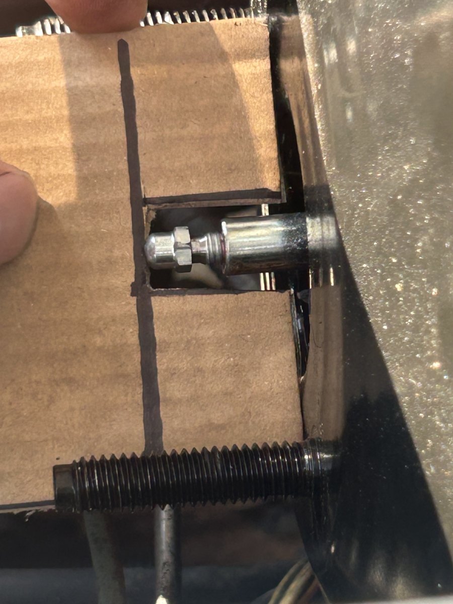

I used CAD (cardboard aided design) to make the gauge block according to the dimensions in the manual. Making no adjustments, it seems the booster arm is at the correct length.
