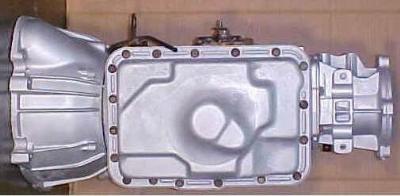

according to the tech section the PO. replaced the tranny with a 4R44E or 4R55E id'd by the pit in the pan......

The trans you listed is a computer controlled trans, are you sure that is the trans in your vehicle? It would need something to control it for it to work correctly. '95, they went full electronic and it wouldn't work with your current engine management system.
i based it on the pit in the pan.... (i will upload a pic of it when i find the micro chip for my phone) do you think its possible that when the PO. took it to amco that they put a new oil pan on?
