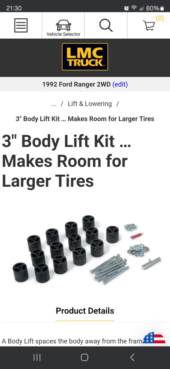

hello all! I am currently in the process of a 302 swap in my 1992 Ranger XLT. After some measuring it has come to my attention that a body lift of at least 2 inches but preferably 3 inches is necessary to clear the carburetor of the hood. the reason I am here to day is to ask if anyone has had any luck finding a complete kit that isn't breaking the bank the only ones I can find are at leat $500. any help is appreciated. thanks in advance. :)

You could try LMC Truck

pa833 | 3in Body Lift Kit | 1989-1992 Ford Ranger
Not sure what that does about bumpers, I had to make my own bracket for the front but my first gen is totally different than your second gen.
I used the steering extension, shifter extensions will vary... you can adjust for that with your swap.
The steering extension is weird. It just makes the shaft longer, it doesn’t do anything to correct the angle change from the lift, I couldn’t use it with my 2 inch. PA body lift.
Does anyone know the dimensions of the steering extender? It seems simple I'm thinking I could make one on my lathe.
