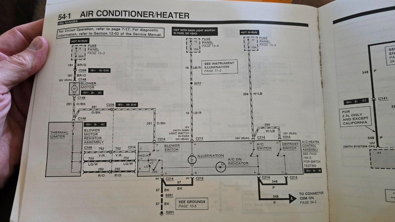

Here is the diagram for the blower section of that system

Yes ive seen part of the schematic and it seems that everything works except for the brwn/org wire. I have to charge the battery because obviously some power was going somewhere and it died overnight even with the ignition off. I probably should've run it after I troubleshot yesterday. While I do that I'm going to try and pull the crimp off. I dont like those things either and I'll fix up something a lot nicer to replace it. The cores themselves look alright. The wire was stripped way back to place the crimp on so theres actually a lot of exposed core. It could still be broken though.

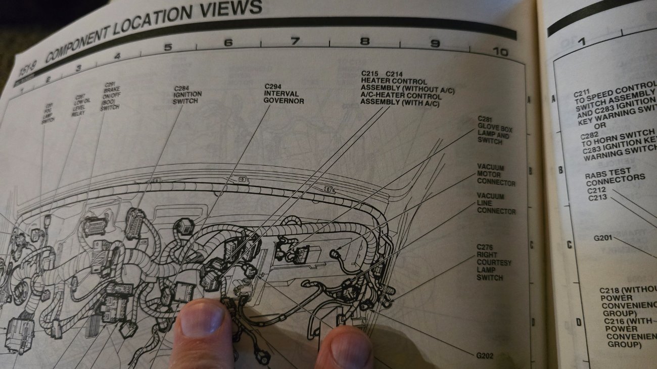

New question: Is there any diagram of where the wires go in physical space?

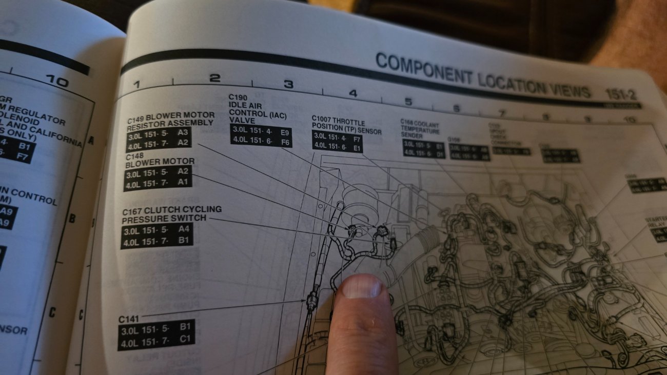

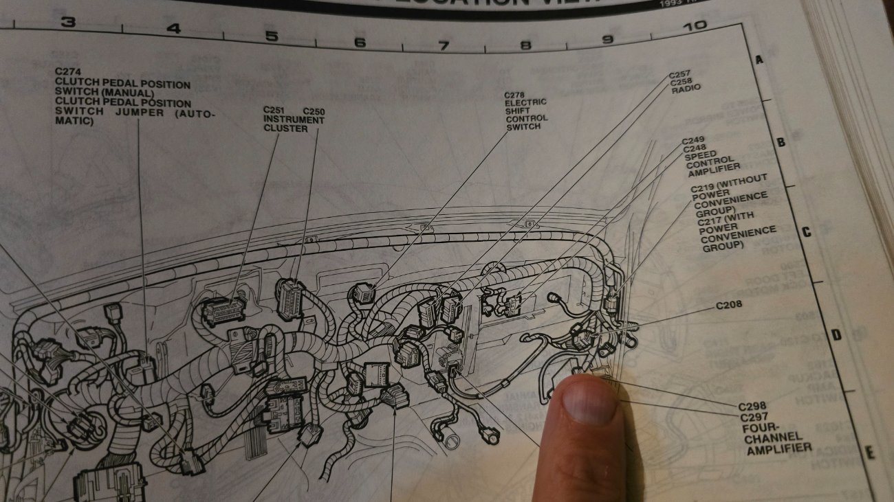

Yes. 3 pages. But, basically, those wires go through a grommet in the firewall right below the blower. There, they hit connector 208. That harness then travels above/behind the glovebox and winds its way over to the heat/AC control panel.
engine compartment view.

Pointing to connector 208 to the right of the glovebox, maybe behind the kick panel

Left finger pointing toward heat/AC control panel area. Right finger pointing at connector 208
