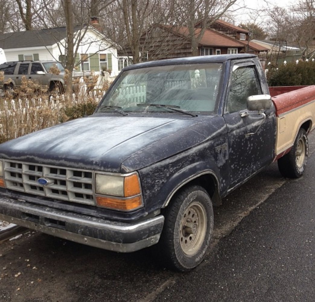

1990 ranger shortbed 2wd 2.3 5 speed. Got off my uncle for 500 and drove it 700 miles home :headbang:

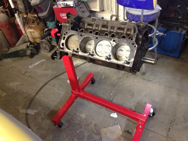

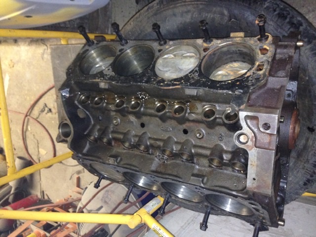

Drivetrain is a 93 mustang ho 5.0 that's been rebuilt. Worked aluminum svo heads. Roller e303 cam. 96 f150 4.9 5-speed. 97 explorer 8.8 3:73 rear
So still gather parts and pics. But here's the truck how I bought it

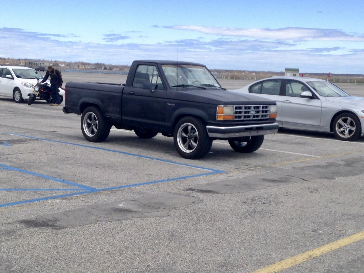

Primed and slapped some mustang wheels on it.
41972
in for the build, I like those new rims!

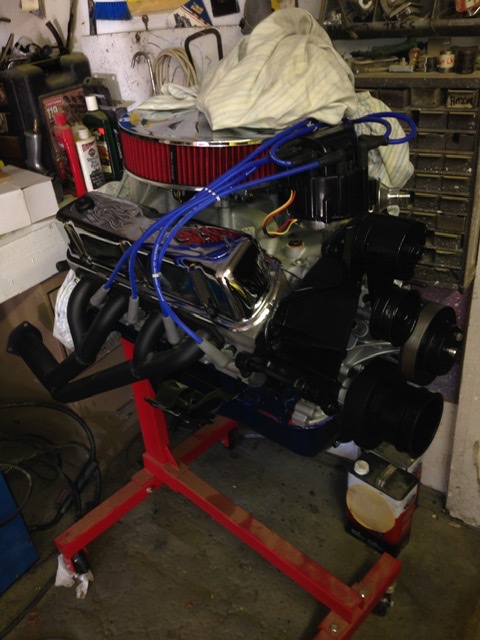

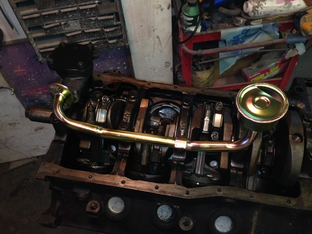

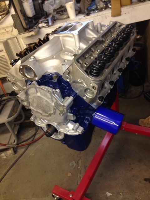

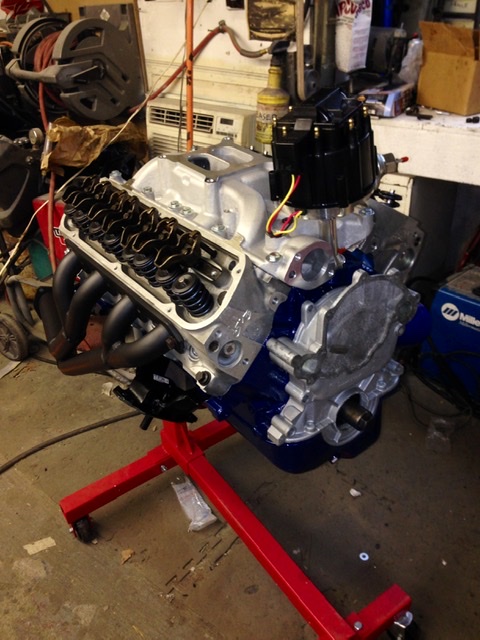

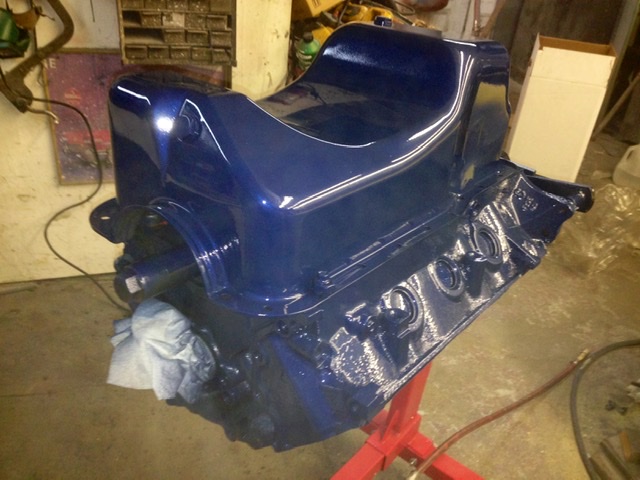

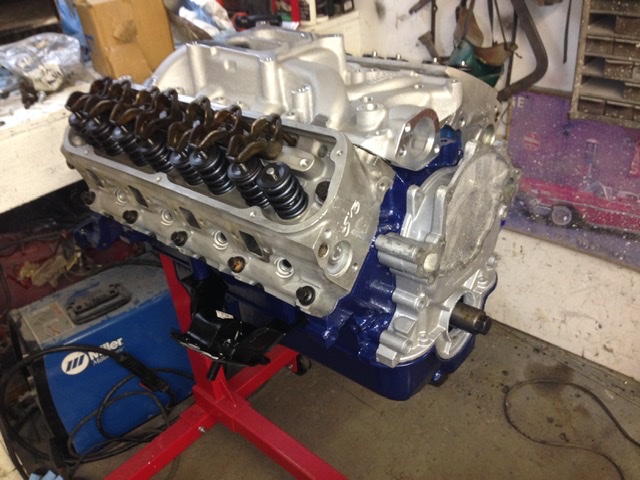

Engine is still being assembled. Waiting on my engine bolts, timing set, 1.7 rockers, carb, and little odds and ends but she's coming along. Cam is a tfs stage 1. Summit stage 1 intake. Holley 600 cfm carb. Have vert mounts on it. Hei distributer. Tri y headers. Luk gold clutch set. And mating it to a 96 f150 m5r2 trans. (yes I know I need an oil filter adaptor lol)

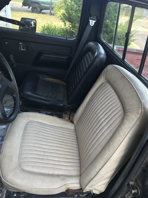

The seats going in
