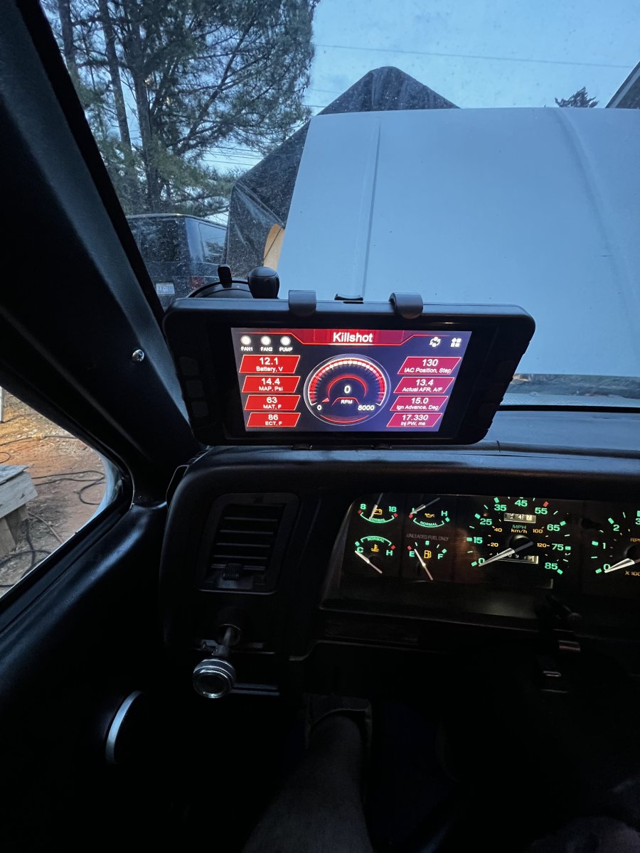

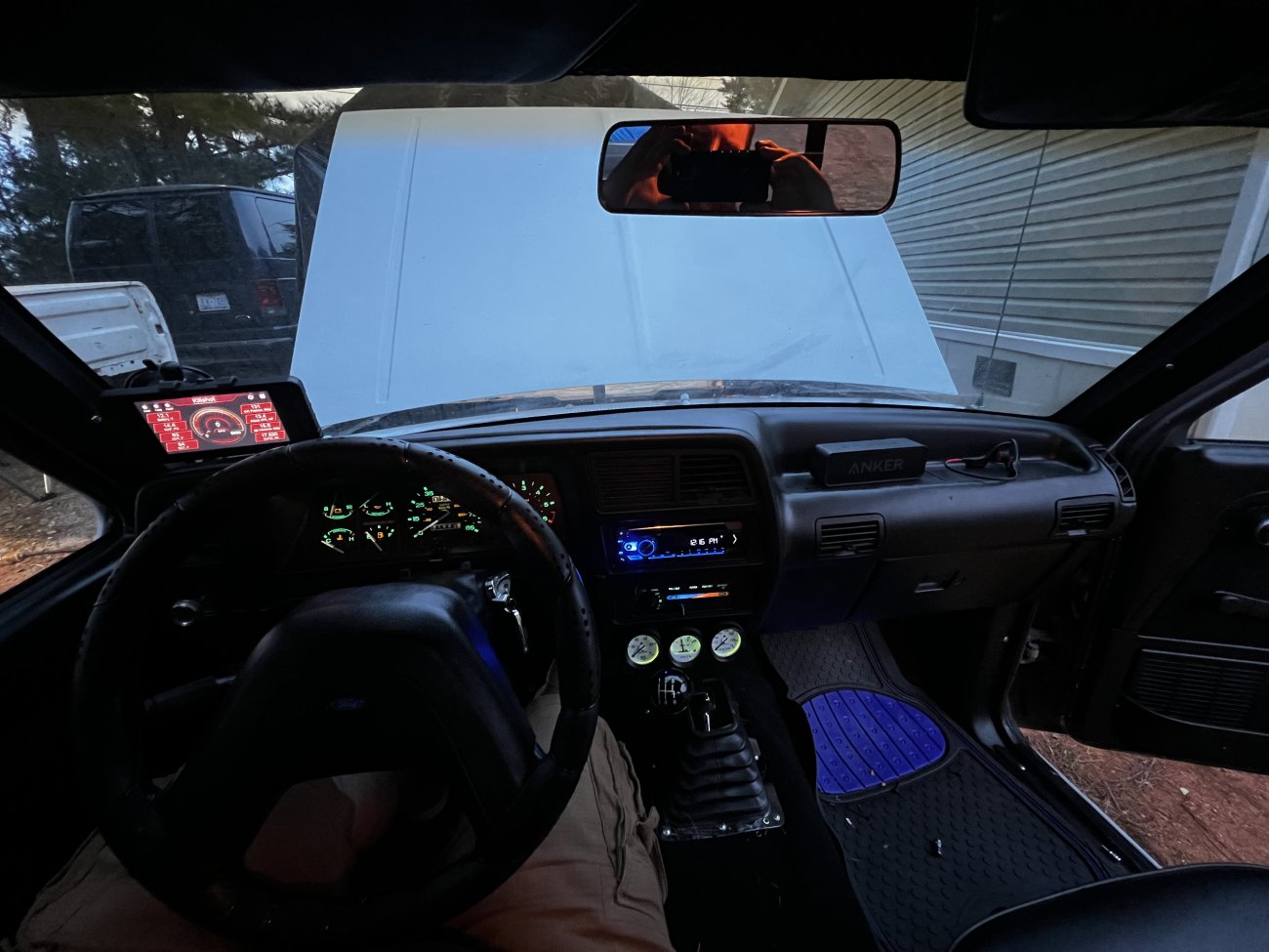

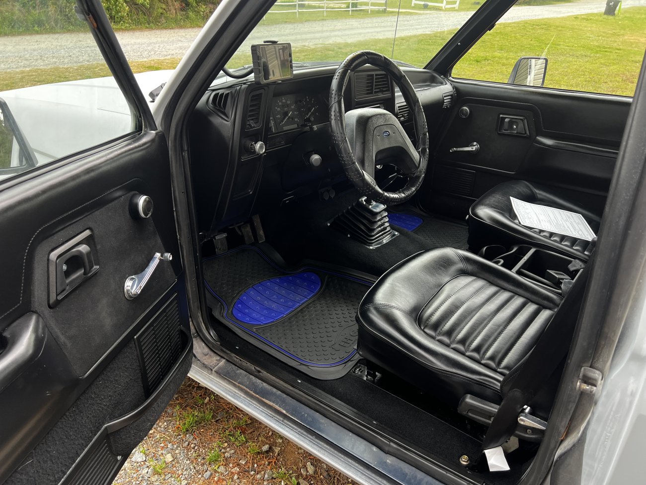

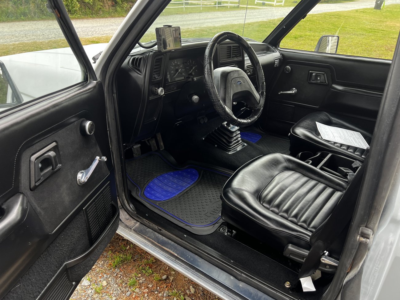

Interior is finally finished. Auto meter gauges all wired up and mounted. And the handheld for the aces kill shot is mounted.

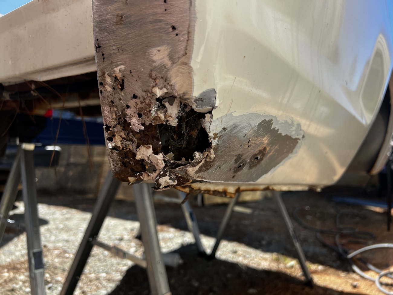

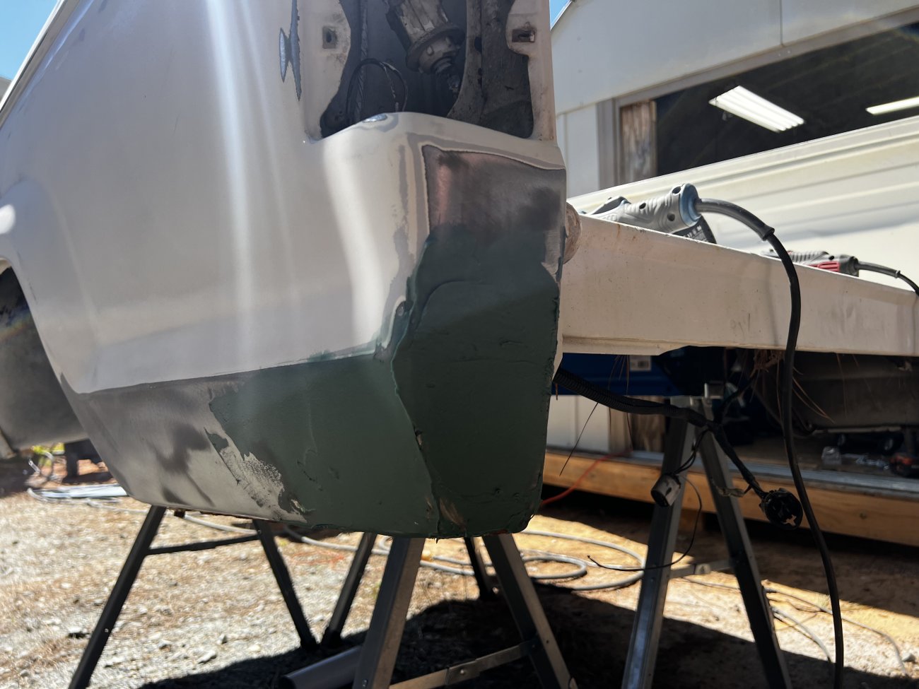

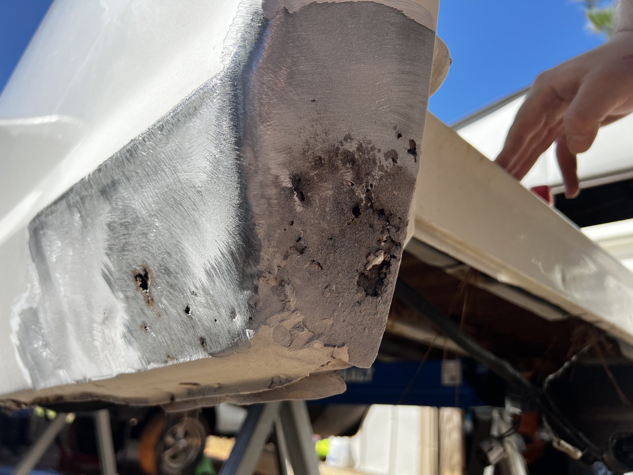

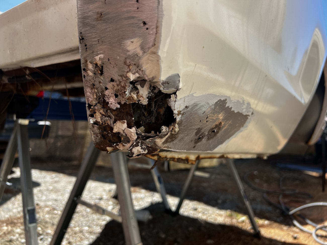

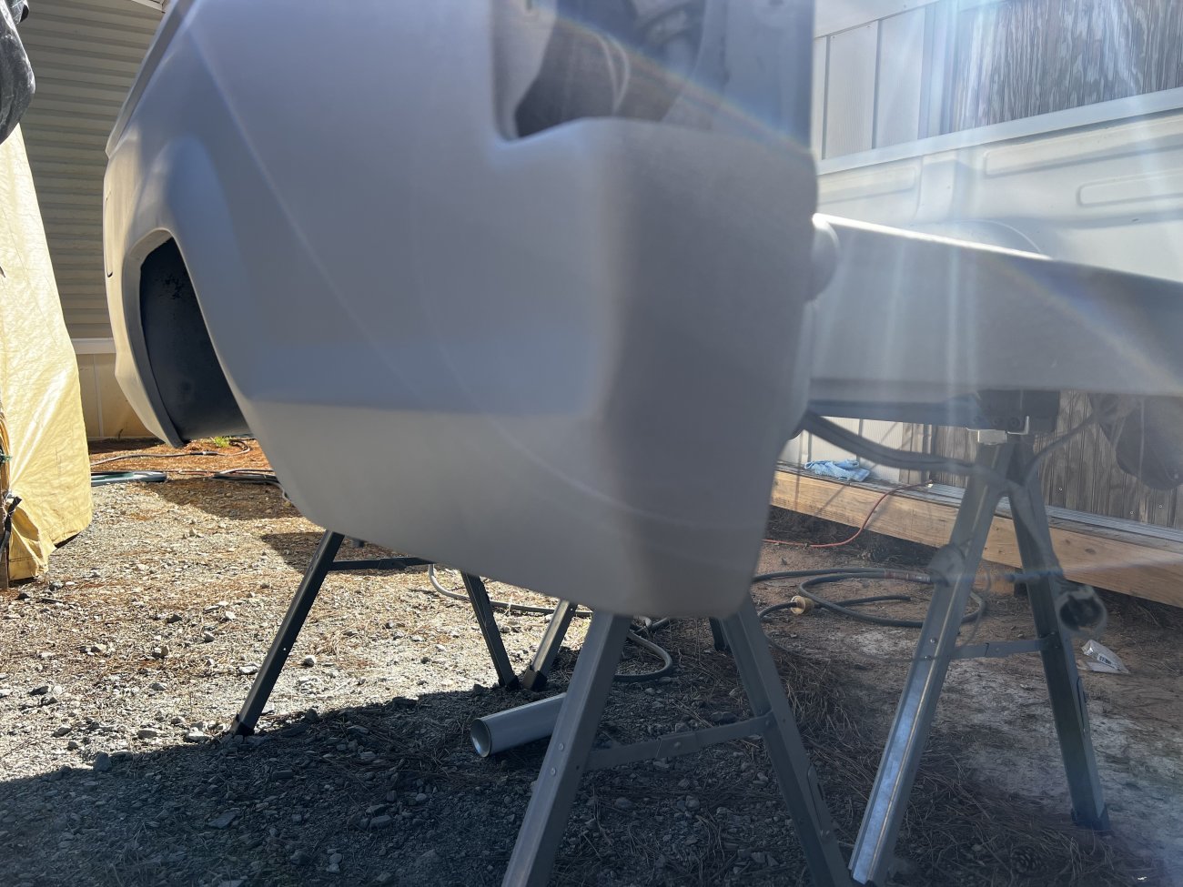

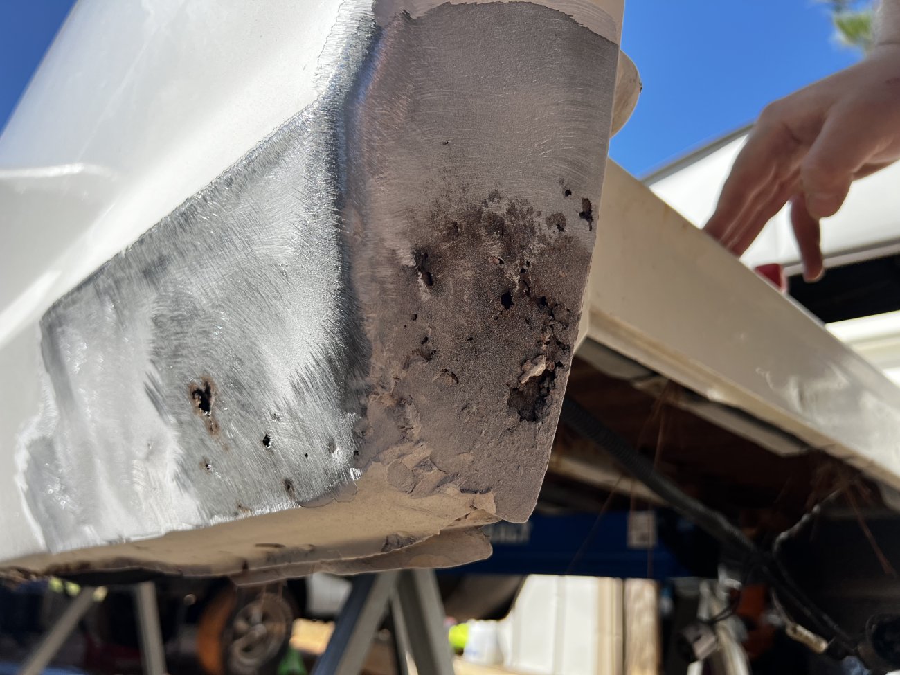

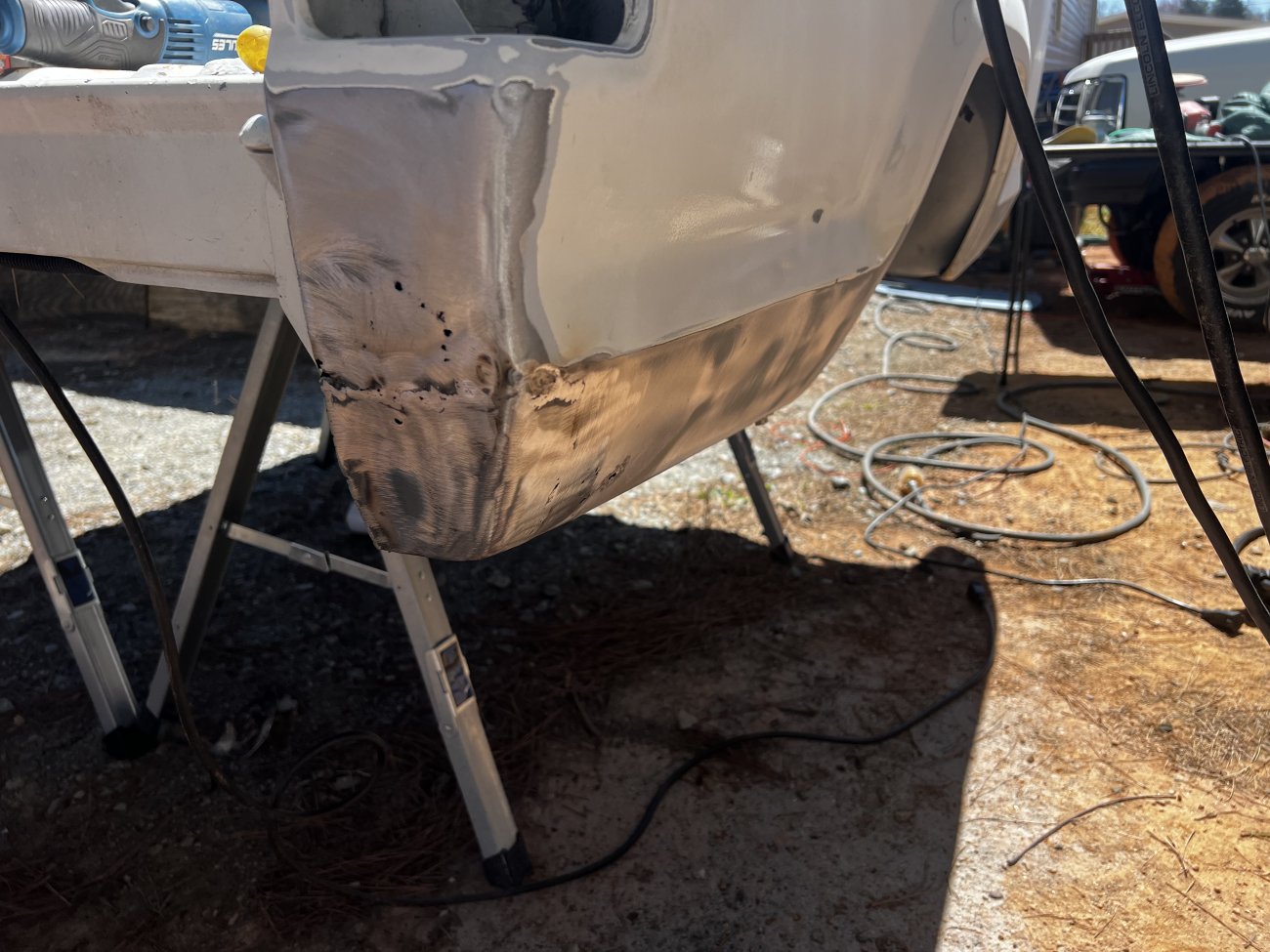

Body work on the bed has started. I knew it had some bubbling on the back corners. I wasn’t expecting rust holes filled with bondo. Oh well
  • Blackwidow reborn
  • Blackwidow reborn

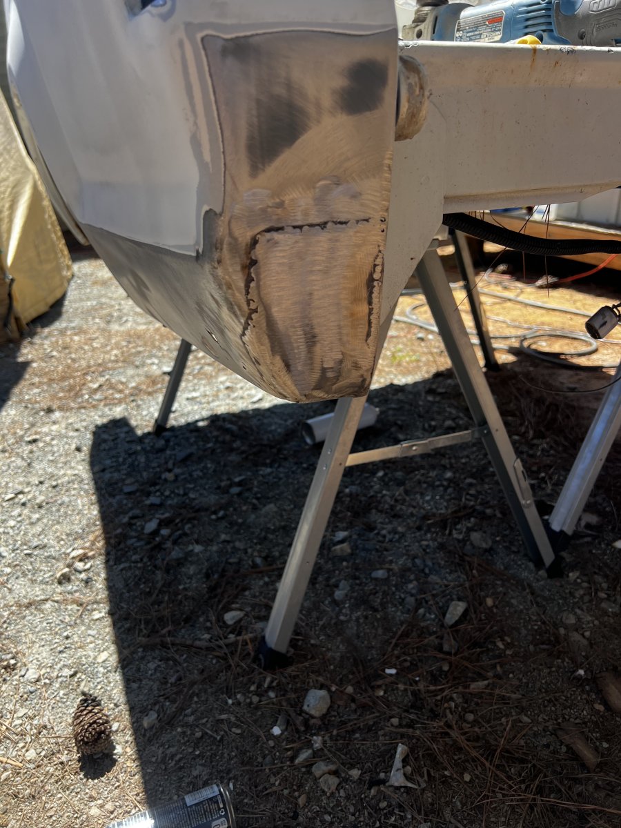

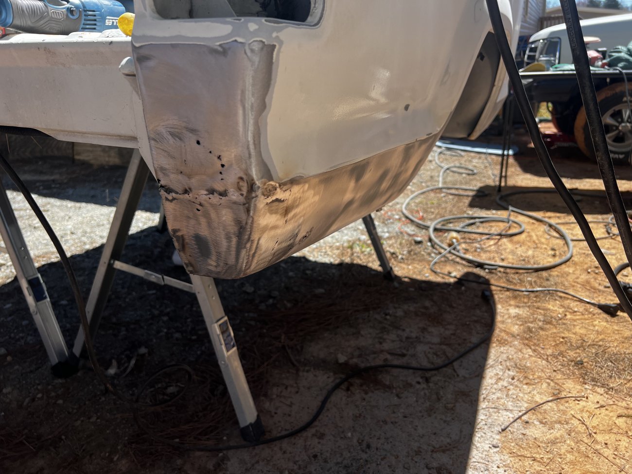

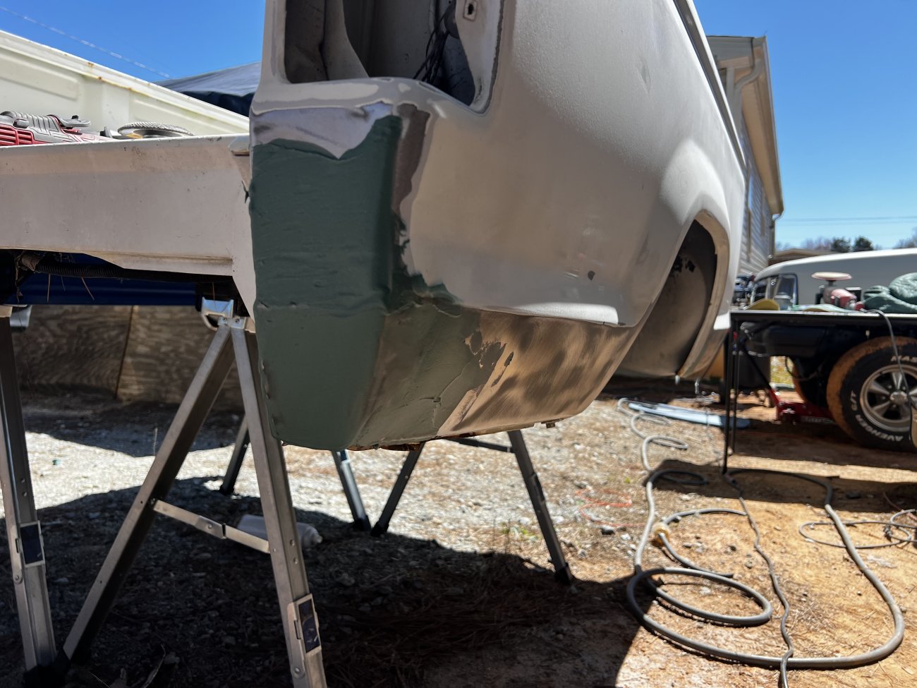

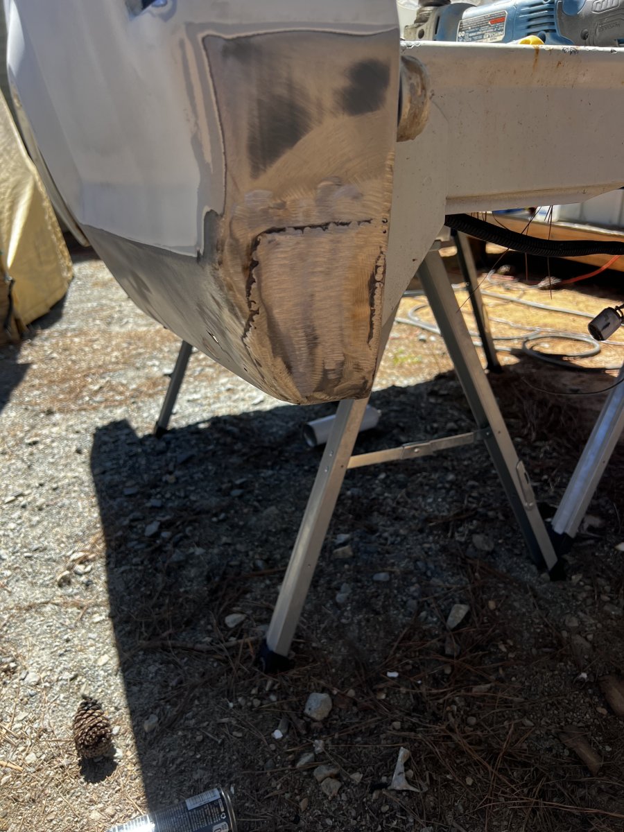

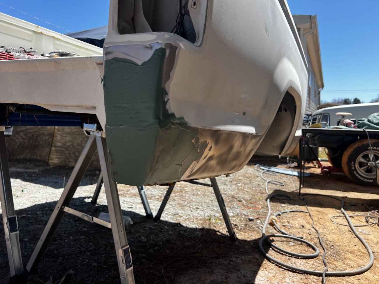

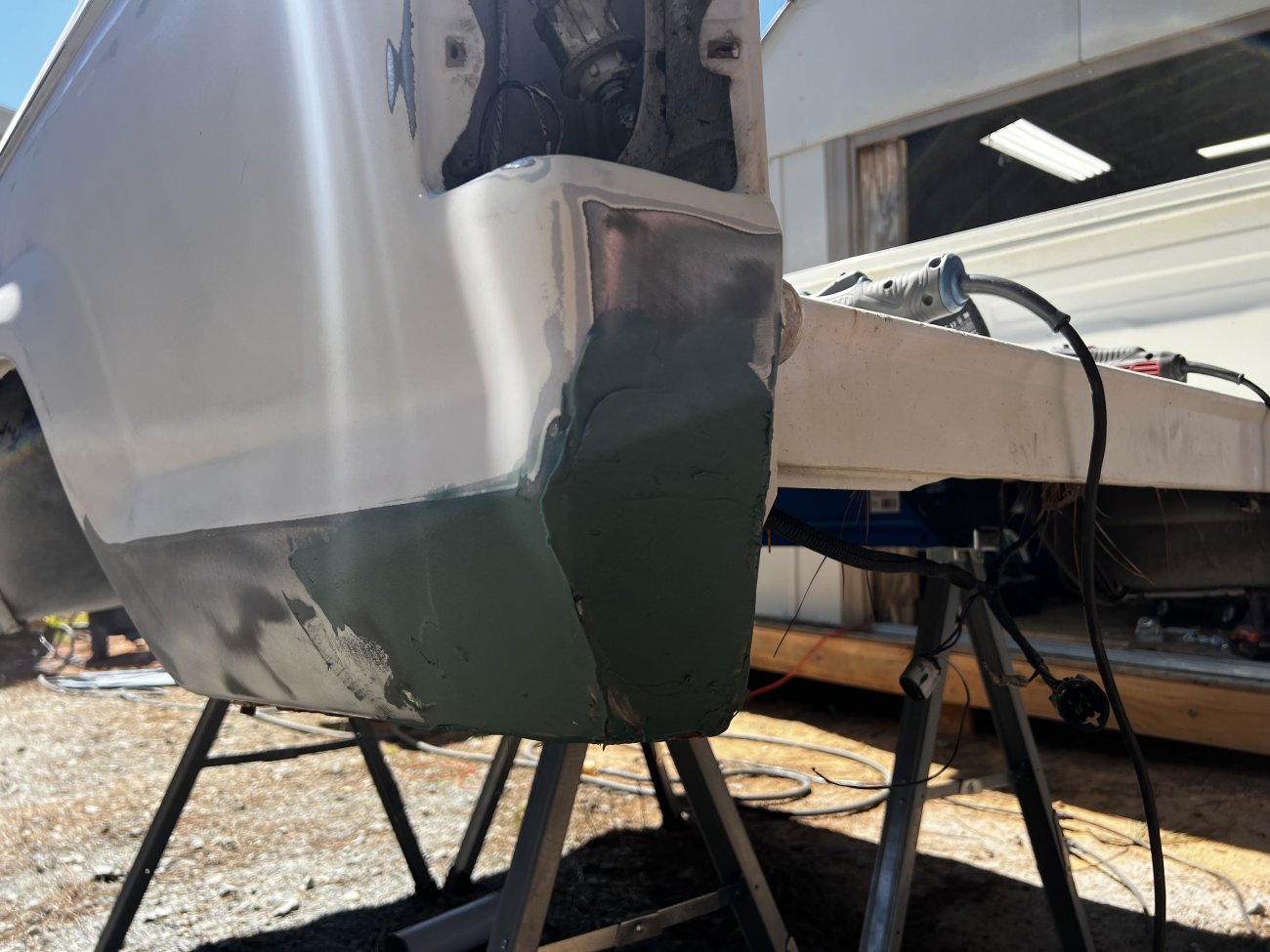

New metal welded in. And a layer of short strand fiberglass has been applied. Time for lots of sanding.
  • Blackwidow reborn

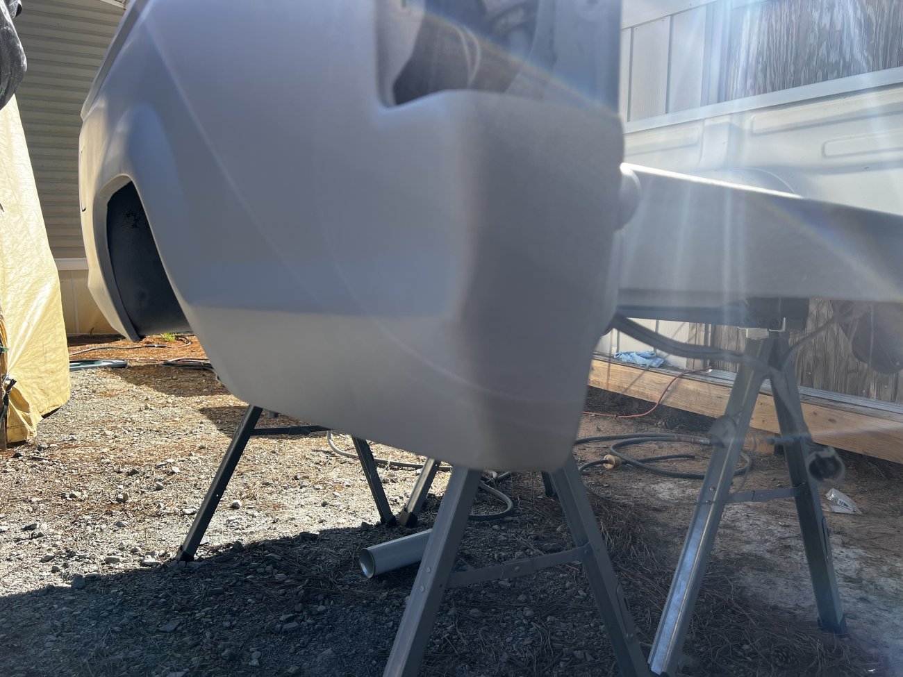

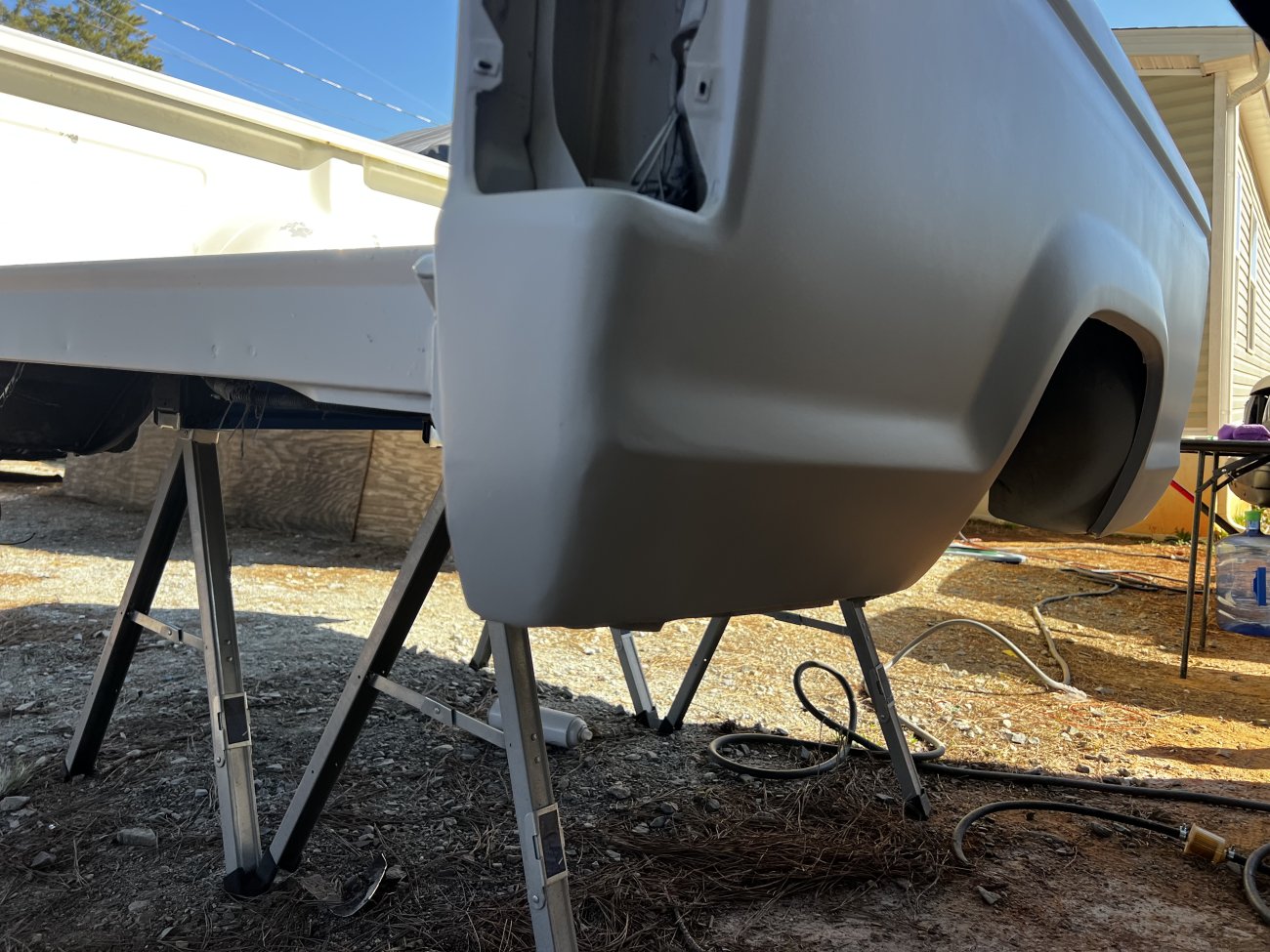

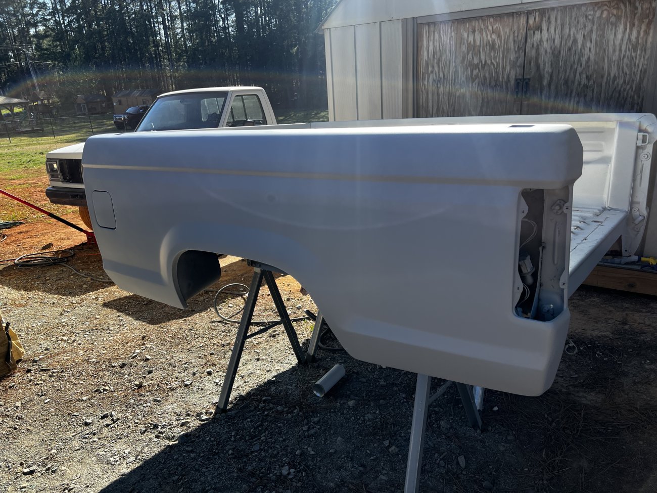

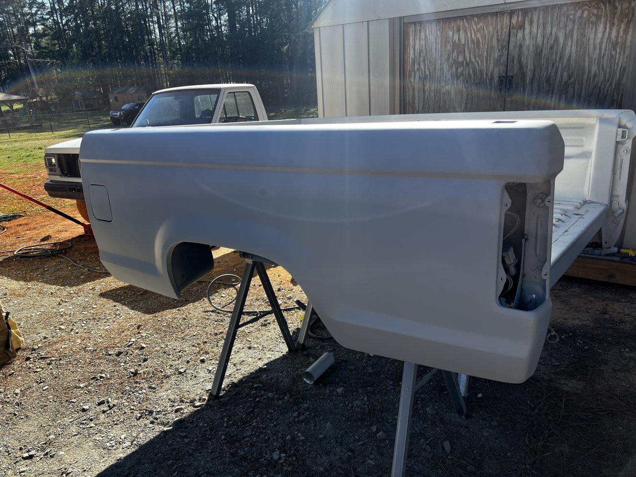

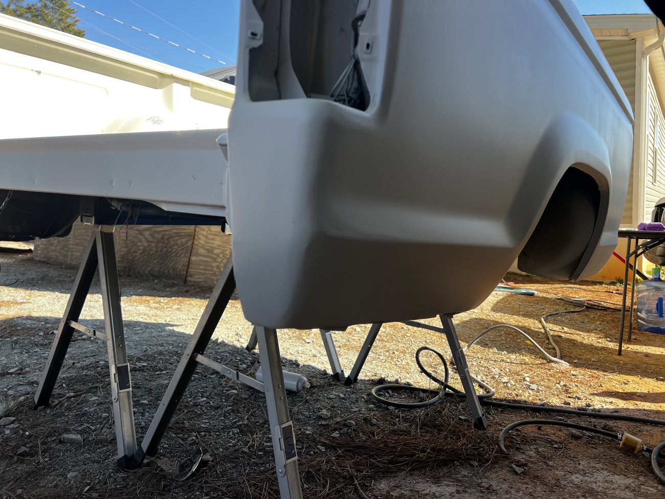

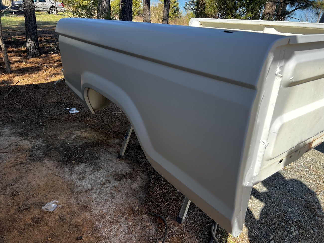

Body work good enough for primer.
  • Blackwidow reborn
  • Blackwidow reborn
  • Blackwidow reborn
  • Blackwidow reborn

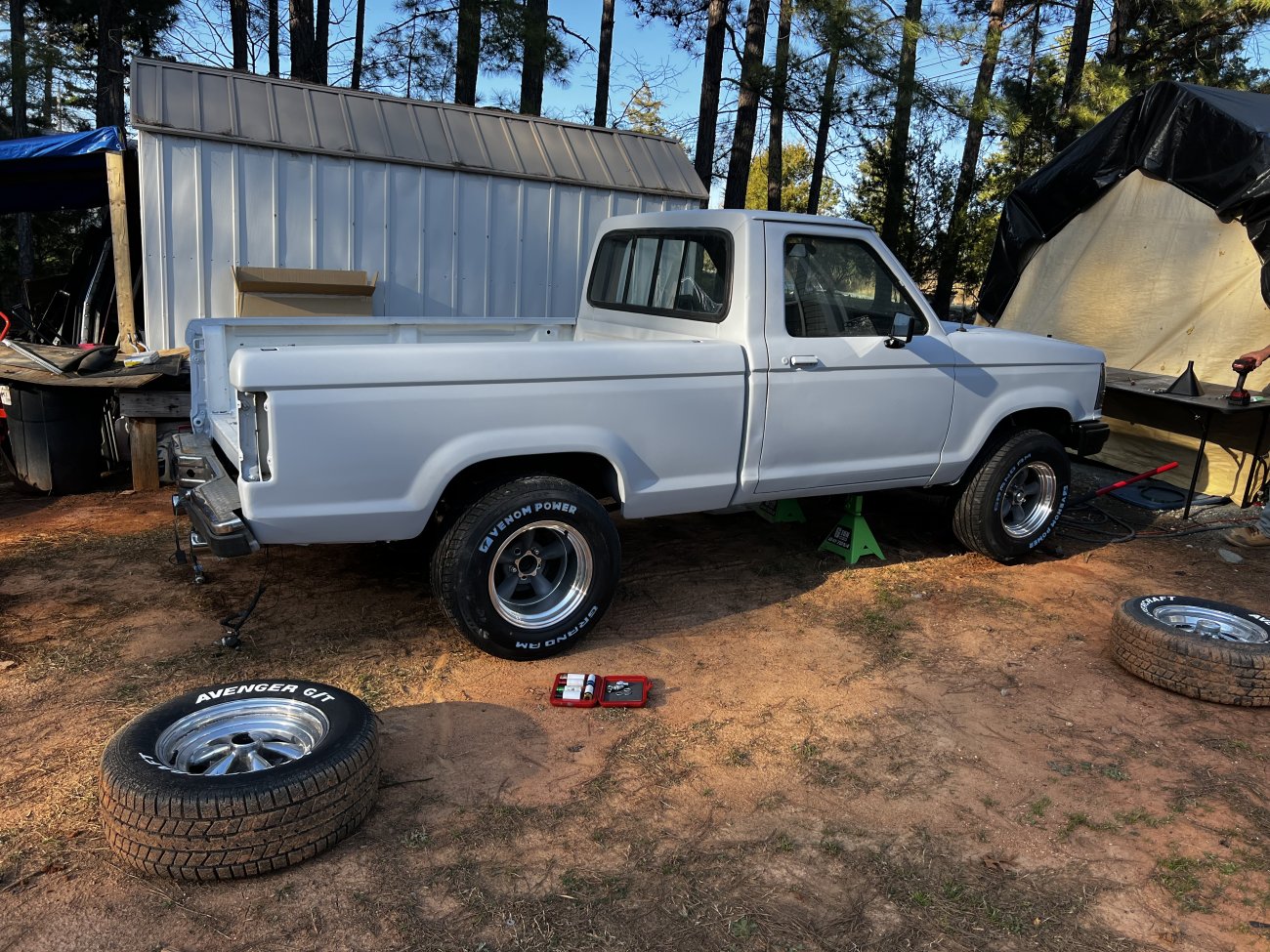

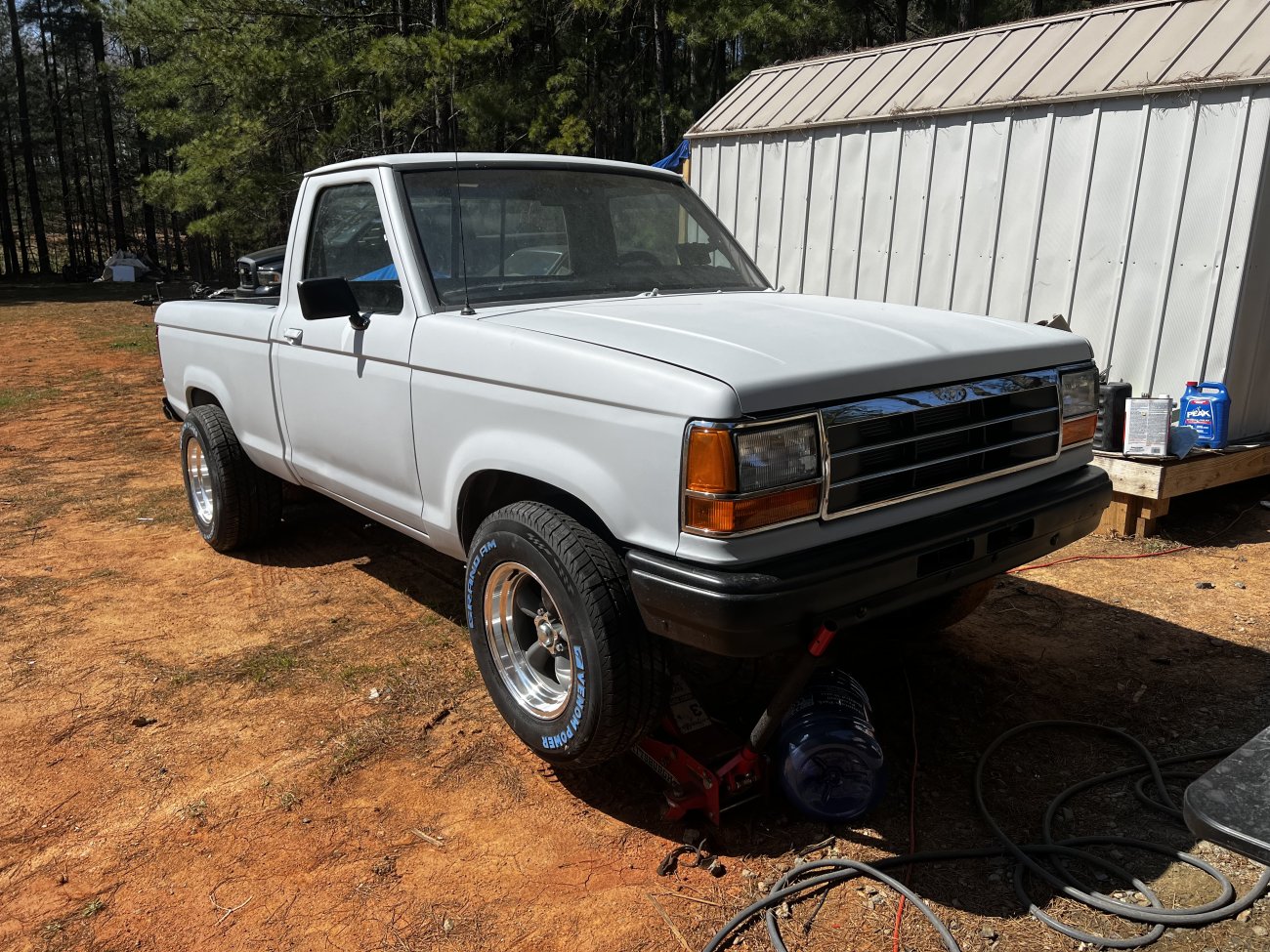

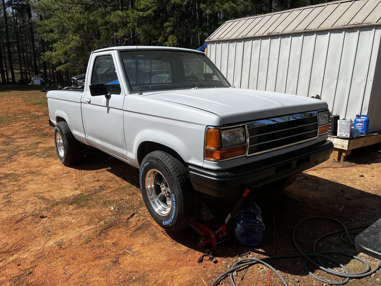

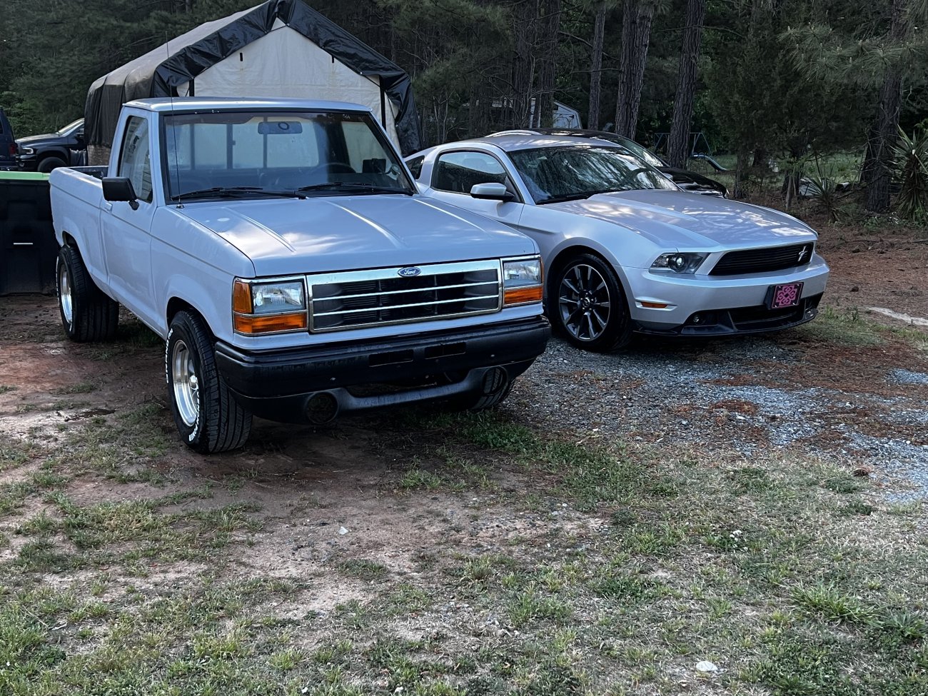

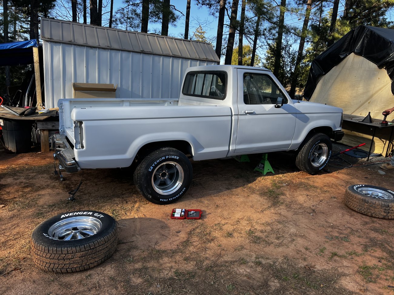

Ok ok ok. I ditched the ugly headlights and went with stock replacements. Now I’m feeling it.
  • Blackwidow reborn

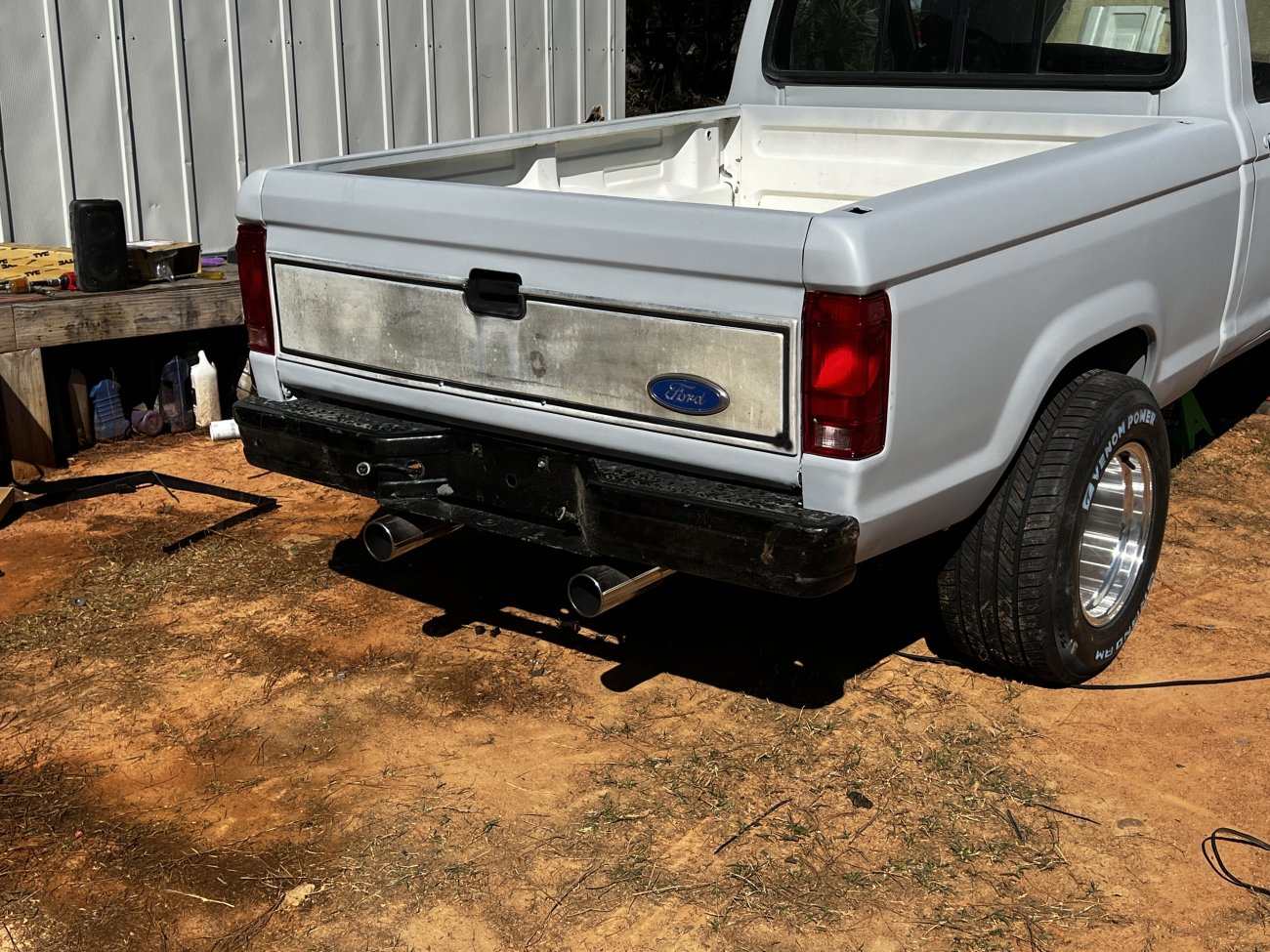

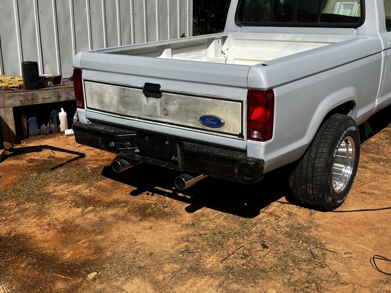

Installed the tailgate. I have a mint one that doesn’t have the panel, that I’m saving for when the truck gets painted.
funny story. This back bumper is off my very first Ranger. Many of you know it as “the blackwidow” I met up with its current owner 2 years ago and he gave me the bumper off it. So I saved it for this girl. Let me tell you. It feels right having a piece of my first truck back.

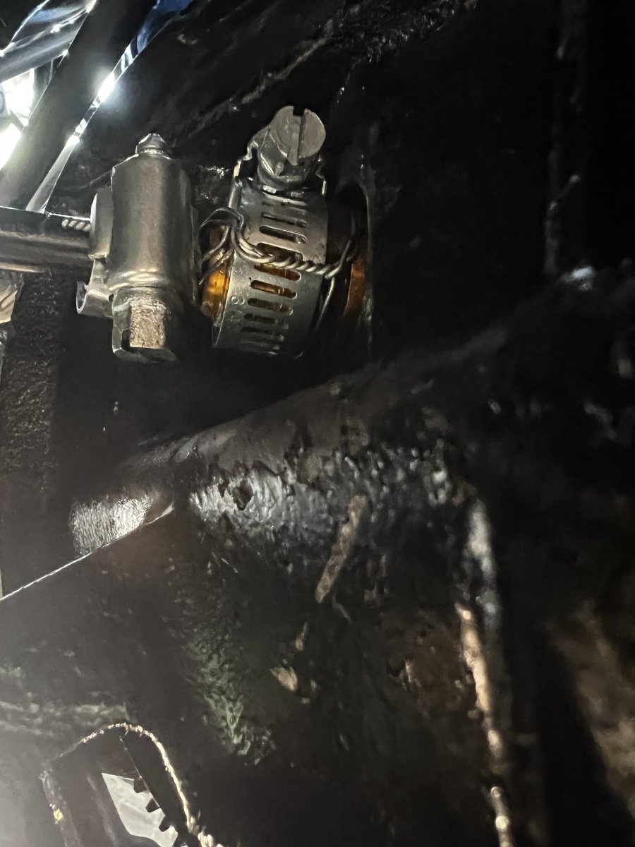

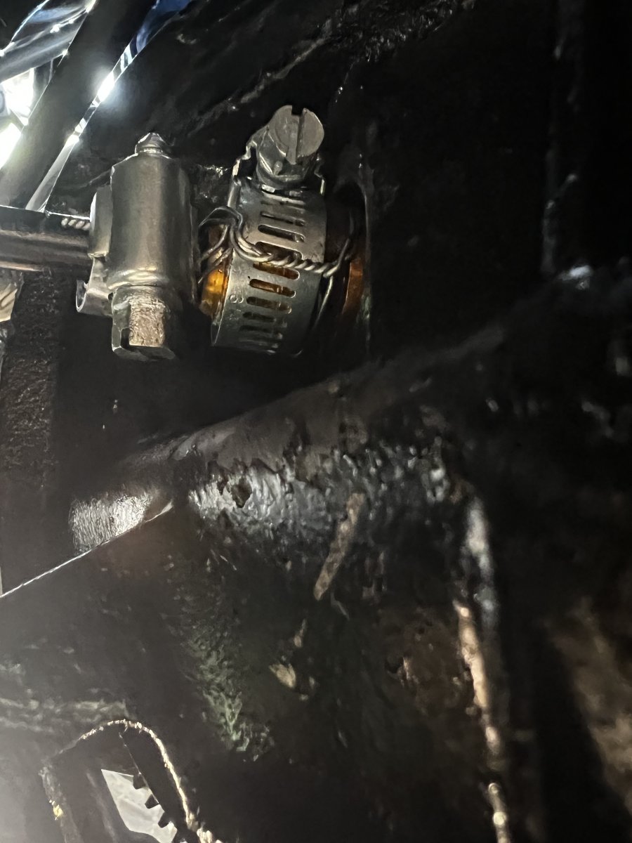

I won’t lie. This truck is kicking my ass. Today I fought the clutch line. It has that stupid horse shoe cup that retains the line. Well. That Gave out. And I was not dropping this trans again. So I made pole barn garage proud and fixed it with wire and hose clamps.
  • Blackwidow reborn

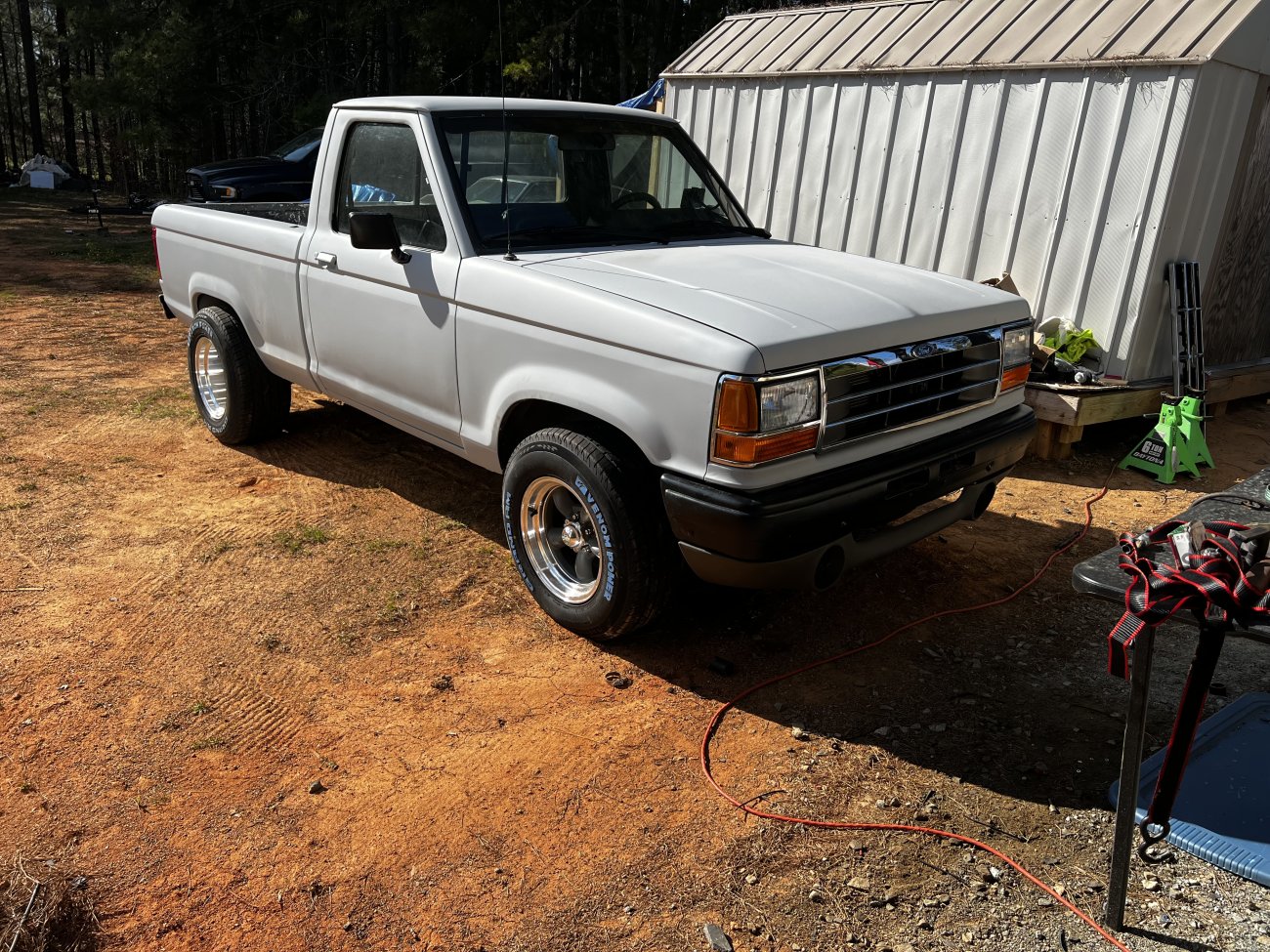

New radius arm bushings. Tied up a bunch of loose ends. Got the new cooling fans installed. Just need to wire them tomorrow. Got it back on all 4 paws. Even got the front valance mocked up. She’s almost road ready

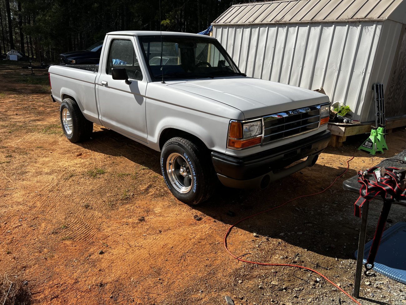

So updates….
I finally got the truck titled and tagged. I have to say. Getting a bonded title for this truck was more work than I was prepared for. But the truck is road legal.
@Uncle Gump you asked about the aces efi setup. I love it. There’s a couple quirks about it, that could be unsettling for some. My biggest thing is, the handheld says the engine runs about 220 degrees. My mechanical gauge and temp gun both read 170. So aces needs to address that issue. That aside. The truck runs amazing. Gets decent mileage. And always starts right up.
I’ve put probably 5-600 miles on it. And so far the only issues I’ve had is a ruptured oil line. So I’m waiting on hoses and fittings to redo them. That aside. No issues to report.
here’s a full body shot. And an overall of the interior.
