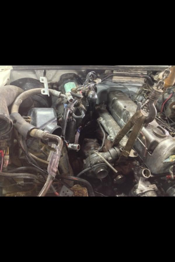

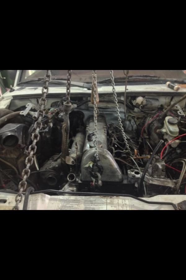

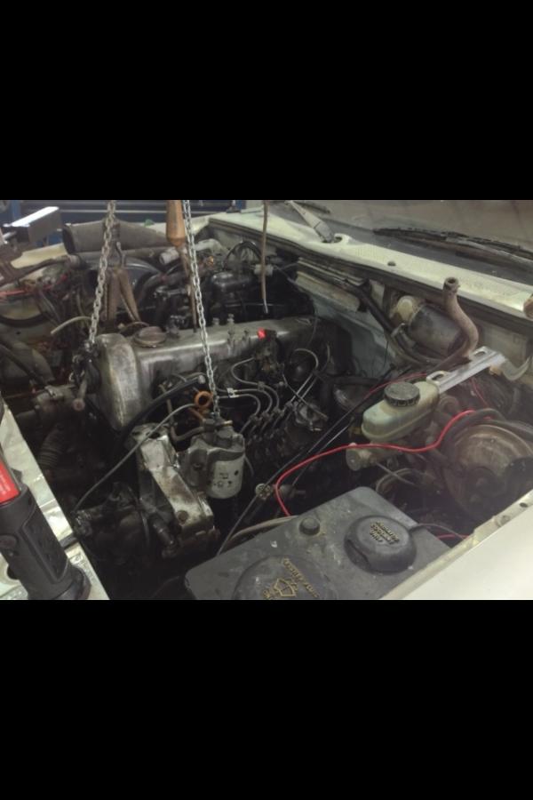

Have the motor sitting in the truck where I want it. Have to get creative with the radiator to make it fit. Still need to finish up the motor mounts so everything is solid. Tons of little things to do.

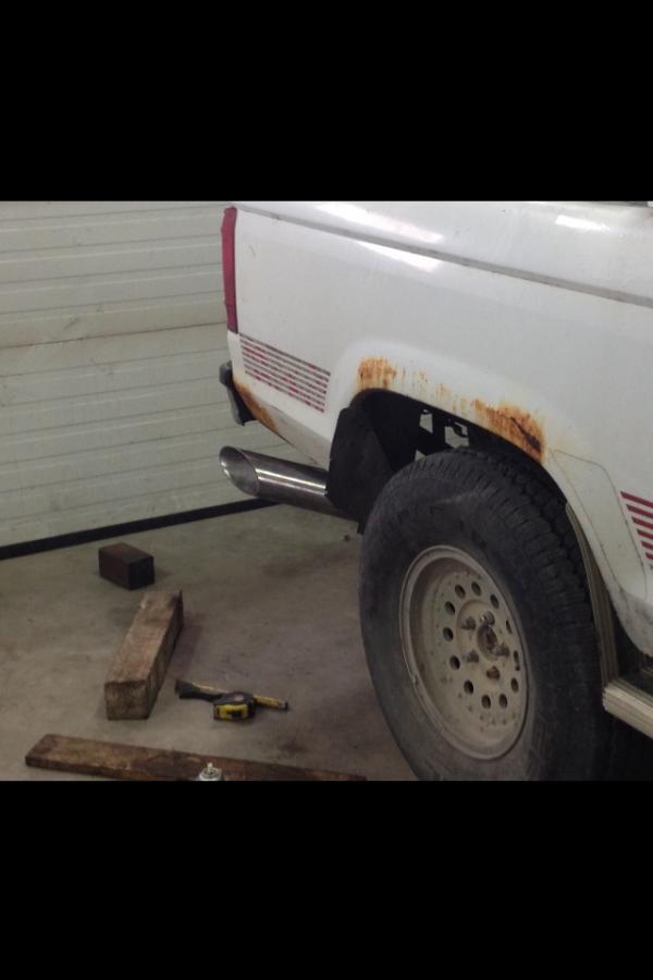

Put in a good weekend and motor and transmission are solid, exhaust is ran I went 2 1/4 from the manifold to the flex right beside the tranny at the joint it changes to 3" all the way up and over the axle then it changes to 4" out the passenger side. I had to modify the front end rad support to sink the rad in. I made a new support out of 1/4 plate I bent up and welded in. I made a metal shroud and bottom plate to protect te rad
Pictures to follow
You know when your almost done a project and you go to test it and everything turns from excitement to anger...... Had everything hooked up had ran it all sounded good and then came to testing the clutch and it needed to be bled well got in there to crack open the bleed screw and it broke off tried fixing it under the truck that didn't work... Truck has been stripped right apart but I'm getting faster at it lol by te end I'll never be scared to rip it apart and fix anything two hours to have motor and tranny out. Hope to get it fixed up tonight and slap it back in tomorrow
