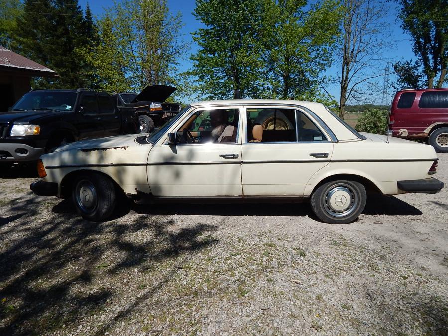

I purchased a 1980 MB 240 D w/4spd manual on the weekend for a reasonable price so that I could rip its heart out . :icon_hornsup: added pic .................

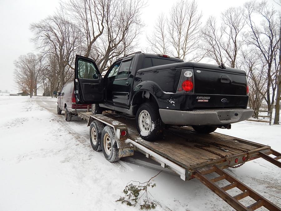

sport trac pic , purchased with blown up 4.0 OHC .

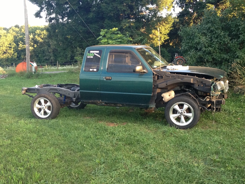

I may be selling my ranger and everything I have with it.
Still a project but pretty much everything is there, just gotta finish assembly.
Not in stone yet but putting it out there if anyone is interested, message me for more details.

Pics from last year, did some body work and what not since then.
