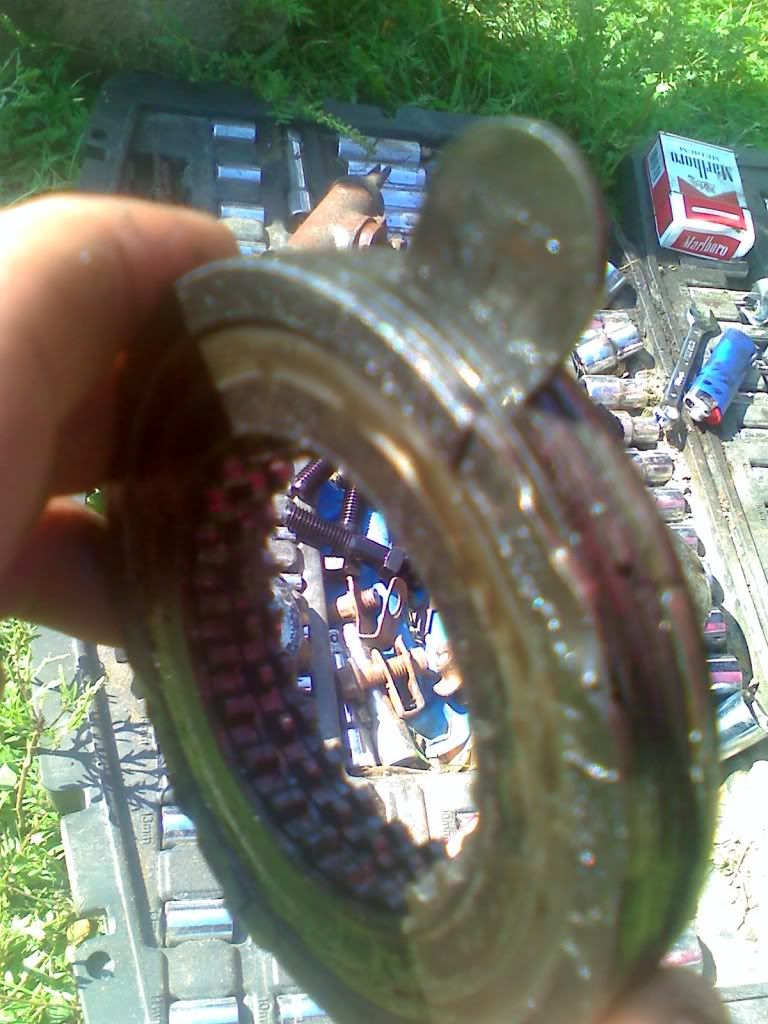

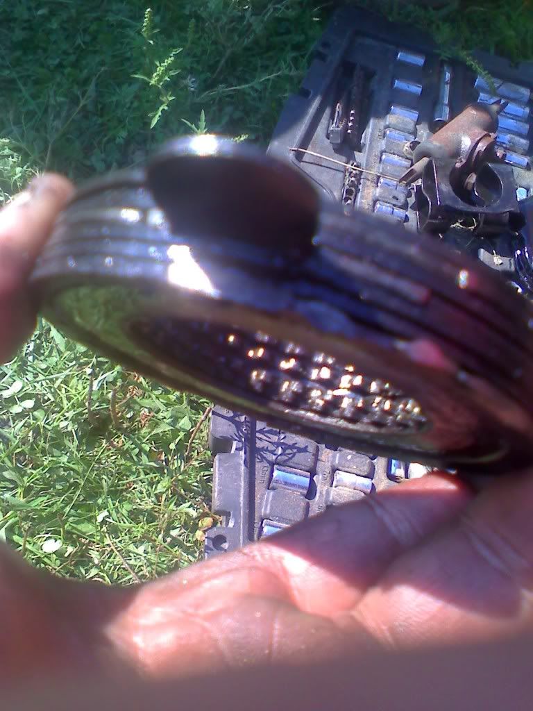

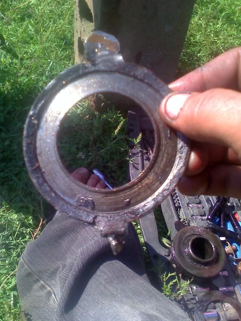

well i pulled it all apart today removed everything but the pinion, and attached to the side gears are like 6 plates per side...i wanna say those are the clutch plates (if i remember correctly but not sure) for the LS...and once again if i remember right 3 of the 6 per side should have 2 tabs on it which slide into slots on the carrier.... well i only have one per side and they are closest to the side gear (on each side) i also recovered what seems like the remains of the other tabs in the bottom of the diff...and i see what looks like where the tabs were supposed to be?...i'll post pics in a while to show exactly what im talking about could this be my problem...and i also decided to spin the pinion yoke b4 i removed the axles and it still turned one axle shaft but not the other (this is with it out from the truck and sitting on jack stands) im just lost lol so if u can help me out it'd be super appreciated thanks and i'll get on those pics since they can explain better than i know how lol thanks again
well here are my pics and there is 7 plates per side gear...the first two are the ones opposite the ring gear and the next 4 are the ones closest to the ring gear and and the final pic is of the shreads of those tabs as i call them
opposite ring gear plates
closest to ring gear plates
ones of the plates (with tabs alone) very special its mangled

The correct way to put the plates back into the rearend is 1 clutch plate, 2 drive plates, 1 clutch plate, 2 drive plates and 1 clutch plate. then the "S" spring. That is typical of the clutch plates doing what they did. The reason they did that was probably because someone had changed the gear oil out and never put in the additive for the L/S. The additive allows the plated to silp without damaging them. As for the rearend.....if you have the truck in park with the driveshaft connected and you turn one wheel the other side should turn opposite. Now with the drive shaft connected and truck in neutral or driveshaft disconnected and you turn the pinion both tires should turn the same direction. Without limited slip just one tire would turn.
