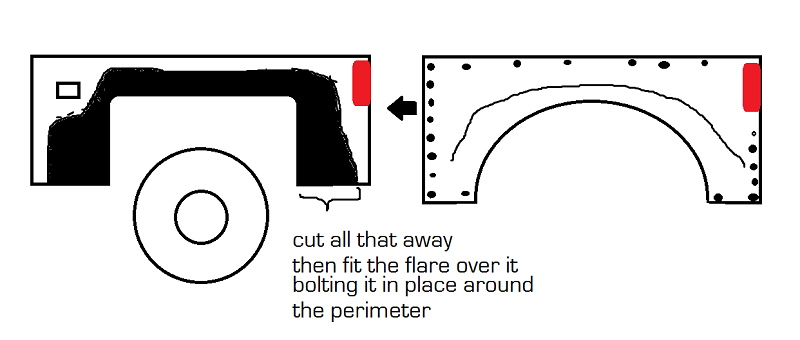

Ok so I've recently come across a set of bedsides too good to pass up. 5" fiberglass bedsides perfect condition for 100 bucks. Anyway, I'm going to cut my regular bedsides out to a really large fender and then bolt the fiberglass bedsides to what remains. I wanted to know if I could use a bedliner, camper shell, and bedsides all at the same time. If I used long enough bolts would it be ok or would I have problems with vehicle stability at high speeds? Any suggestions or comments?

Upgrading to either an 8.8" or upgrading my 7.5" and getting offset wheels so track width yes, but I also do a lot of gravel/sand drifting so width isn't a problem. Plus, I'm also getting a suspension lift soon, so I want to have the whole prerunner thing set up as soon as I can. Would chopping the bedsides reduce rigidity too much to use the camper shell?
Nope, with the bedsides properly secured along with the bracing mod'd around the lower wheel well you'll never notice a difference between them and the stock box.
Well that's good then. Now I just have to rig up a way to make a fuel door for it since I'm utilizing the stock tank.
??? Remove to stock bedsides completely. You probably won't be able to fit the fiberglass over top of them. Plus if you did, it would look like crap.
Fiberglass has one purpose to me, it allows my truck to be street legal and it doesn't weigh much..
On my truck I got one of those cheesy autozone billet fuel doors and put it into my fiberglass bedside, The I made a mount with tubing and a hose clamp to hold my filler neck behind it.. It works pretty well and it sure beats filling up through the fender well.. :)
Great idea! I'll use the fuel door from autozone. What I mean is cut away the excess material, then use the flared bedside to take place of the stock bedside. It actually would fit, but there's excess material on the flare I would have to remove to get it to fit, but it would end up getting removed anyway.
