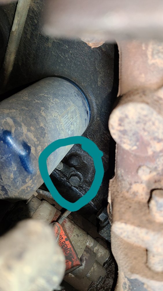

Ok. On my '93 3.0l, the battery negative is on the block, above the starter and below and to the rear of the oil filter. Hope this helps. Not an easy place to get the camera. It would be easiest to disconnect the battery and remove the starter if you have trouble getting your hands up there. Disconnect the battery anyway for safety while using wrenches in this area.
Circled in this picture.

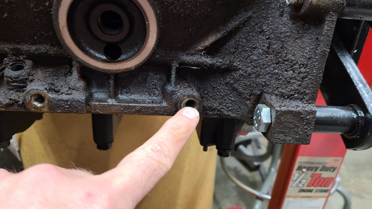

Here is that same boss with threaded hole on a '97 3.0l block.
