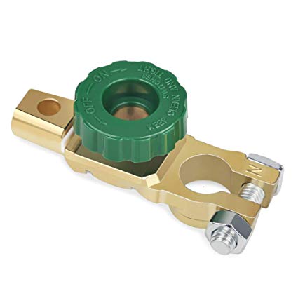

I bought a beater 1999 Mercury Mountaineer with V8 a while back. A previous owner had installed a huge electromagnetic battery cutoff (aka relay) that has a receiver that turns it on and off via a key fob. (Like this: Amazon link. ) As it turns out there is something draining the battery. After our last cold snap the relay quit working so I have to pop the hood and disconnect the battery manually.
I was going to just buy another for now, but upon researching I have learned that the device is not a latching relay. This means that it draws power from the battery to keep the power on. If I forget to turn it off, it will draw power from the battery and drain it.

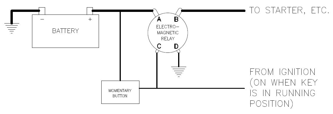

I wonder if there is a way to use the signal from the ignition system and a momentary switch so that it will automatically cut power when the engine is cut off. Then I would have to hold the button while turning the key to start it. Something like this: (sorry for the crude drawing but this should get the message across.)
Is there an issue with the fact that I am essentially connecting a wire from the ignition straight to the battery when the button is held down? Will my schematic work as described? Do you have a better way? Eventually, I will fix the issue so I won't need the relay but I don't that much time to invest in this junk vehicle right now.
