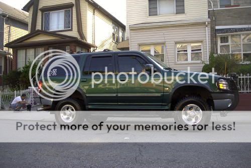

k heres an new Explorer but it has a 3in BL with 31 so u kinda get an idea
