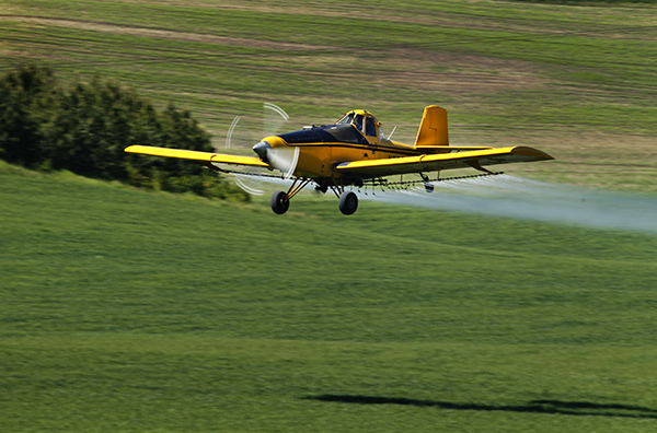

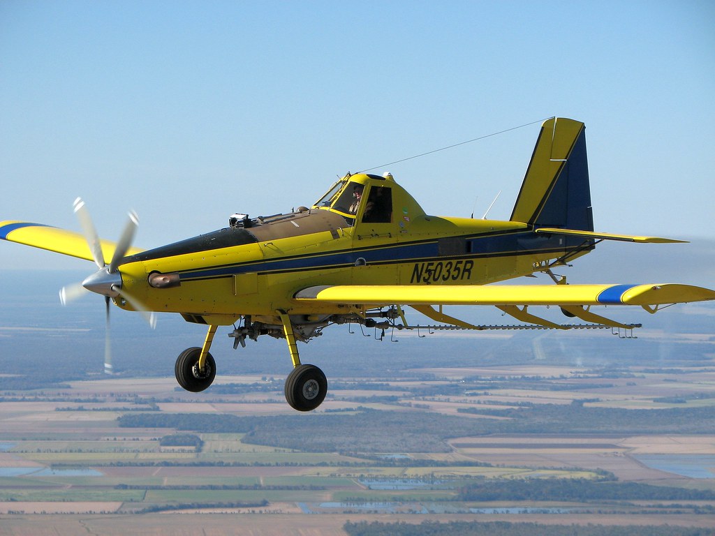

Actually unpowered aircraft propellers are drag, they adjust the pitch so they don't turn whenever possible.
However as somewhat of a tie in to your theory they do do that for certain things on aircraft. Some jets have deployable windmills (little propeller looking things) to turn a generator in the event of electrical failure. Some ag aircraft have a similar setup to run their chemical pumps.
They all suck energy but sometimes it pencils out. It doesn't take much to beat landing without controls or a radio and for low speed high powered ag aircraft it is probably more effiecent than an electrical pump.
I have a pic of the emergency one deployed on a F-105 at home, here is a cropduster, you can see it on the belly between the landing gear.
