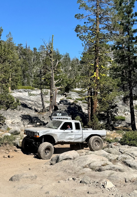

Just got back from the Rubicon trail, and noticed lots of solar.
I'm thinking of adding a panel onto the b2, and curious how you guys are handing wire management.
Didn't see any B2s on the con, but I did spot this ranger :cool:
that is a member iirc.
