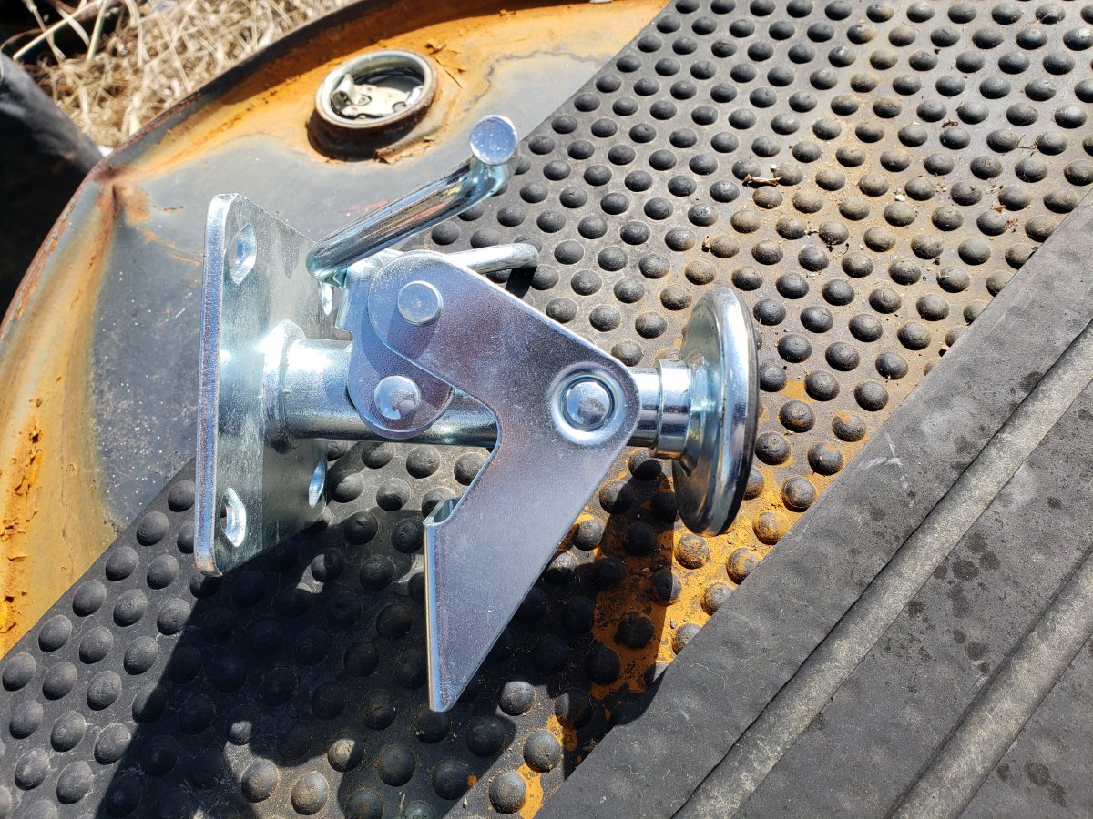

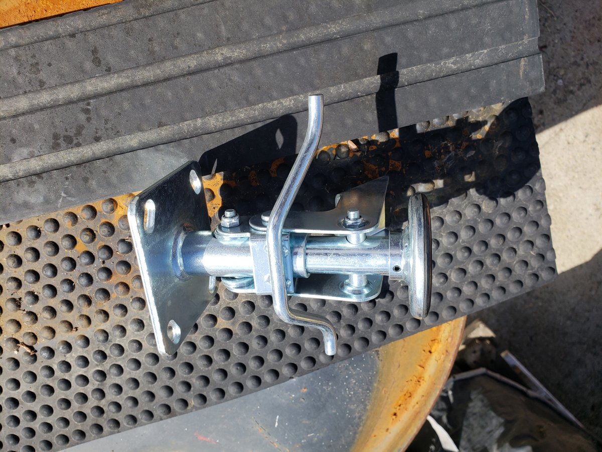

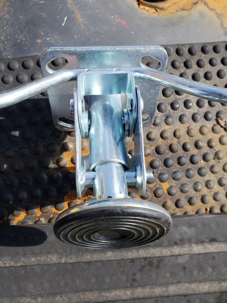

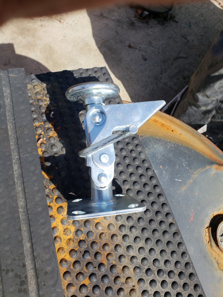

My local home depot is starting up the garden section. The display shelves have a locking foot system you might copy. I did find some feet similar one time at Princess Auto (Harbor Freight).
Second pic is missing the foot but should be easy to figure out.
View attachment 58044View attachment 58045
Awesome, that's exactly what I'm talkin about...Looks like a more simple version of the dirt bike lifts. I will see if there's any materials that match for telescoping, and mess around with that. Thanks!

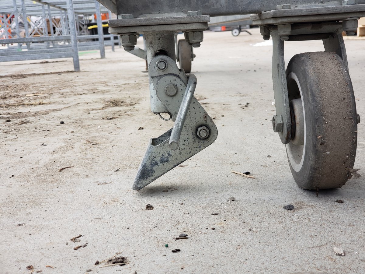

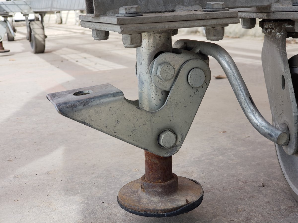

I'll try to get a picture tomorrow, but we have a mobile staircase at work for the pallet racking that works like you are going for... I think you are just missing one link, the bottom needs to be a shackle not solid so it can do like it is doing in your picture...
First... there’s no such thing as idiot proof, the best you can shoot for is idiot resistant.
Second... You want the casters to be the retractable part. The movable part will always have a little slop to it. That will transfer to the table top and whatever is mounted to it. While your moving it, that won’t mean much, but as you’re using the equipment on top you want it rock solid.
Depending on budget, weight, flooring, etc. you may want to pick up a used or cheap pallet jack as your base and build off that.
