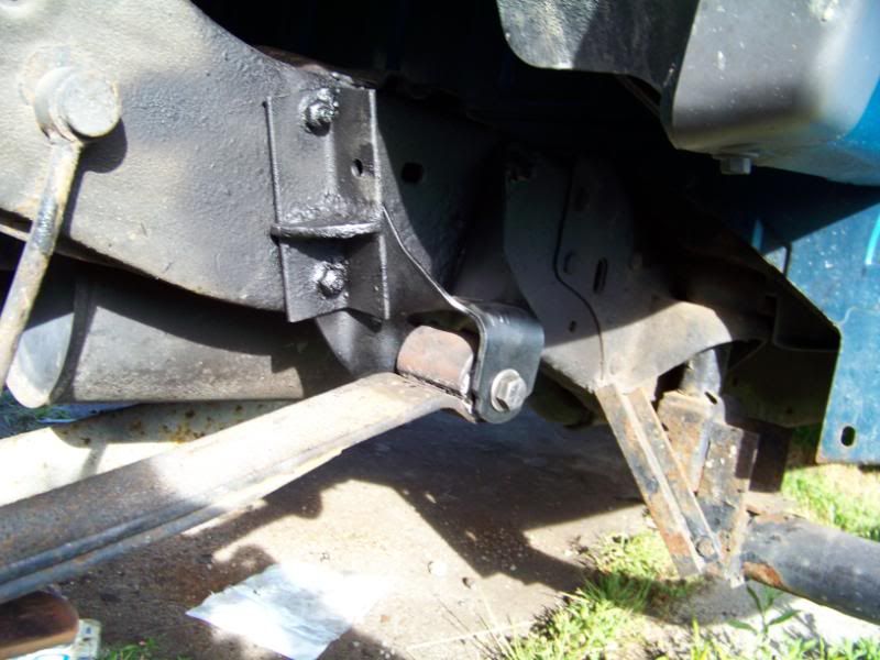

Look for what's called "traction bars", the kind with a shackle on the end are the best, though there's plenty of others out there that will still work. That's generally the easiest cure for axle wrap.

He could ditch the block and swap in belltech shackles to regain the height.
Traction bars would certainly do the trick but would cost a hair more.

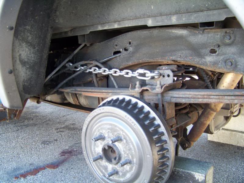

i used chain with the same concept in mind as a traction bar, when going forward the force on the chain is a "pull" so it really doesnt matter if its solid rod or chain. made a bracket that attaches on top of the axle between the U-bolts for the axle attachment point, for the forward attachment point i took some angle iron, added a small peice of metal as a brace in the middle of it and it bolts to the backside of the front spring hangers. (did this while doing a front spring hanger replacement.) at the front is a threaded eye so i can draw up the tension on it. does make the rear suspension a little stiffer, but no axle wrap!

my first attempts at this used a beam clamp to the rear of the front spring hanger, it worked bout would bend the hanger. i also had a issue with the eye attachment point at the axle break. i now use a quick-link to attach the chain to the axle end instead of the lifting eye i used, and with the seperate peice of steel as the front attachment point things seem to be staying together well. lst i knew the james duff traction bar kit was somewhere around $100. ive not kept track of what ive spent with my chain setup, but im sure it would be way under. most of what i used i had laying around, only bought the thresded eye ends and quick links new.
