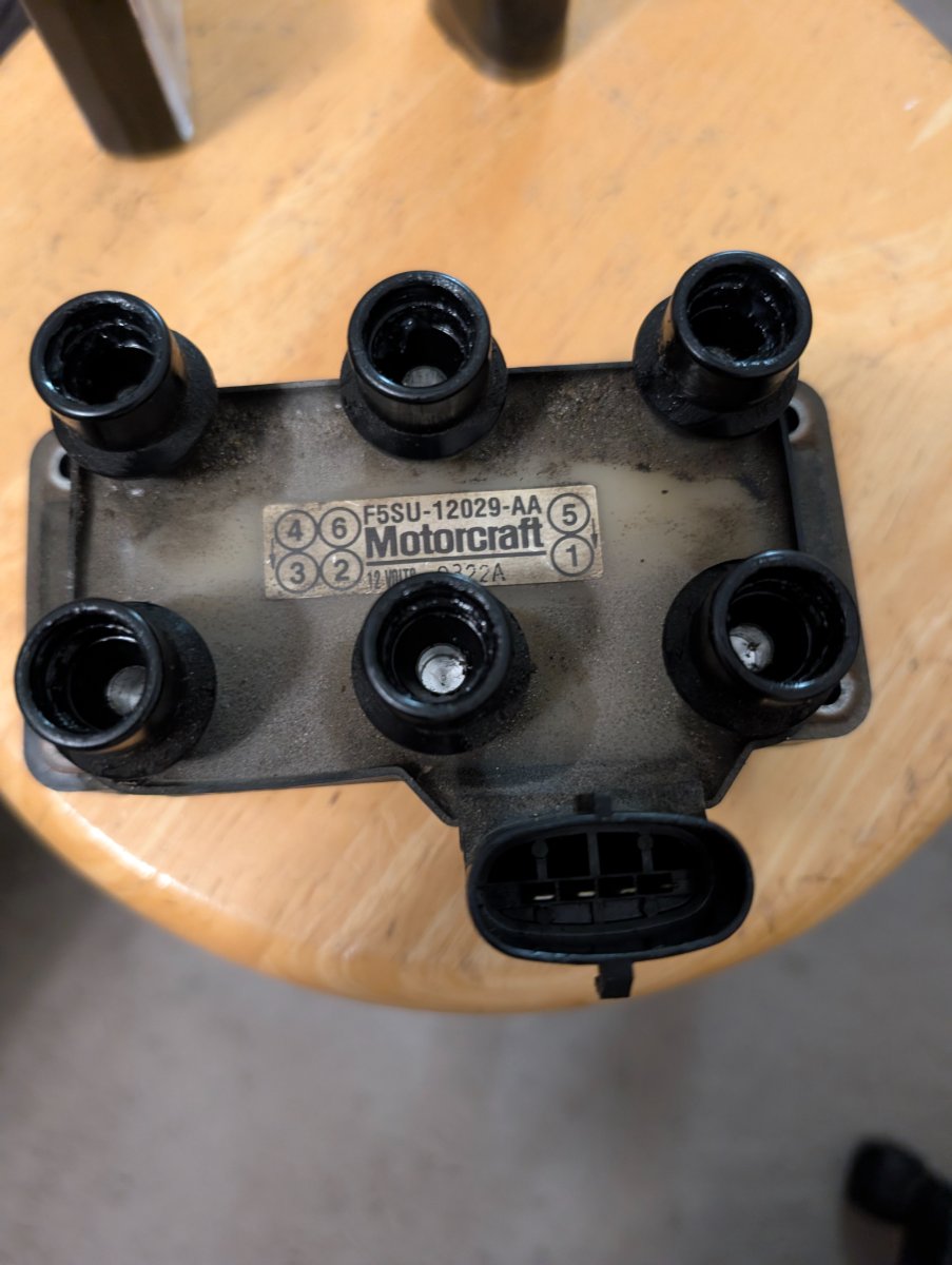

Here's a TSB about bad coils. "If the first four numbers of the code fall in the numerical range from 7001 to 9213 replace coil with revised coil (F5SZ-12029-A). If the service coil label code falls in this range, obtain another service coil and again check the code on the label of the new service coil. Return coils that fall within the range for a refund per your part return policy. Only use the service coil if the first four numbers of the code DO NOT fall within the numerical range 7001 to 9213."
Here's my old one that I replaced with another motorcraft. Old one was working fine, just seen a good deal on a new one. As you can see the 4 numbers are 9322 so it's a good one technically. I'd give it to you if I could just so you have a known good one.
