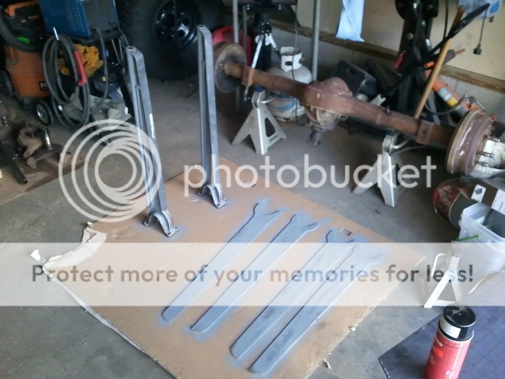

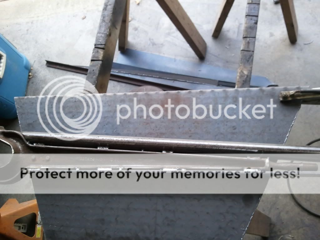

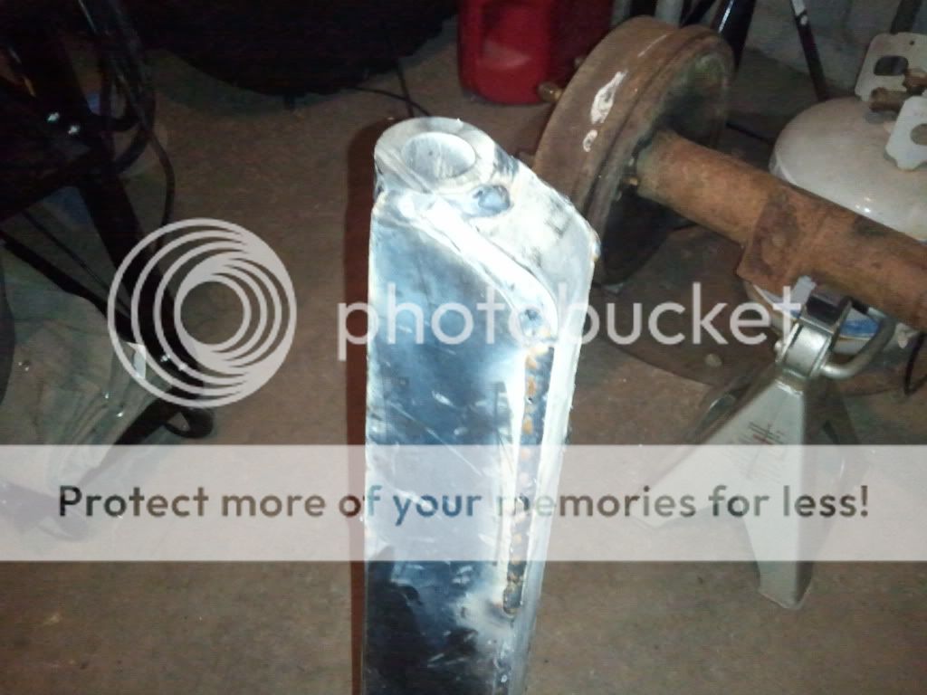

After it cooled down a little outside I got one side piece cut .

So you are keeping the stock arms in there? Those are going to be beef.

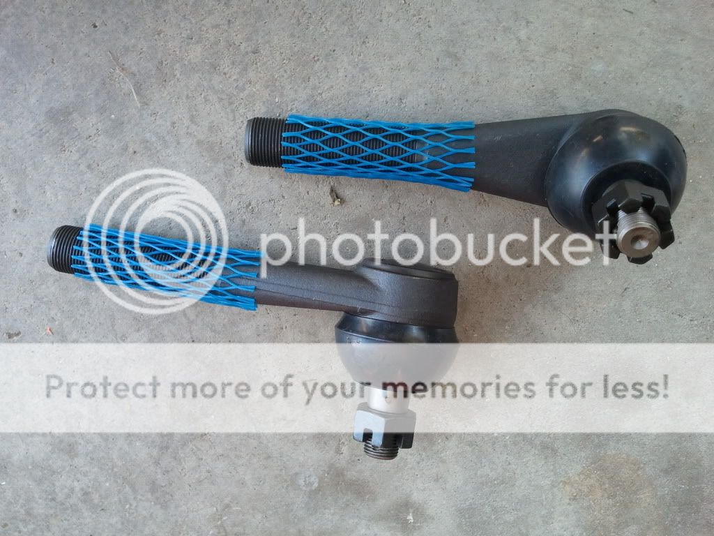

Ruff Stuff sent me a right and left hand thread drag link ends . Thanks Ruff Stuff :icon_hornsup:

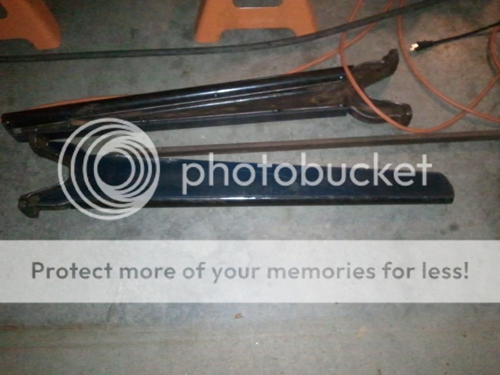

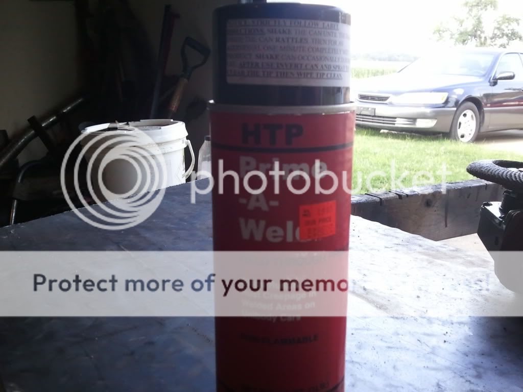

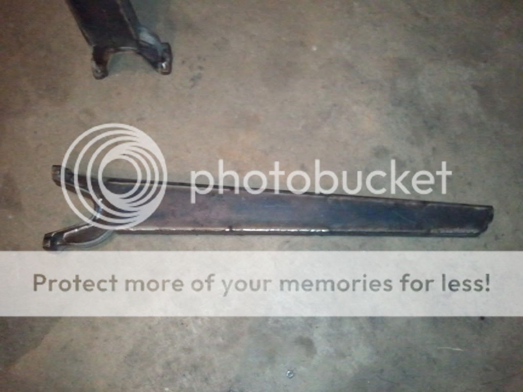

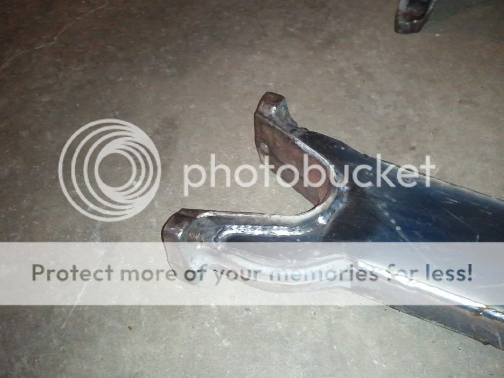

Got the 3/16 cut and primed on one side with weldable primer . Also stitch welded the arms .

Almost done welding the arms . Going to stop and try to get the gears in tonight .
where did you get the weldable primer?
