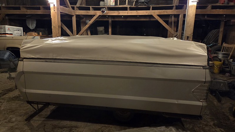

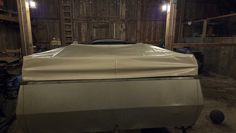

However the road cover continued to be an issue so we used our tax return to order a replacement... that finally showed up last weekend. Since they wanted us to send our road cover in to replicate it we had the Skamper out last weekend so I am just now getting to trying the new cover out.

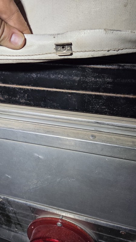

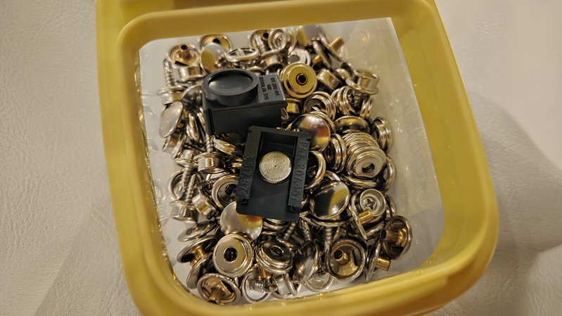

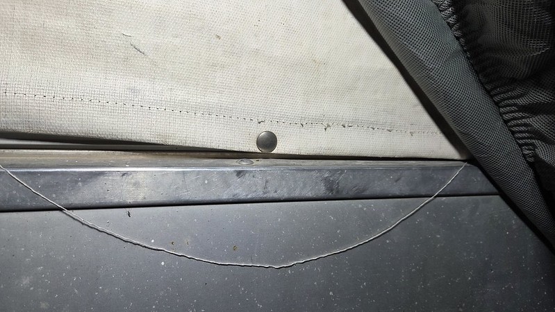

And the twist... because if I am involved nothing ever just drops into place. When we ordered it they asked if we anted it set up for bungie cords or they could just include round button snaps to install where we wanted them. I replied I would like the same style snaps we had because that is also how the camper canvas clips onto the lower hull. There is a plastic track around the circumference.
1965 Apache Silver Buffalo
Boats use something similar but much bigger (like 1/2" vs 7/8")
I put them in a plastic box to keep track of them but these are what was sent with our new cover:
Upon more research I find other people who have searched for these stupid clips and they arrive at the conclusion that they were made for Apache and are out of production and are basically NLA.
So I think I going to have to set the camper up, mark where the clips land on the actual canvas body and trim the track to fit where the buttons are going to end up.
