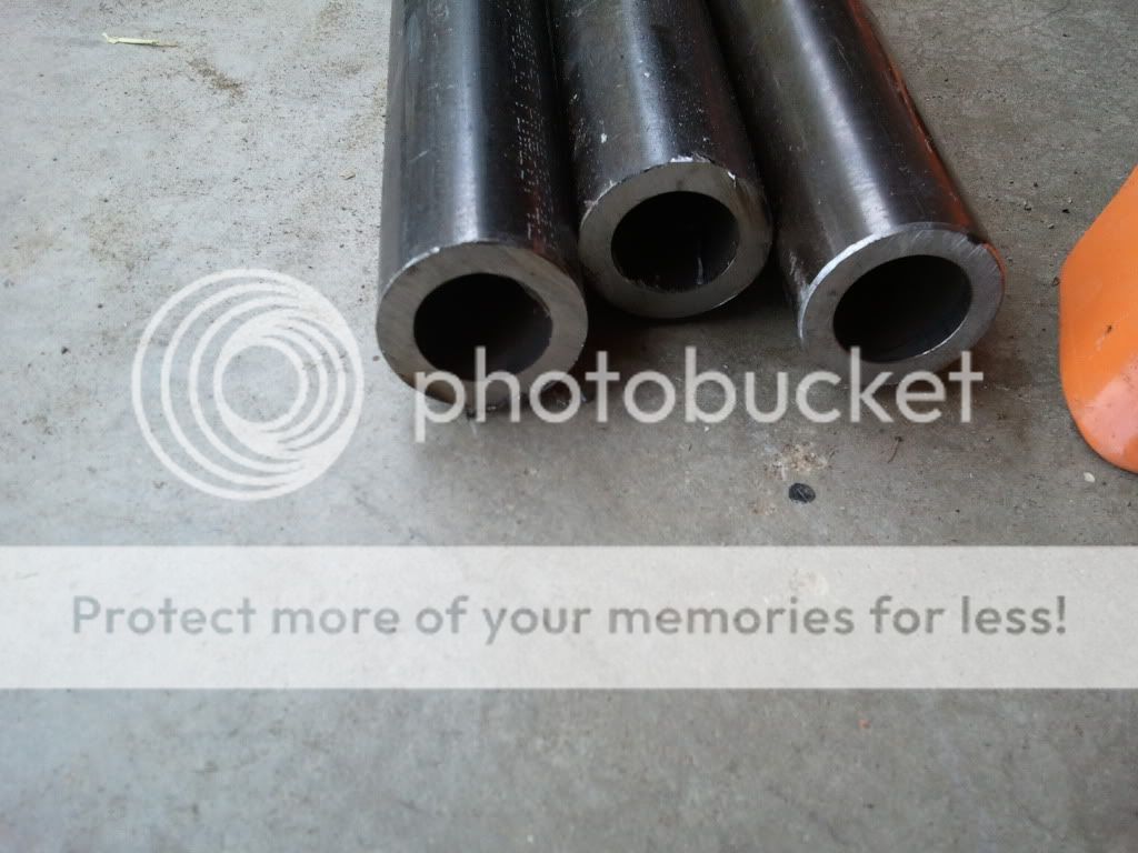

You can have it back , I have no plans for it right now . There is a 35 , 20 and a 19 .
i just need the 35 for a rear crossmember. was going to use 2x3 but the body mounts are made into the rear crossmember so i have to cut it out.

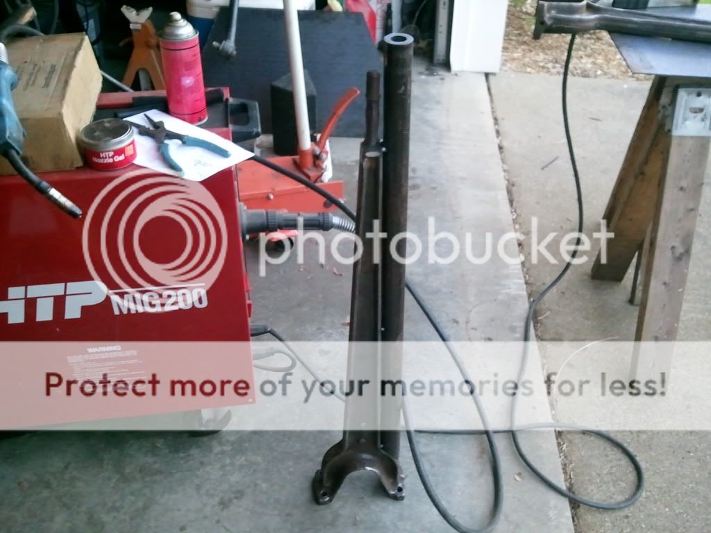

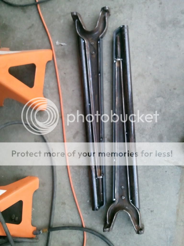

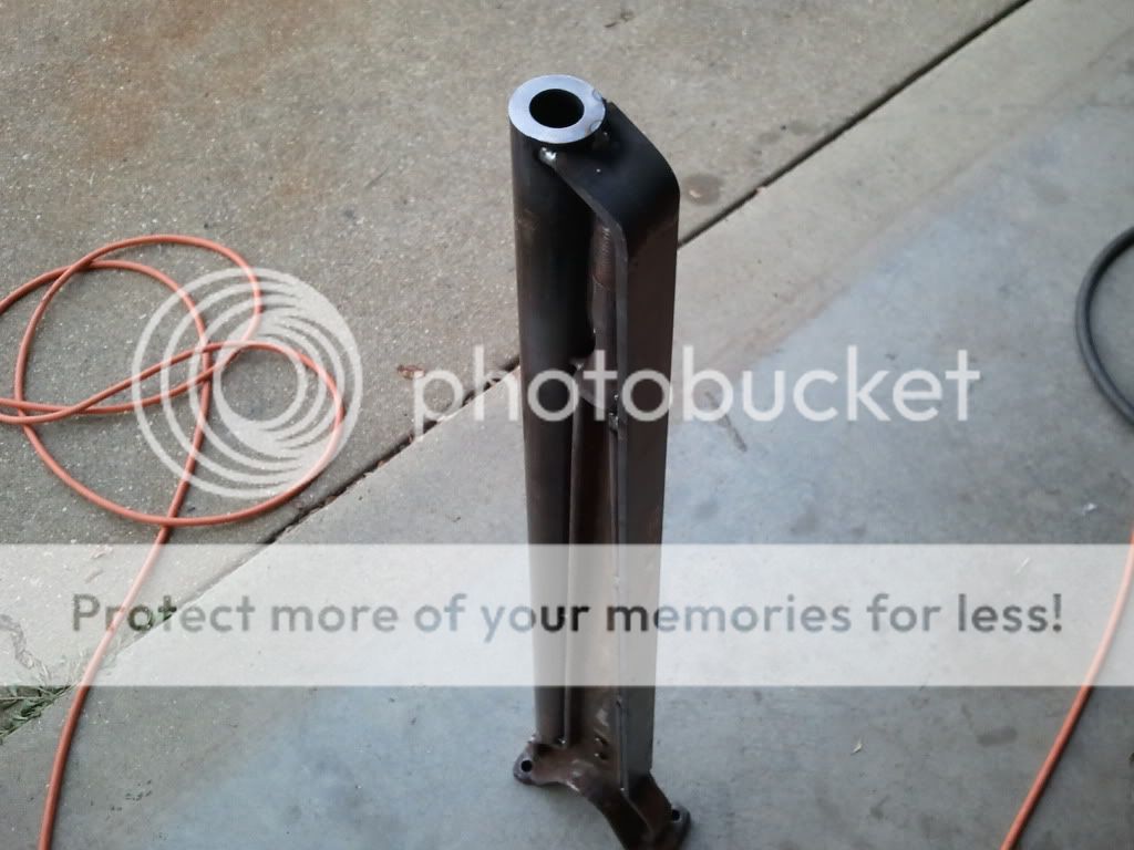

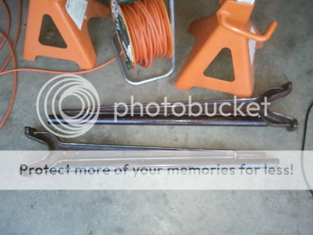

Spent the last couple of days trying to come up with a design for the radius arms . Didn't want to loose too much ground clearance .
This is what I have tacked together so far . I think I'm just going to plate both sides with 3/16 sheet and be done with them .

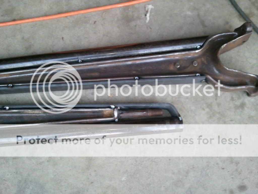

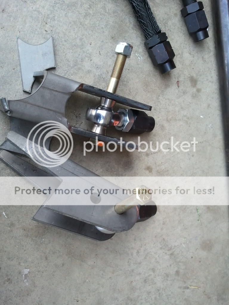

It's hot out there ! Added 1/4 x 1 1/2 piece of bar to the bottom of the arms . Still need to put 3/16 on the sides .

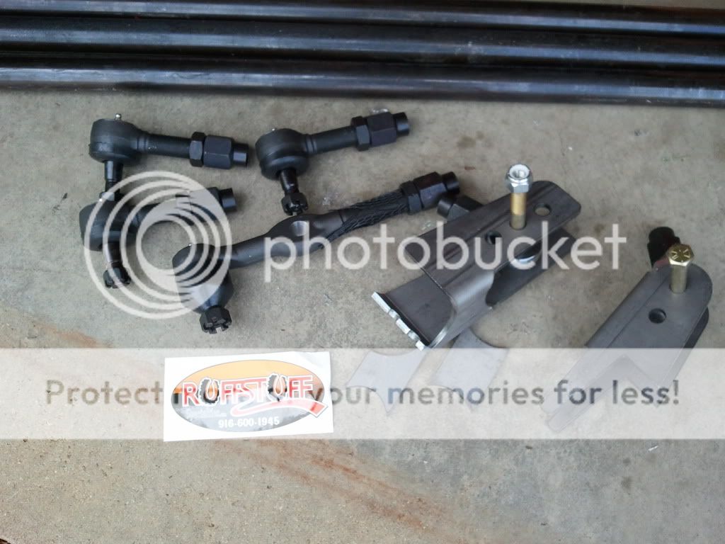

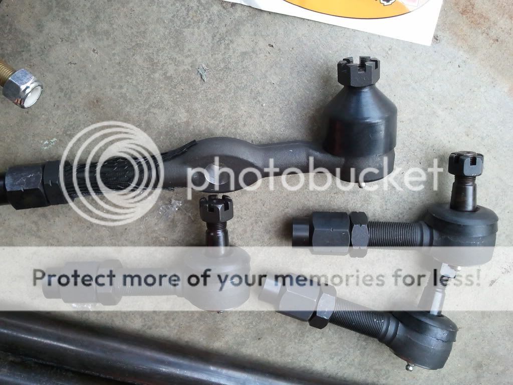

How come you didn't get a DRE for the pitman are connection?:
New Steering bling came in this week .

By far the coolest way to beef the stock radius arms up though, love it :icon_thumby:

Just called RuffStuff and they are sending me a DRE , no charge . Great people to deal with .
Thanks for pointing that out .
i like that design. never seen them done that way, should be pure BEEF.
looks really good Greg:icon_thumby::icon_thumby:

I'm diggin the arms too. Heavy, but beefy.

A regular TRE would work, but it only has a max angle of 15* and most setups run that at static ride height and bindage would occur as the axle flexes. The DRE's have 30* so no worries there :D
Yeah RuffStuff is very good about customer service, and have always treated me right. Never once have I been let down by them.
I am really liking how you are setting up your arms. Can't wait to see how they work out.

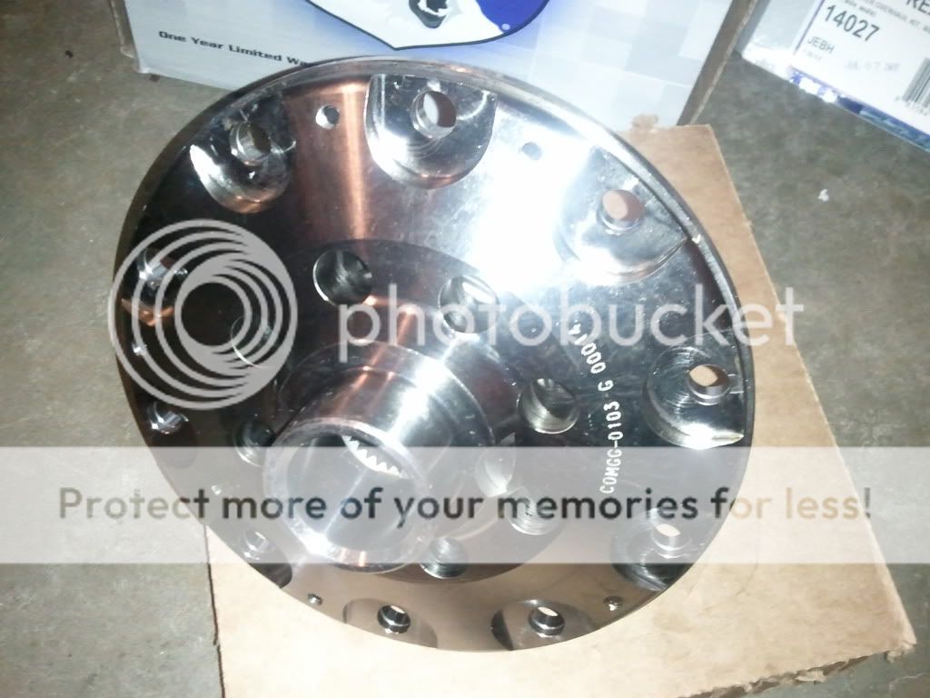

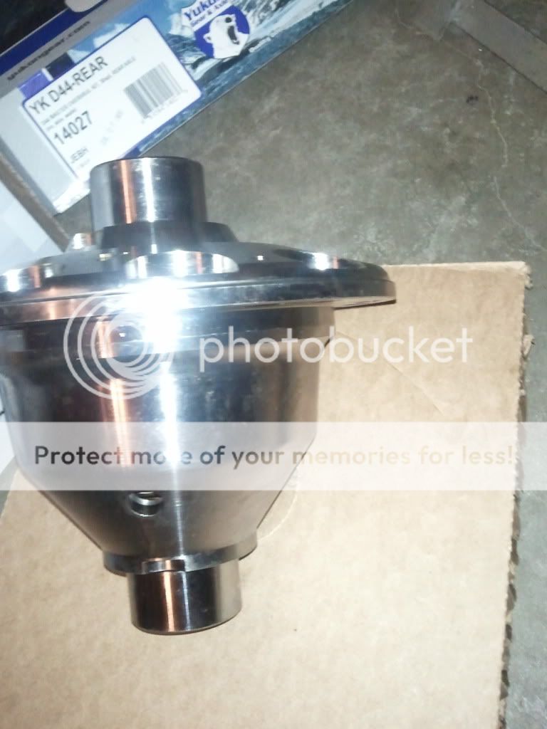

But got some bling in the mail .
Another FW 78/79 dana 44 swap
4.56 gears , Grizzly full locker , and install kit .
