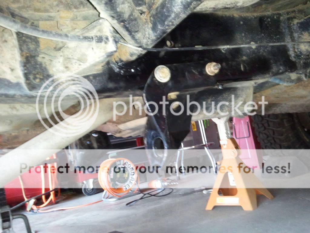

Went ahead and got started mounting the pivot brackets so I would know how long to make the arms . The arms will be 6" longer than stock . 38.25" from pivot bracket to center of the axle .

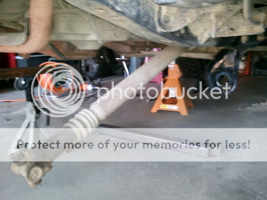

This pic shows the stock arm in the stock location .

Had to cut about a 1.375" off the brackets to clear the stock transfer skid .

Aren't they supposed to be on the opposite side are you pushing the axle forward some?
