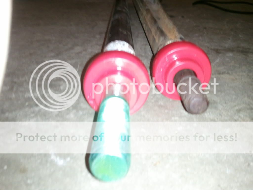

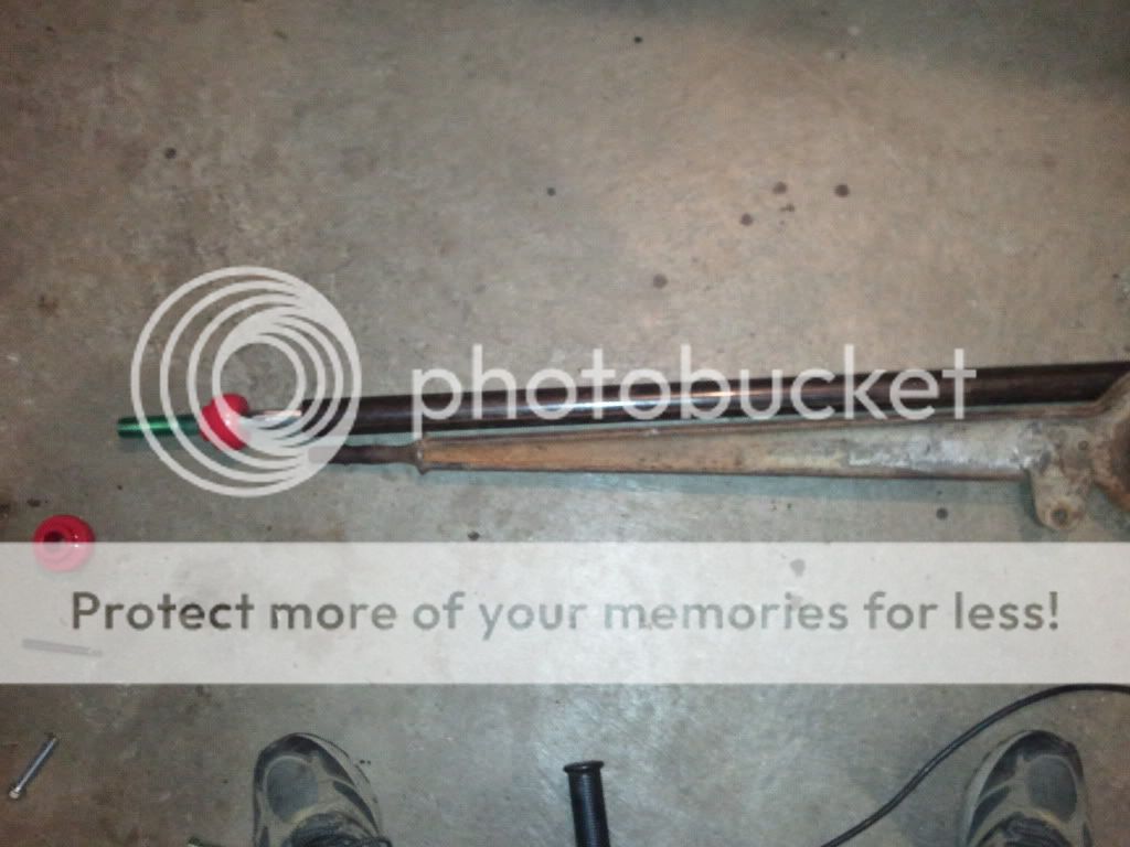

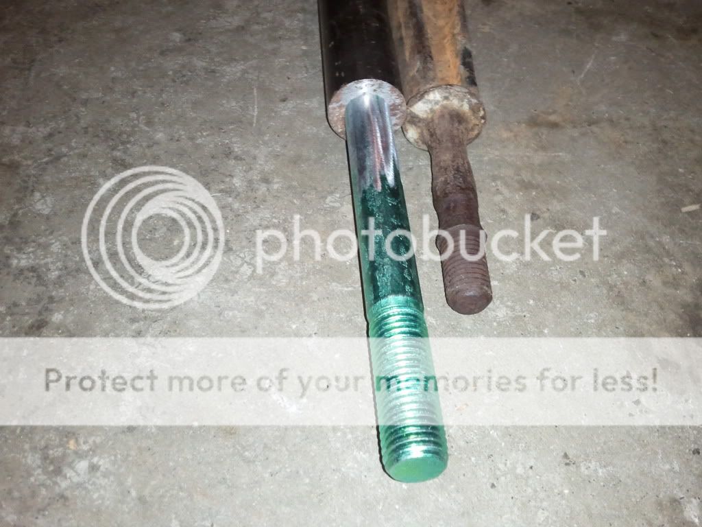

Thanks but I'm going to try the bushings . I got the tube but it is 1.5 with a 5/16 wall so 7/8 bolt slides in real tight . The hole in the bushings is 7/8 so that's all good .
Trying to figure out how to do the arms and make them stout enough . thought about putting the tube on top of the arm and plating the sides with 3/16 that would make the arms 1 7/8 wide .

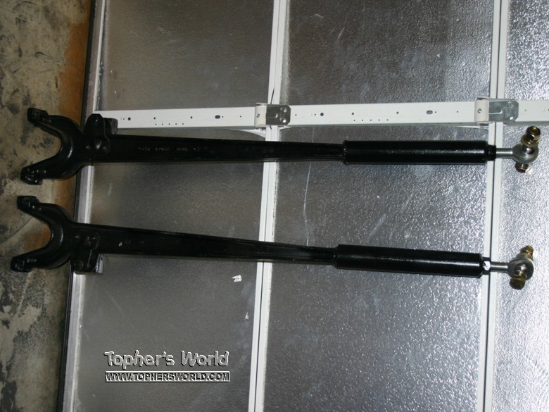

I like these
Another FW 78/79 dana 44 swap
But I still say extensions and brace them
Thanks Dustin , I really like the top set .

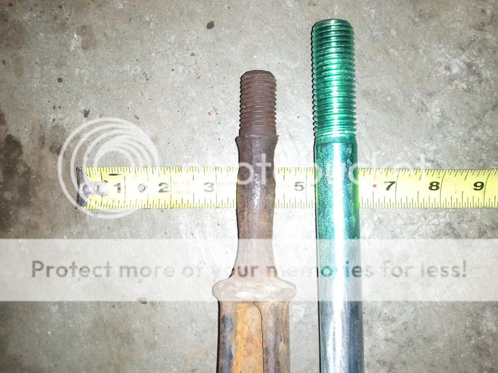

Here are some pics of what I'm talking about .
Could use a tube on the bottom and top then plate both sides .
And the bolt would need to go in more .
The stock threads on the radius arm are 3/4 .
