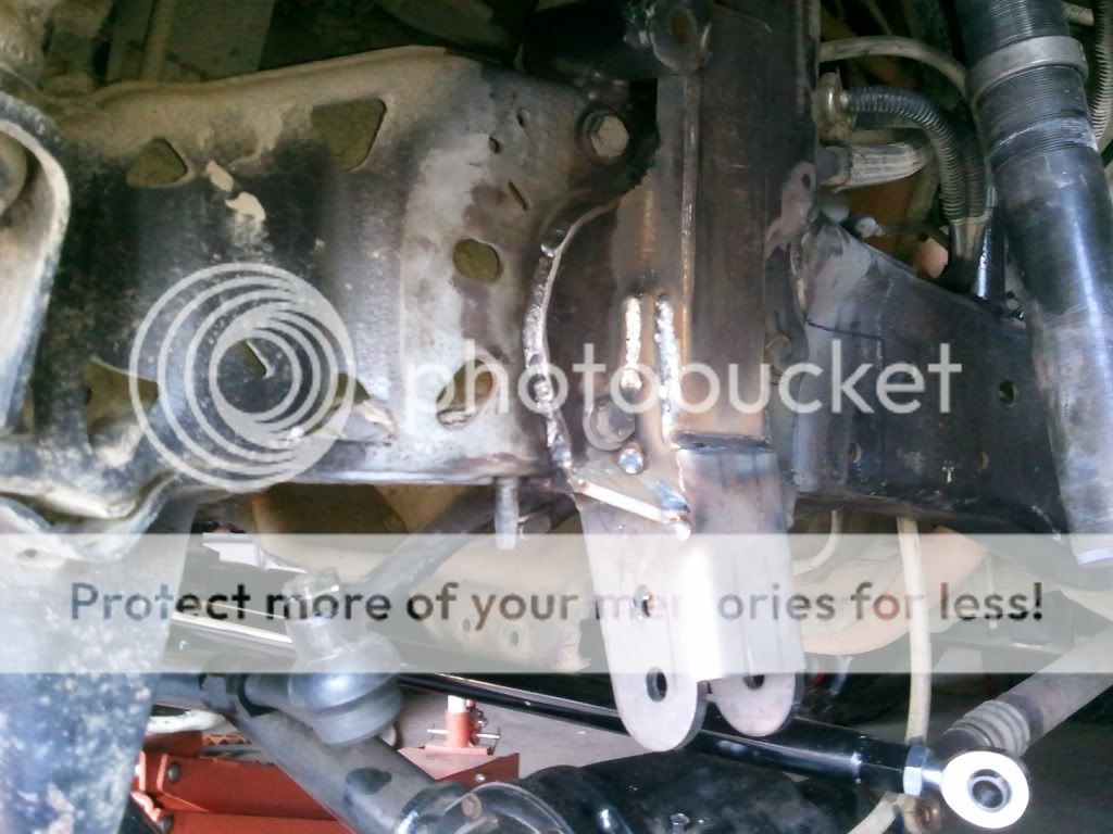

Yes I am wanting to go in front of the diff.And need it to be that low also.
That bolt is in there, I tried everything but drilling it out. Thinking about drilling a 1/2 hole in the stuck bolt then running a long 1/2 bolt through everything. Kind of like this but with a smaller bolt to fit the heim joint I have and using the bracket I have modified to go in the front.
drill and tap the bolt, then put a stud in it, then use some big washers and nut to pull it out like you would a power steering pulley...

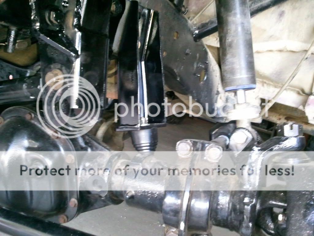

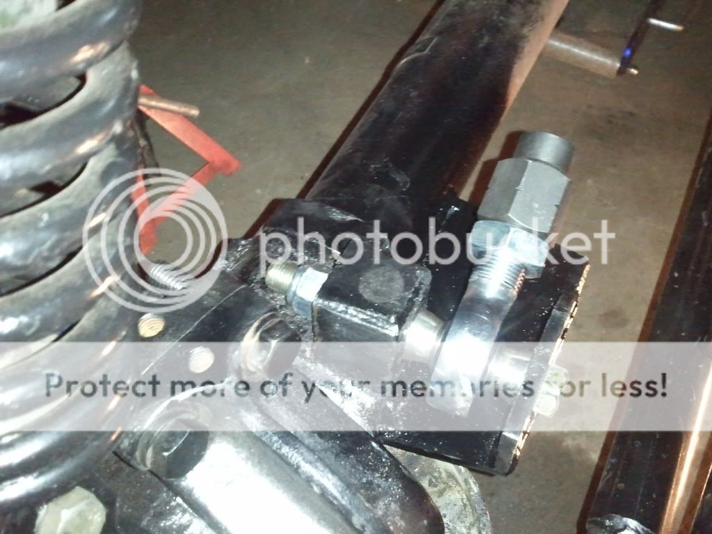

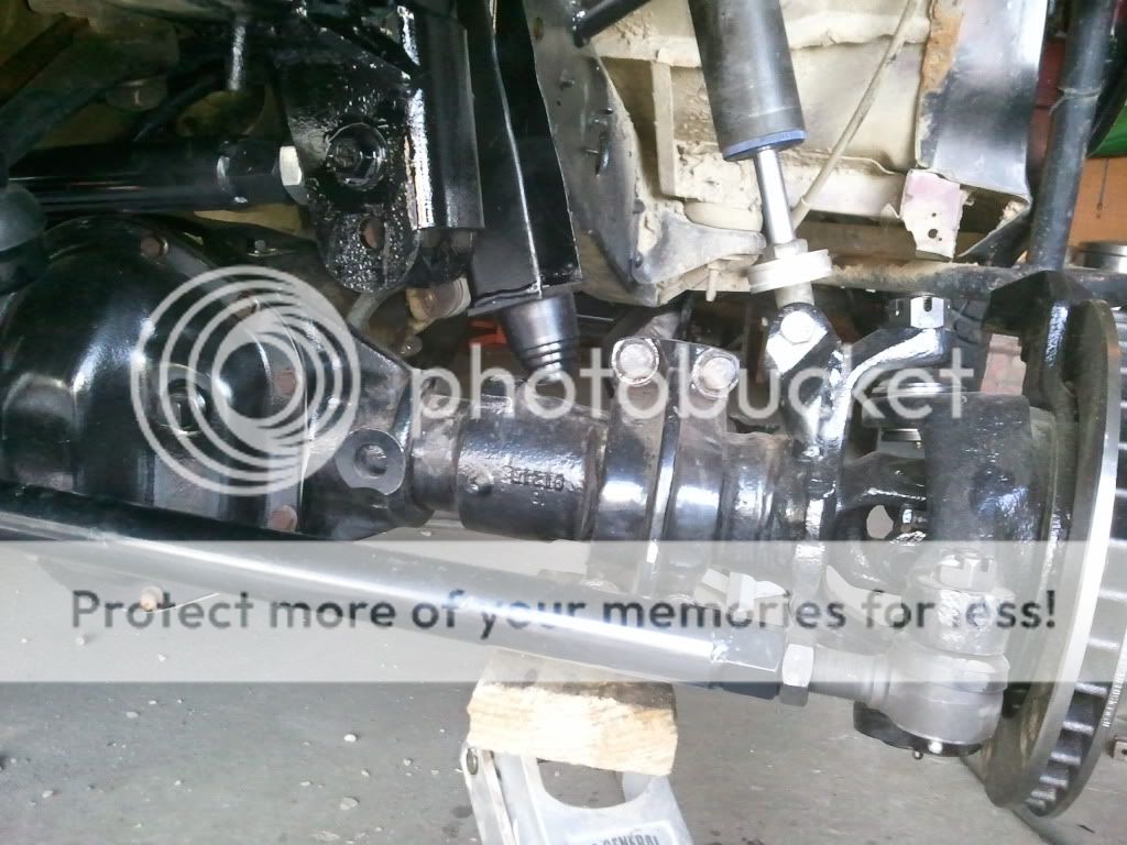

Took hours but got the 3/4 bolt out. Put a 3/4 OD 9/16 ID sleeve in it and did this.
At ride height.

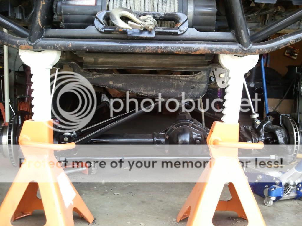

Drooped.

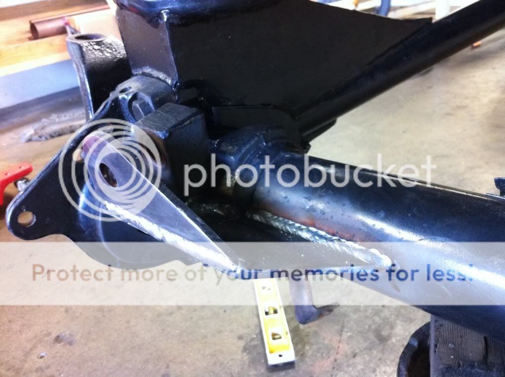

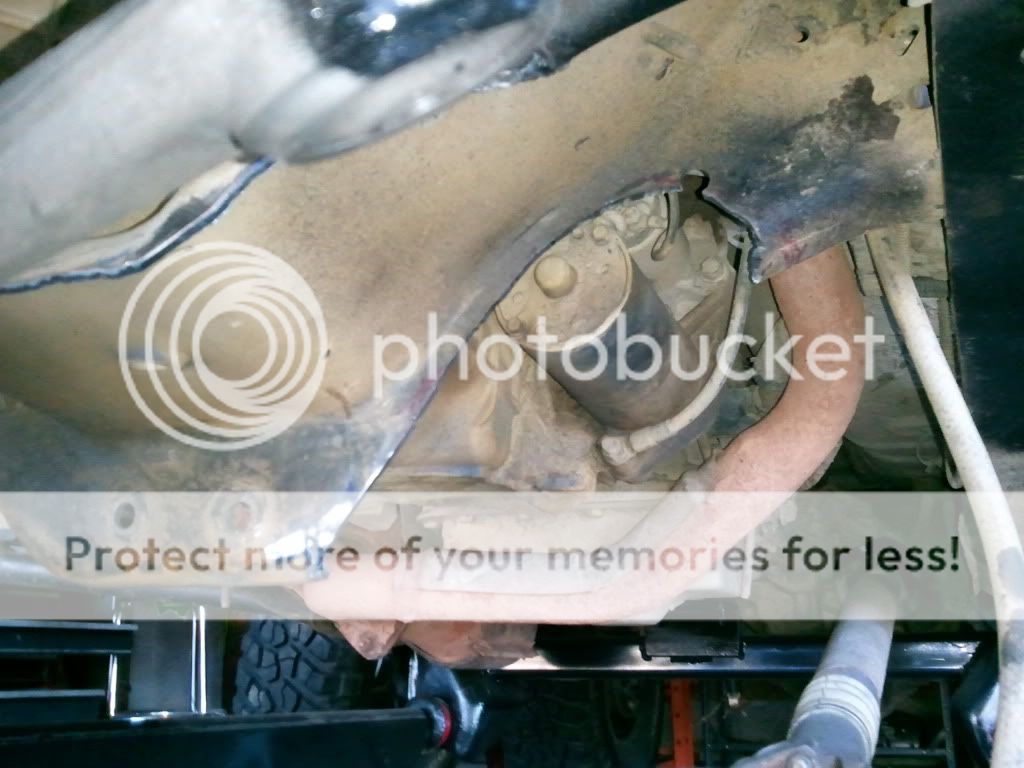

Track bar frame mount.

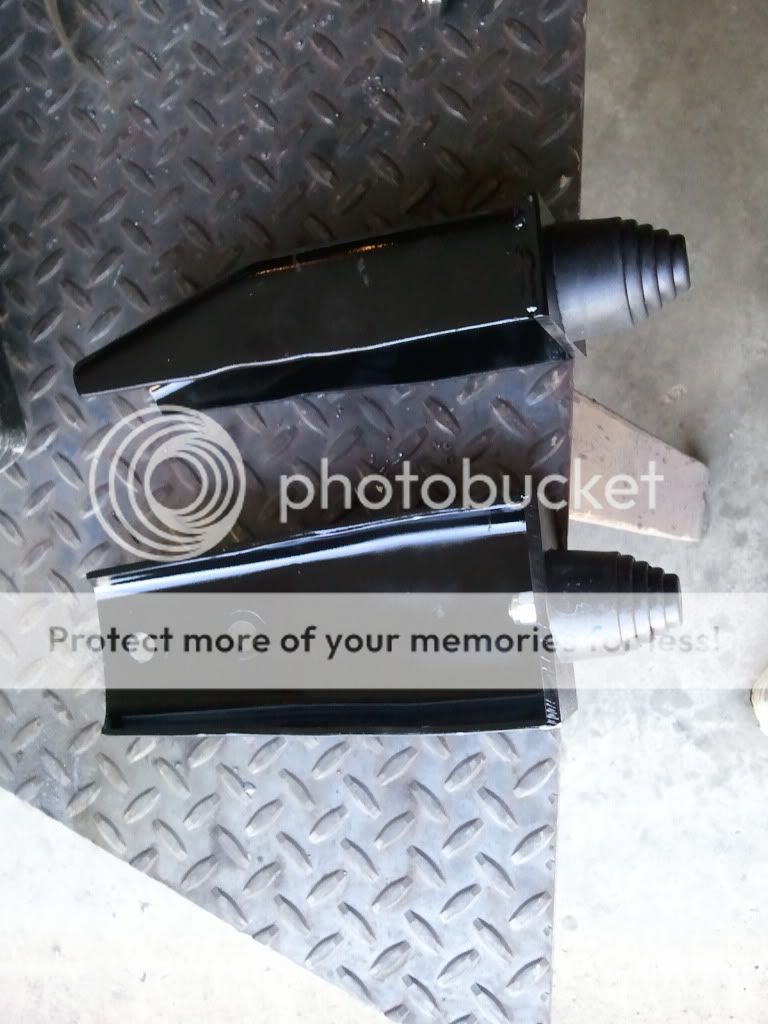

The rest of the f250 shock towers made into bump stops.
Flexed up on drivers side and down on passenger side.

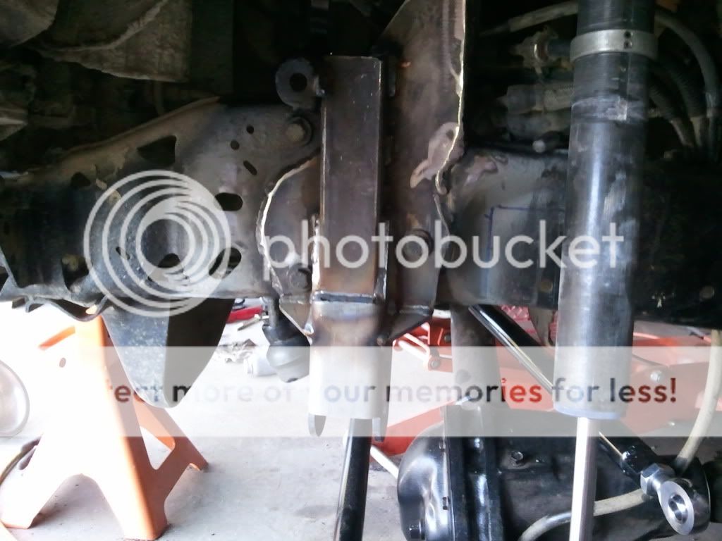

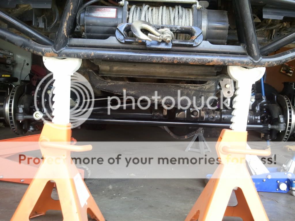

At ride height.

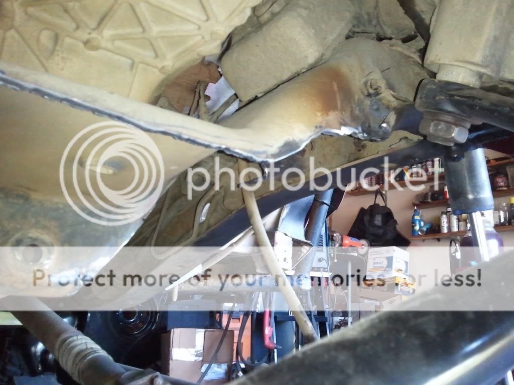

Engine crossmember.
You're missing something in that last pic lol.
