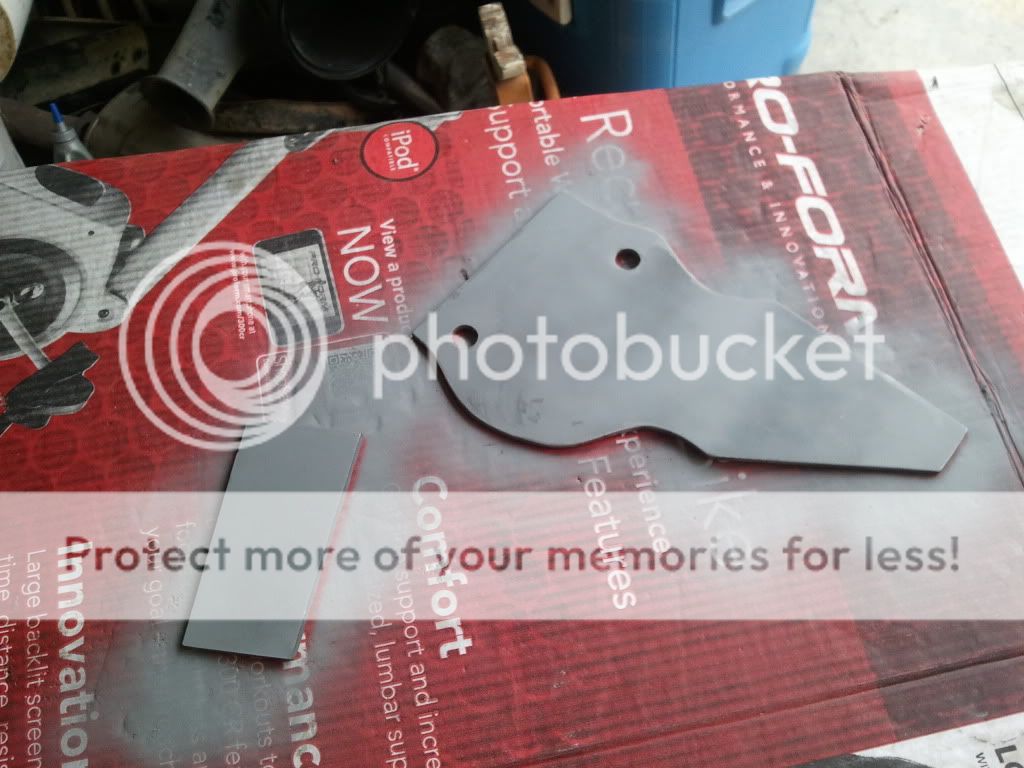

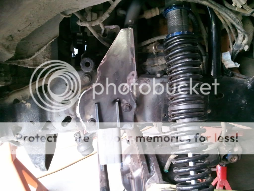

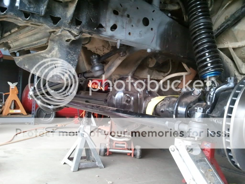

Got the drag link on. And cut the plates for the frame where the track bar mount will be.
Lookin good. One more week!

I will try to get it in tomorrow. Got a good start on the frame side.
If you have any tips, pics, or web links for the axle side of the track bar please post them up. Don't know if my bracket that mounts on top of the axle will work.
I think I can use the stock 44 track bolt hole. But how do you get the bolt out? Mine was kind of messed up so I cut it off. does the rest of it need to be turned out or knocked out?
I'm not sure about the factory bolt. I cut mine off. My axle side trac bar mount is as easy at is gets. Literally two triangular shaped plates that make the two sides, then completely boxed it in so dirt/mud/crap won't sit in it.
What about your prefab bracket makes it so it won't work?
