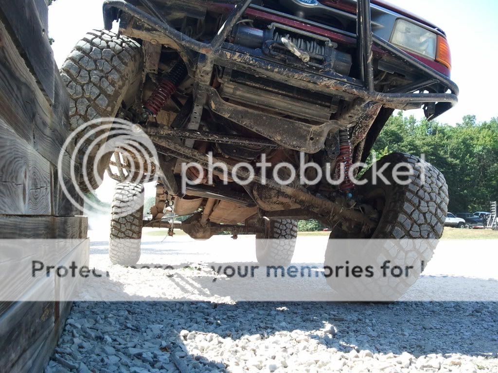

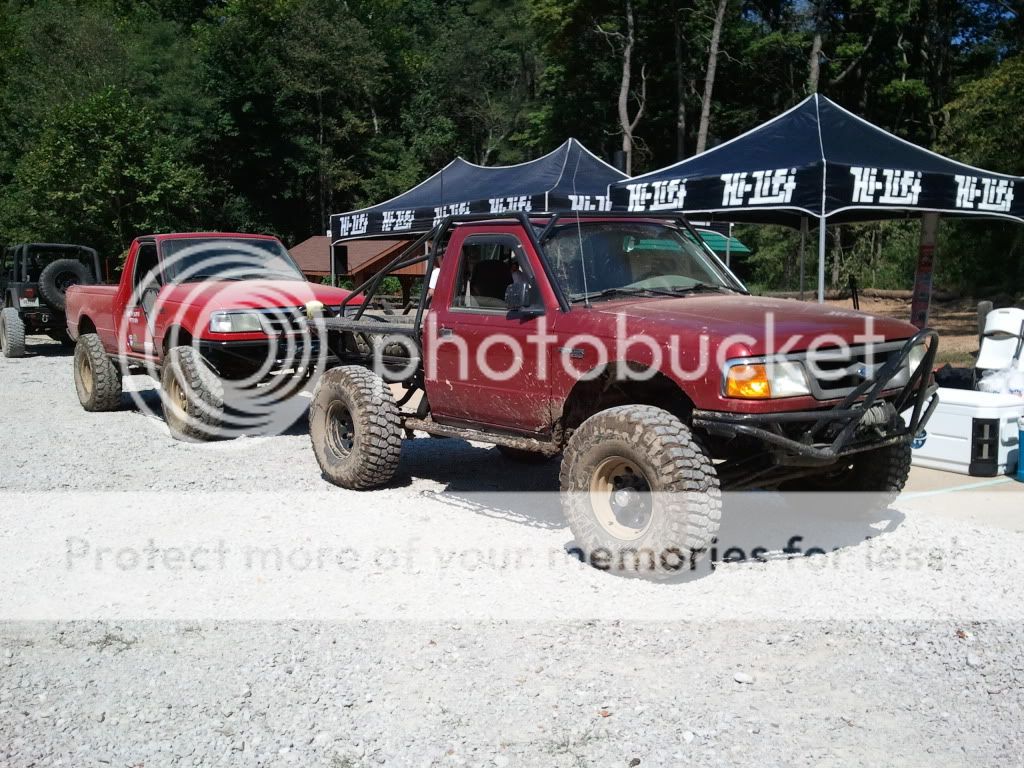

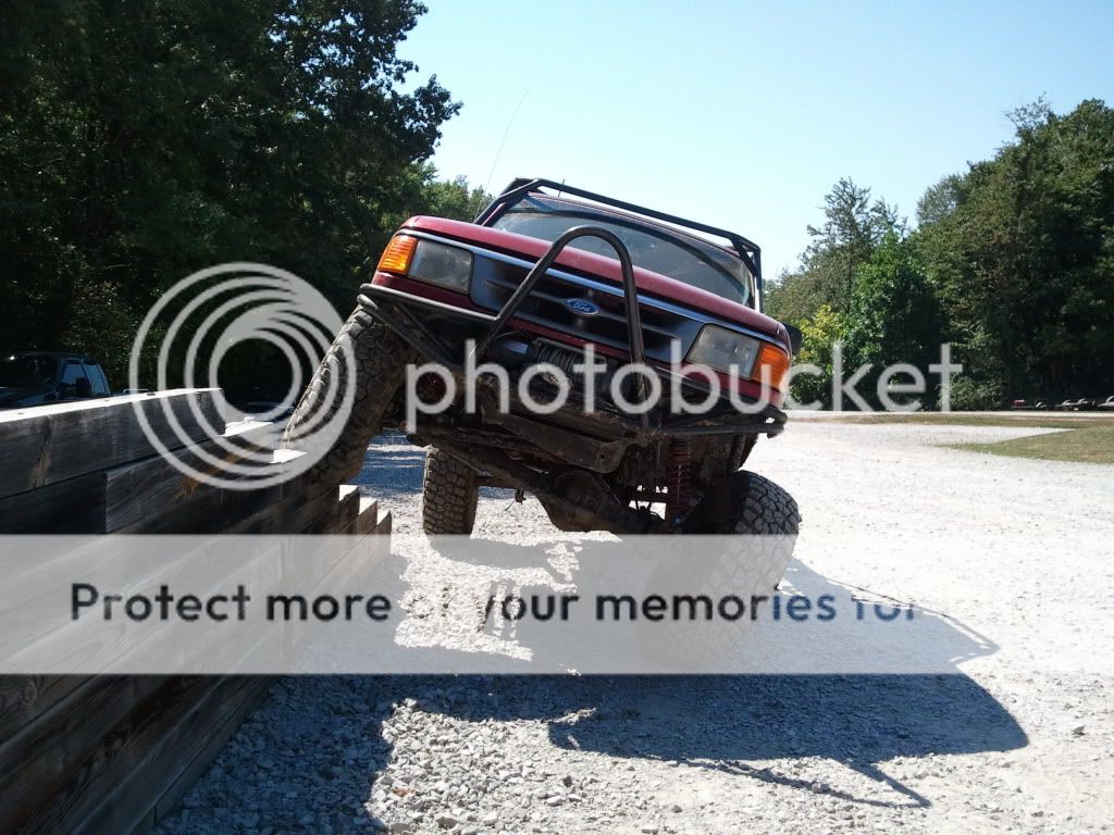

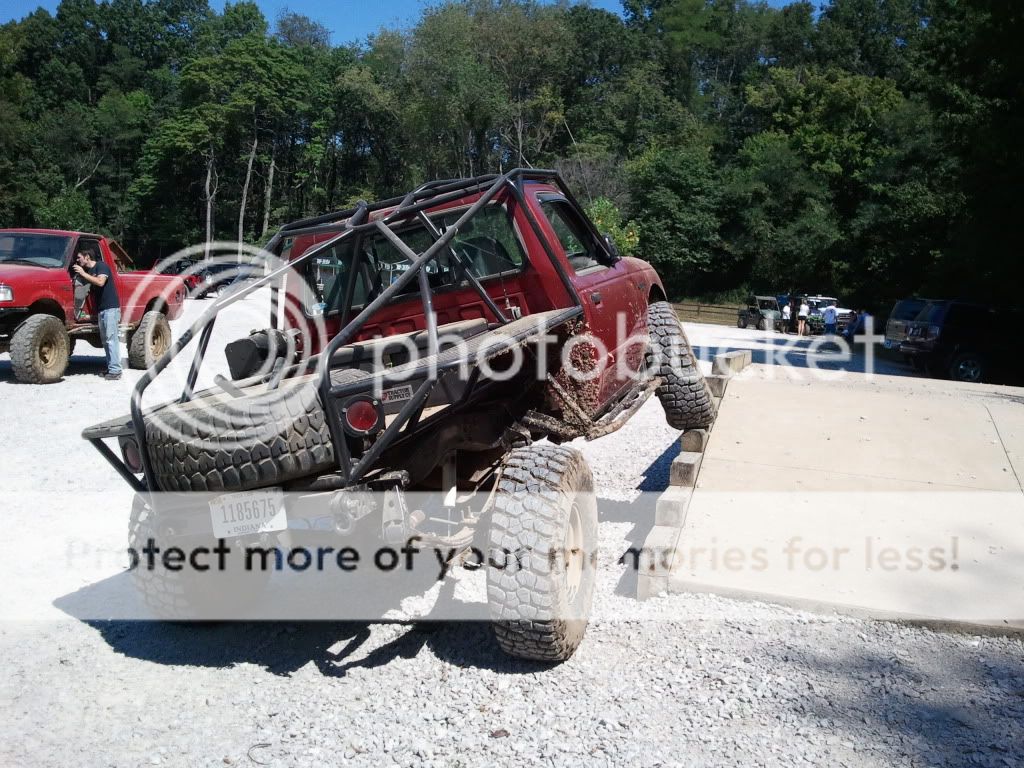

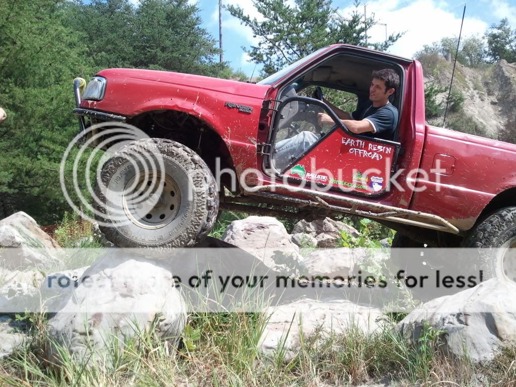

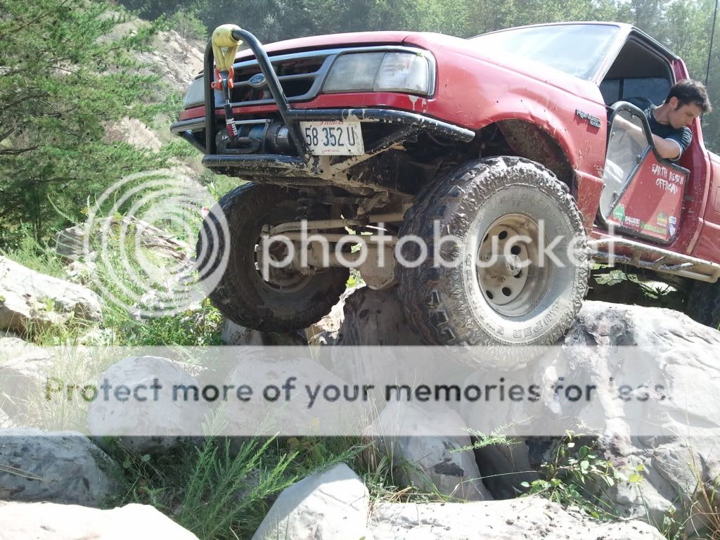

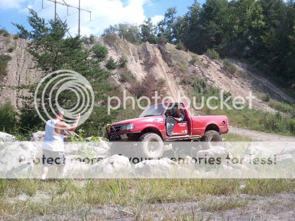

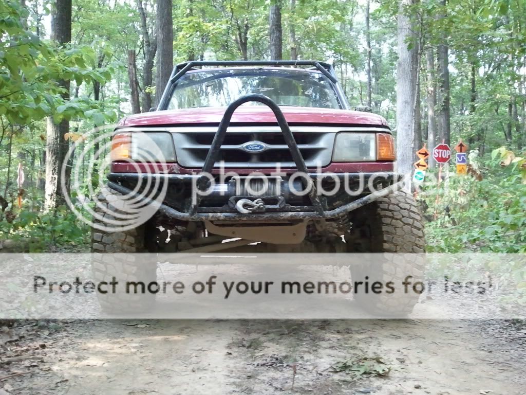

Here's a few pics.
I didn't want to push my luck at the rock garden but Bray gave it a shot.
Mark broke a front axle shaft trying to climb that hill behind the rock garden. And I think everybody got some body damage today.That last trail we ran (trail 1 I think)was really interesting.
