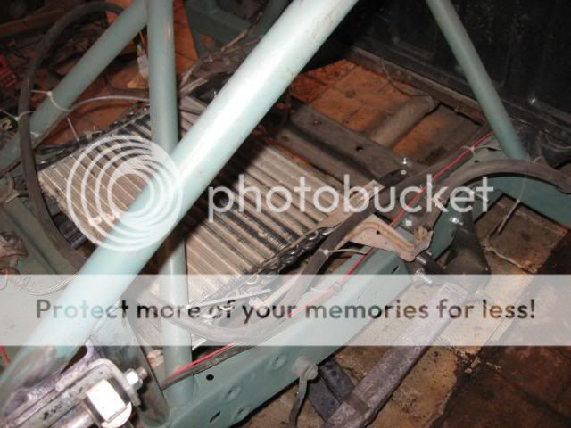

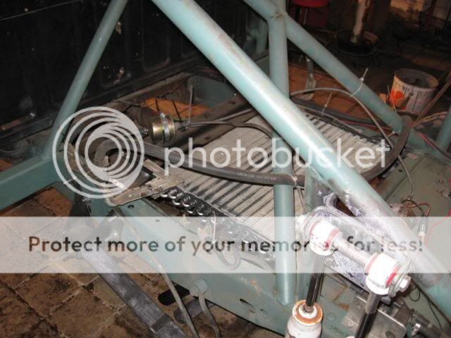

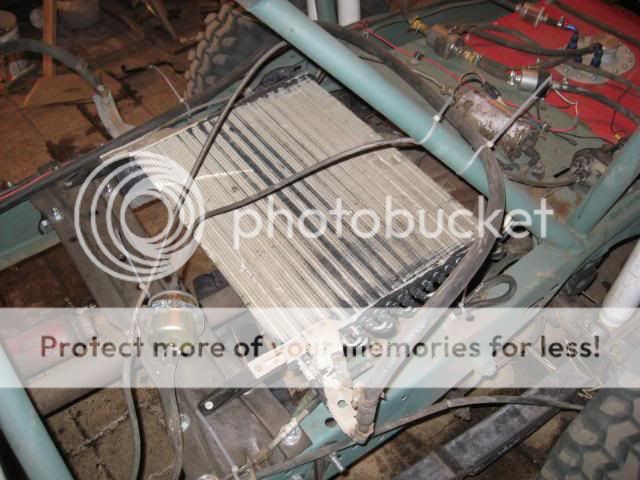

I ran heater hose to the back and connected an air conditioning rad [from the scrap aluminum pile] in line. Seems to work great. Some pics;

We'll see how long the rad lasts, I want to support it better underneath along the edges. The tube that comes off is fairly small diameter but has a 'flare' about 3/4" back from the end of the tube that brings it out so a 5/8" heater hose slides on with just a little [very little] force. I clamped the hose just below the flare and it would leak if I wiggled the hose or pushed it down. So I put another clamp directly above the first, putting the 'flare' in between the two clamps and problem solved. The temp didn't get above 3/4 on the stock gauge. The last run of the day I did for videos, the motor started running crappy. I hope it's just low on fuel. I'll check it tomorrow for codes as well.
