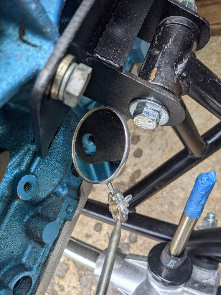

Blame COVID, the economy, global warming, whatever: I've built cars my entire life, been around pipe welders, fabricators, TIG welding artists. I managed a fab shop for a number of years. That being said, this kit has the worst welds and fabricating I've ever seen. I've done more hole elongating, loosening, prying etc than anything I've ever purchased. The welds on the new mounts look fabulous- but the holes are anywhere from good to waaaay off:
AJE Ranger K-Member Who's Done It!?AJE Ranger K-Member Who's Done It!?AJE Ranger K-Member Who's Done It!?
@Yotaismygame has already described (and I was told as well) loosening everything up to make it fit, then tighten it. I'm sure AJE would blame Ford inconsistency, but I'm not buying it. AJE needs machine operators and welders.

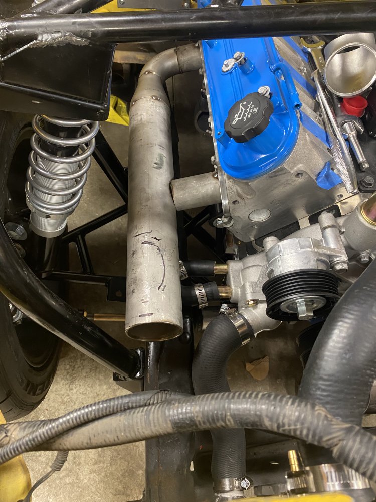

I built my turbo manifold to come straight out off the head and you can see it’s just above the heater hose connections.
I wanted to buy a manifold but couldn't find anything that would work at all unless I was to add a bunch of pipe and move the turbo pretty far from the manifold. You might need to shorten your steering column to make life easier on the driver side. Luckily for me adding electric power steering made it possible for my column to come out of the firewall at a steep angle. Another thing, doing a rear mounted crossover is extremely tight on the passenger side which I why opted for a front crossover. And even then that was really tight around the turbo, radiator hoses, and tensioner.

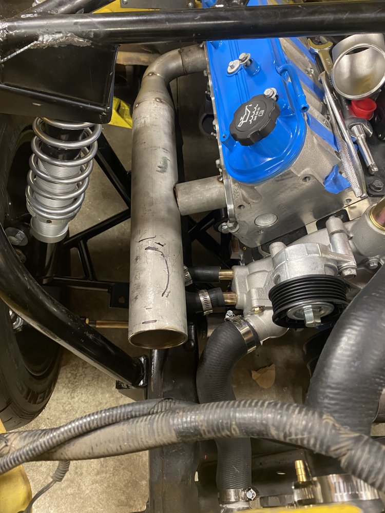

I used dimensions from the PDF from Holley- it will take clearancing of the frame rail, but it will work. Not easily, but it'll work (says the plasma cutter and extra material for x-bracing in the corner of my shop). Same for the crossover. This entire project has been a headache, so I'm used to it.
