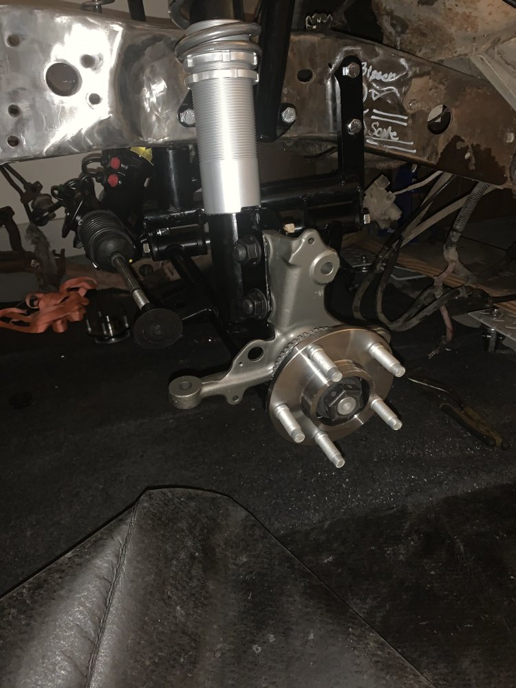

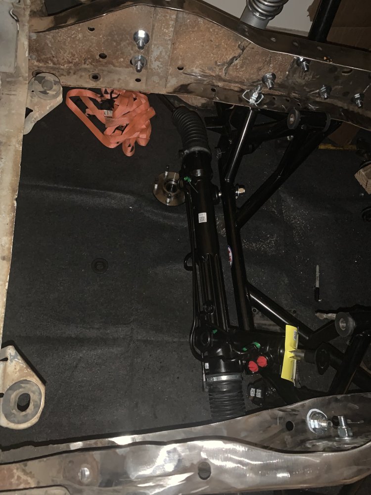

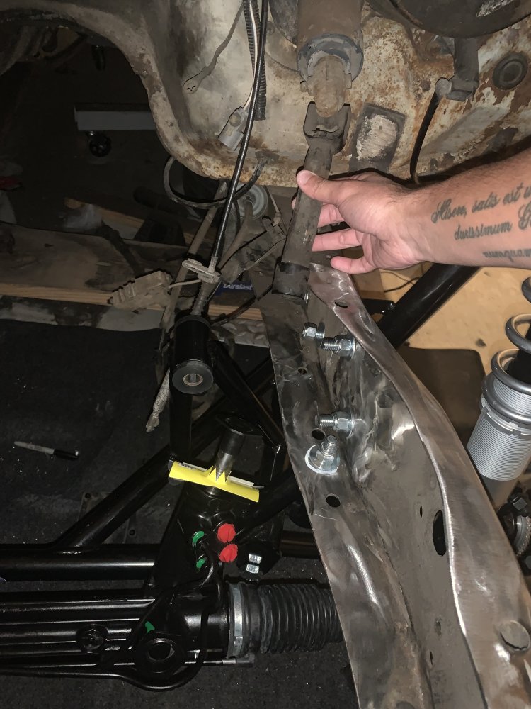

managed to bolt up the rack and hubs for a test fit. Should be able to run a steering linkage pretty easily.
