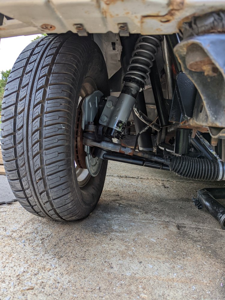

A little- I bought my awning (it's awesome working under it), got my shocks installed (went with QA1...another story), installed the warspeed alternator bracket and got exactly one (!) wiring circuit done before the heat told me I had to quit.

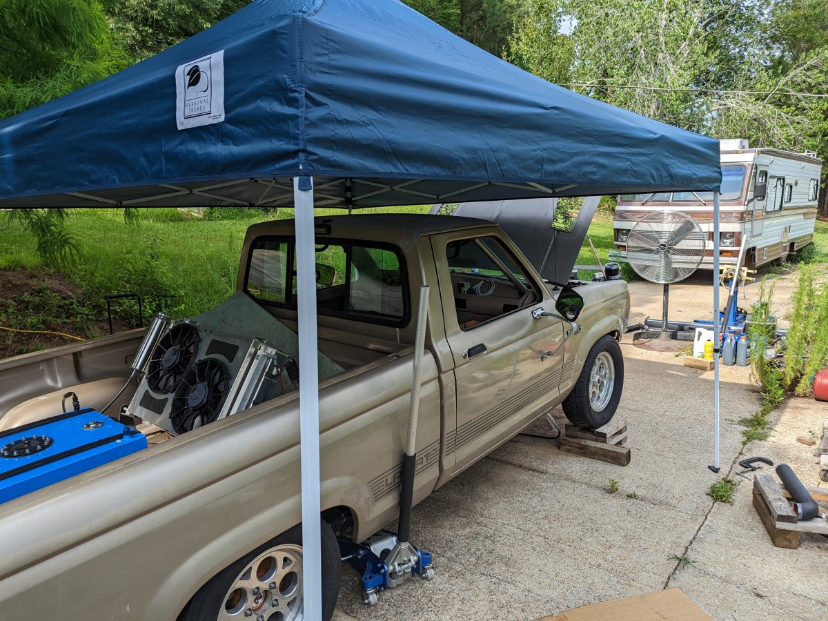

Gotta be 20* cooler under here

Rear of the truck is done (other than a competent welder finishing my tacks)

QA1 Pro, double adjustable. I can do pretty much anything with these- add a sway bar and go to Barber Motorsports or run it at the dragstrip.

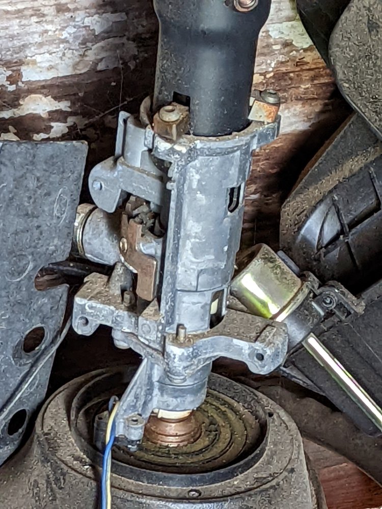

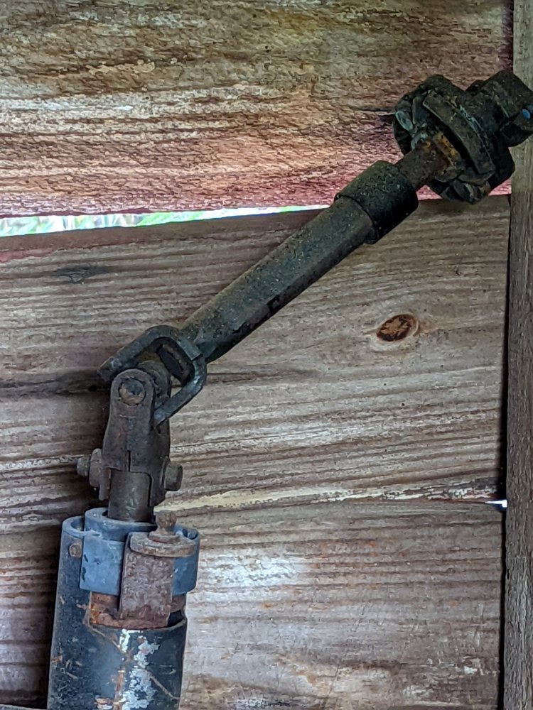

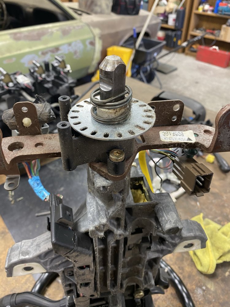

Any of you guys with a stock steering column could you post a pic of the interior connection to the steering shaft? Trying to remember how far down that connection is.
@Yotaismygame
Hopefully these are what you're referring to- let me know if you need more detail.

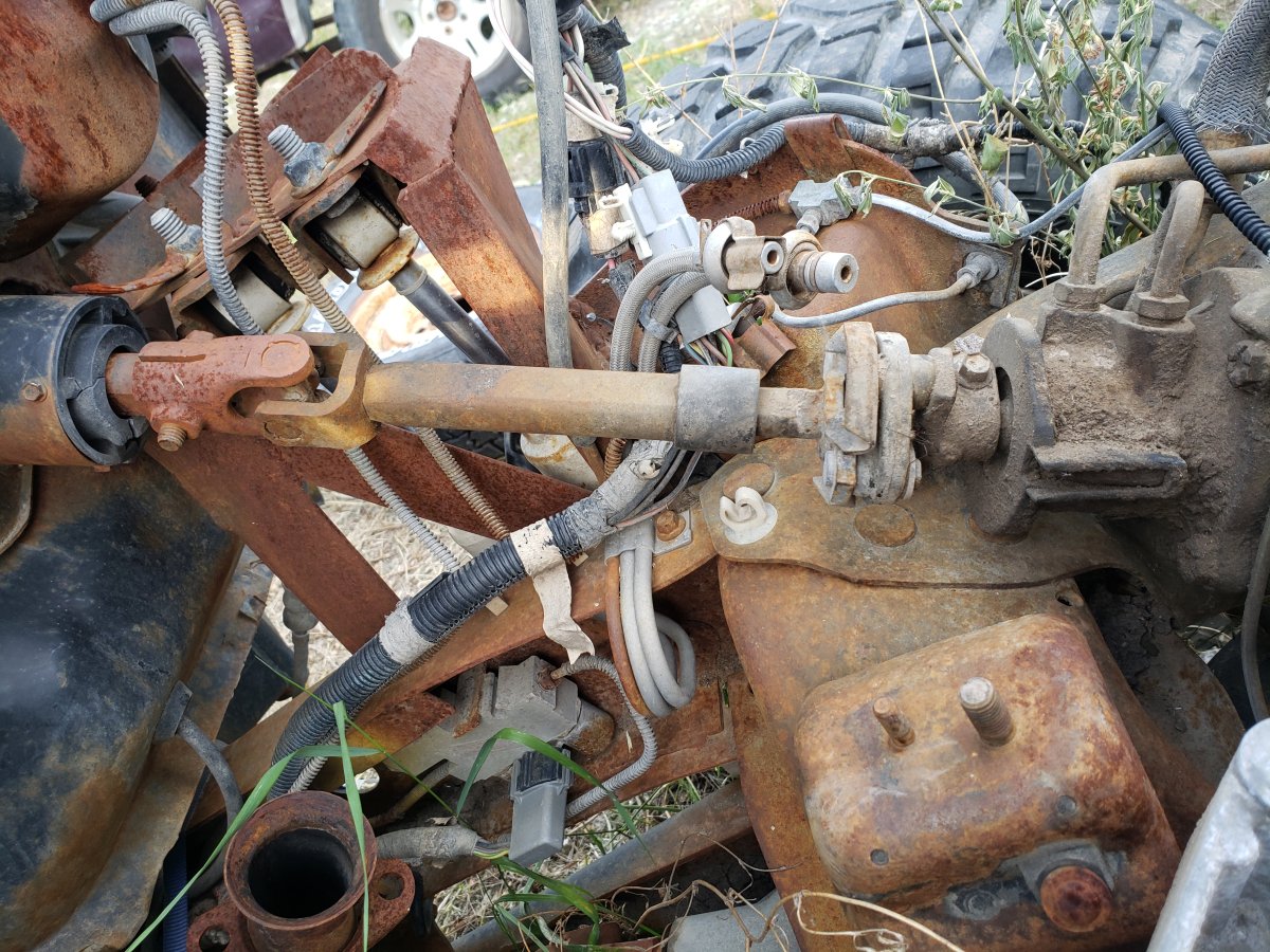

That sort of helps. I cant quite tell whats going on there. I need a pic of the column in the truck where it goes through the firewall.
@Yotaismygame
I have a race-only rack, but it uses the same mounting point as the stock column- would that help?

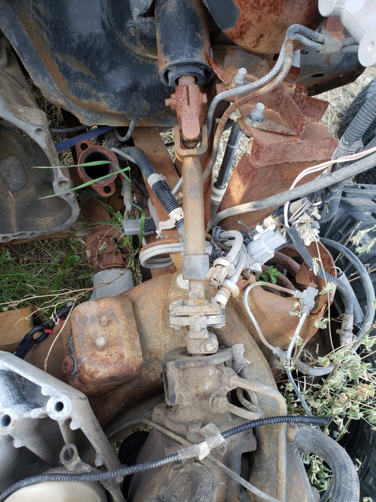

So this part here detaches from the column inside the cab?
AJE Ranger K-Member Who's Done It!?
So without the the stock steering shaft the column is strictly inside the cab? The way mine is setup now my column is inside the cab about 4inches or so from the firewall and the steering shaft enters the firewall at a pretty steep angle to clear my manifold. Trying to determine if I could use a stock column or if I need to use a race column to delete my modified stock column that has the electric motor on the end of it.
btw this truck handles pretty dang good. With the proper sway bars I think I could push it pretty hard in the turns
@Yotaismygame No- it is part of the column.
No- it extends through the firewall as pictured. It's where the black tube ends and the coupler begins.

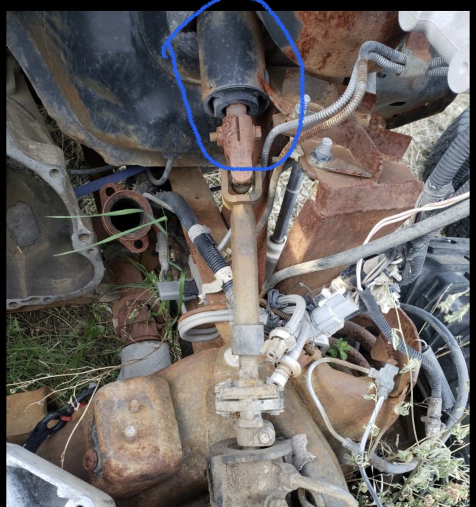

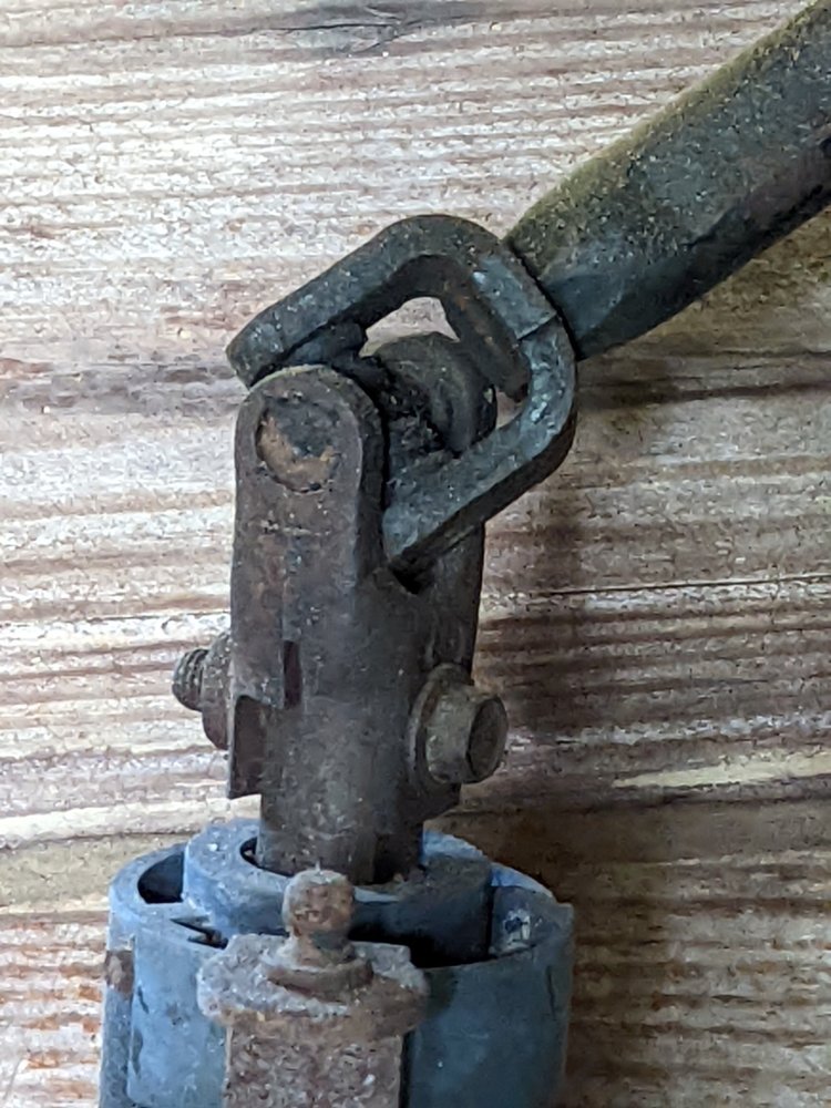

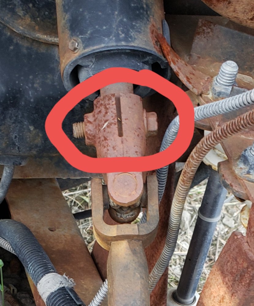

I'm still a little confused on the stock column. Mainly because of this pic. I just can’t remember what the setup looked like when I originally took it all apart.
That is the output side, the bolt in the above picture that is circled in red goes into the notch in the left side of your picture.
